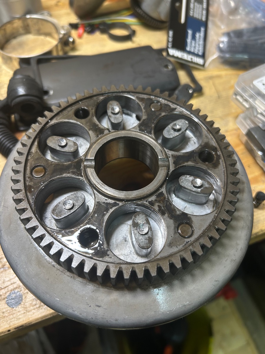

Driller off the head on the nails today, should I just keep the rest of the nail and then weld between the rest and the plate?
Use something to push the plate completly down before welding, their are 3 springs pushing against?
the red frition plate is broken, I don’t need a new one?

You drilled off more of the rivet than might be ideal. The rivets on my hub were flush after clamping everything down for the welder.
The red gasket thing isn't needed, from what I've read from others doing this repair.

Ah, okay. Did you grind the surface of the plate where you’re going to weld? Is it to ensure a better weld?
The welder ask if it’s normal black steel?

04 Jul 2025 11:25This is why I suggested "grind" not "drill" but if your welder is on his "A" game you should be OK

Did not read good enougf
I talked with welder and see he has alot to weld on, he is pro so hope he is correct

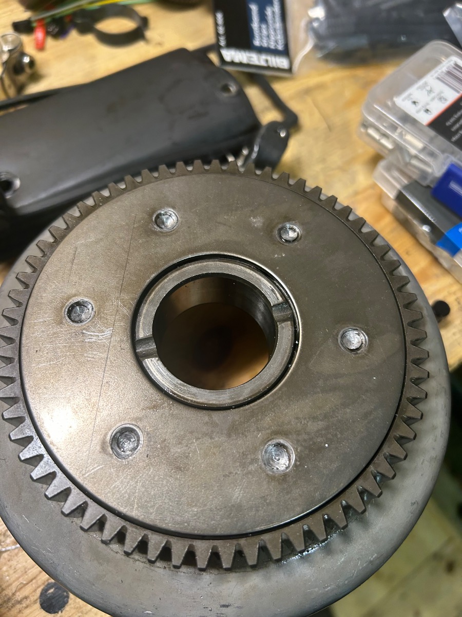

I got the starter clutch installed today, but have some questions.
1. How can I torque up the clutch hub nut without the special clutch tool? I have a power gun that torque up to 400nm… how import is the nm on these nut?
2. The old paper gasket on the oilpane and clutch cover, I need to get it away 100% to avoid oil leak with the new gasket? Razerblad is the best to use for removing?

You can try putting it in 1st gear and get someone to apply the rear brake while you torque the nut. Correct torque is important
A razor blade will work but be careful not to damage the surface

08 Jul 2025 22:14 - 08 Jul 2025 22:15I saw the same tips in the service guide made by a user on the forum, but when it's set in 1st gear, it will spin, since I don’t have any friction plate or springs installed… No clutch is installed, right?You can try putting it in 1st gear and get someone to apply the rear brake while you torque the nut. Correct torque is important
I feel that is something stupid I don`t understand here
