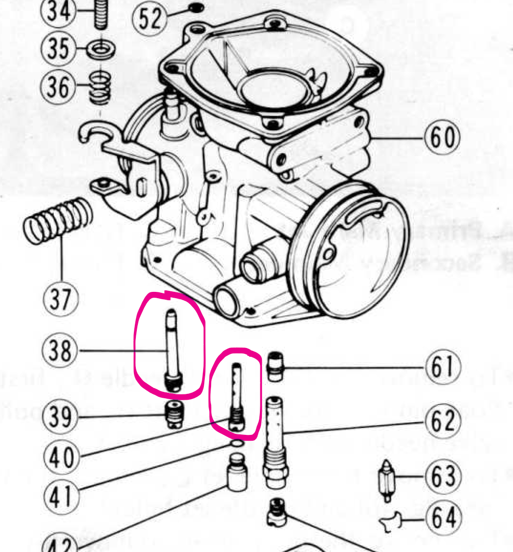

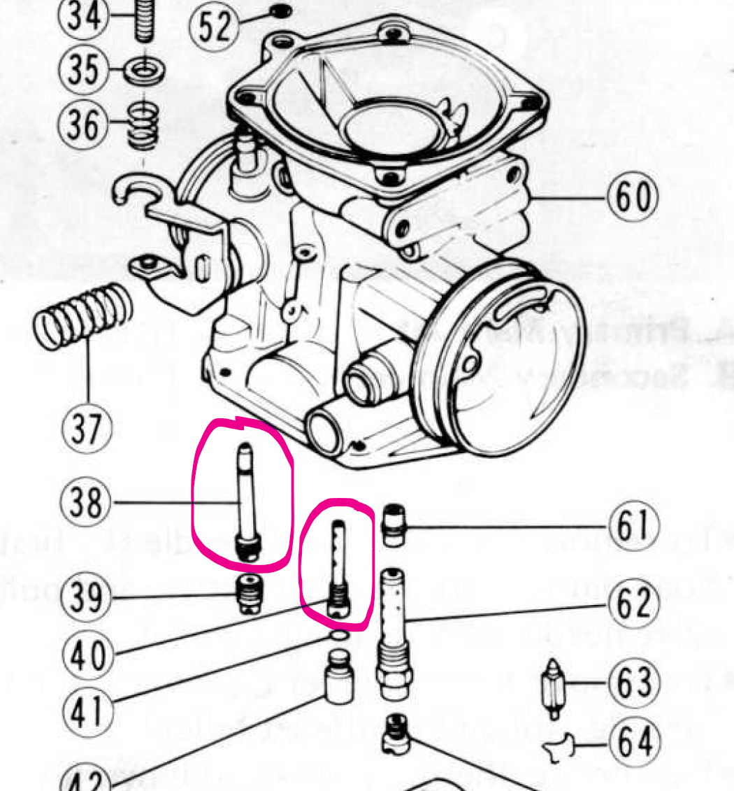

- Posts: 8205
- Thanks: 3577
Re: Help with First Restart After Carb Rebuild
24 Apr 2025 18:58
Both of the highlighted part have incredibly small orifices, which are highly likely to clog.
You must hold them up to a light, and make sure that you can see light through. This is NOT an option. I can't stress this enough.
To clear a blockage, I use a single strand of stiff wire pulled out of a midsized wire brush. Poke out the hole, make sure light passes.
