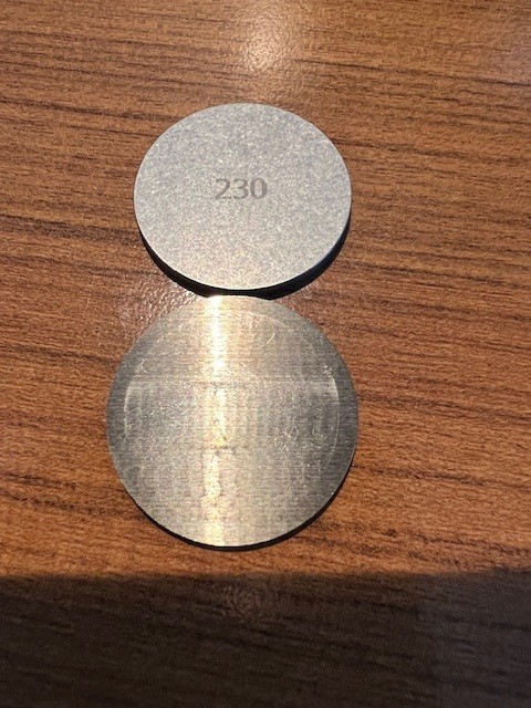

The clearance between the cam and the valves of my KZ900 are below spec on 2 valves at .0015'' / .038 mm. (Min. required .002'' / .05 mm)
I removed one of the two shims and discovered that it had been ground to 1.64 mm.
The mechanic who rebuilt it told me that he had done that on several bike without problems and that I could reduce it further to have the required clearance.
(which I doubt!!)
I would like to have your opinion on this way of doing things (not recommended by Kawa) I think I have no choice but to do valve stem grinding.
(which I doubt!!)
Not sure if I will take the head assembly to a machine shop or just the valves. The mechanic told me that evrey thing on that head is new.

Never grind shims and never let that "mechanic" near your bike again.

Just found an other issue ! Intake vave # 2 has .008'' gap. I tried to put a bigger shim but wont fit. RRrrrrr ! Look like installed shim (1.7 mm machined !) was also beveled. The OD is the same.

Over on The GS Resources, there was a guy that ran a free shim exchange program. He started this in part, because he had access to an industrial lapping machine. He would take fat shims and put them on a diet, making them usable again. To my knowledge, nobody had problems with any of the shims he lapped. I'm not advocating this practice, just sharing. Since shims are all of $7/each, I'd just rather get new. That said, K&L did spew out a goodly many bad shims into the marketplace. Something about them shattering. When looking through my bag for a certain size shim, I look for a used OEM shim, and only use K&L if the size isn't available otherwise.

Thanks for the info ! How lean can they be ? It seem ok as long they are not below 2.0 mm (by spec.)
The new shims I have are KY-29T. 2.3 to 3.1 mm.
