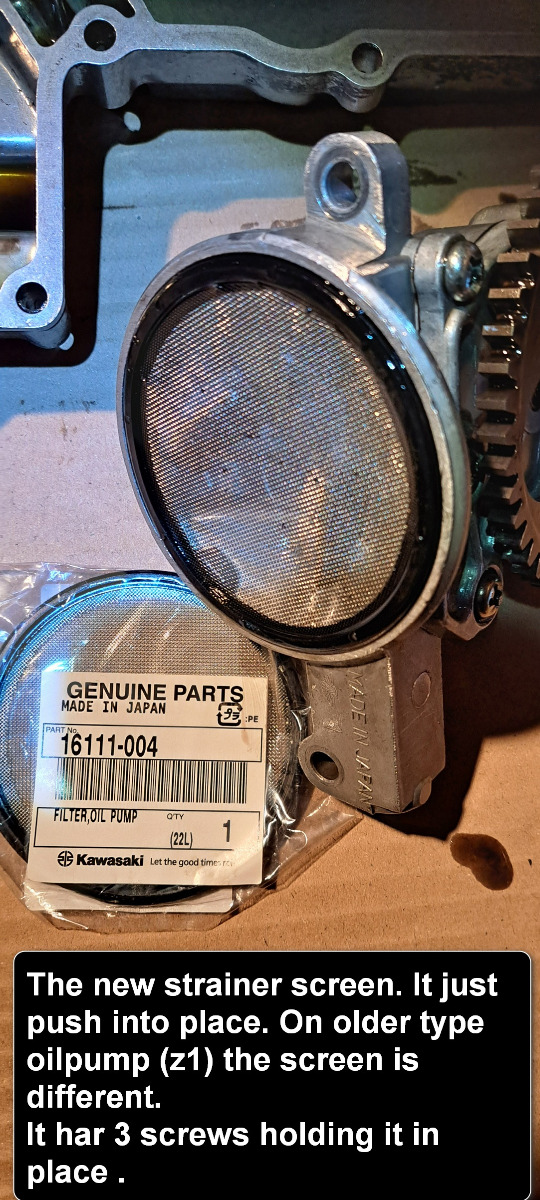

- Rolf1976_KZ900
- Posts: 498
- Thanks: 261
Re: KZ900 valve shims Machining
10 Jun 2025 00:29

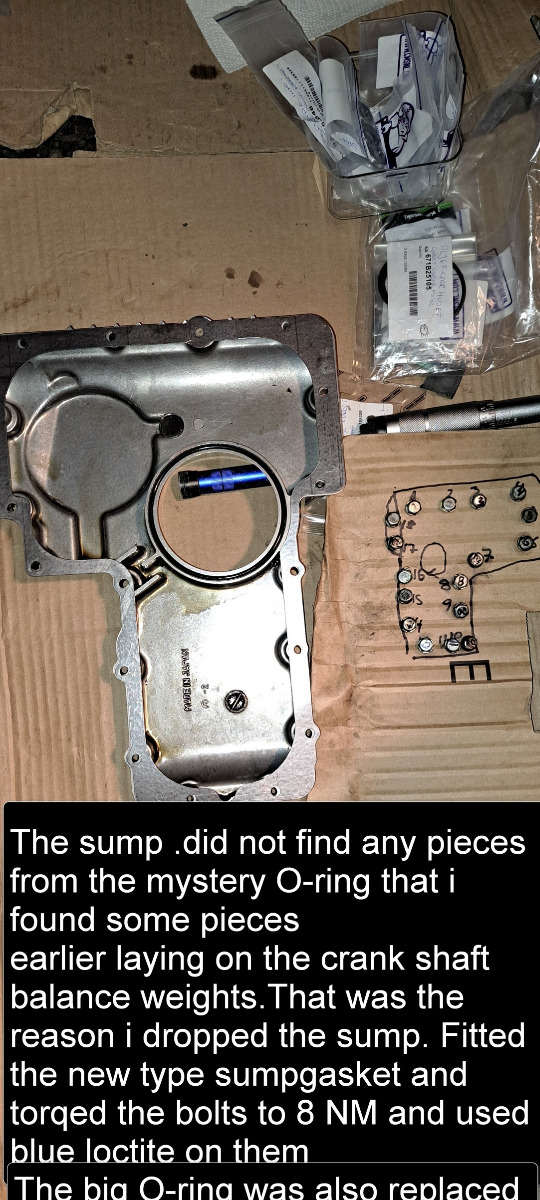

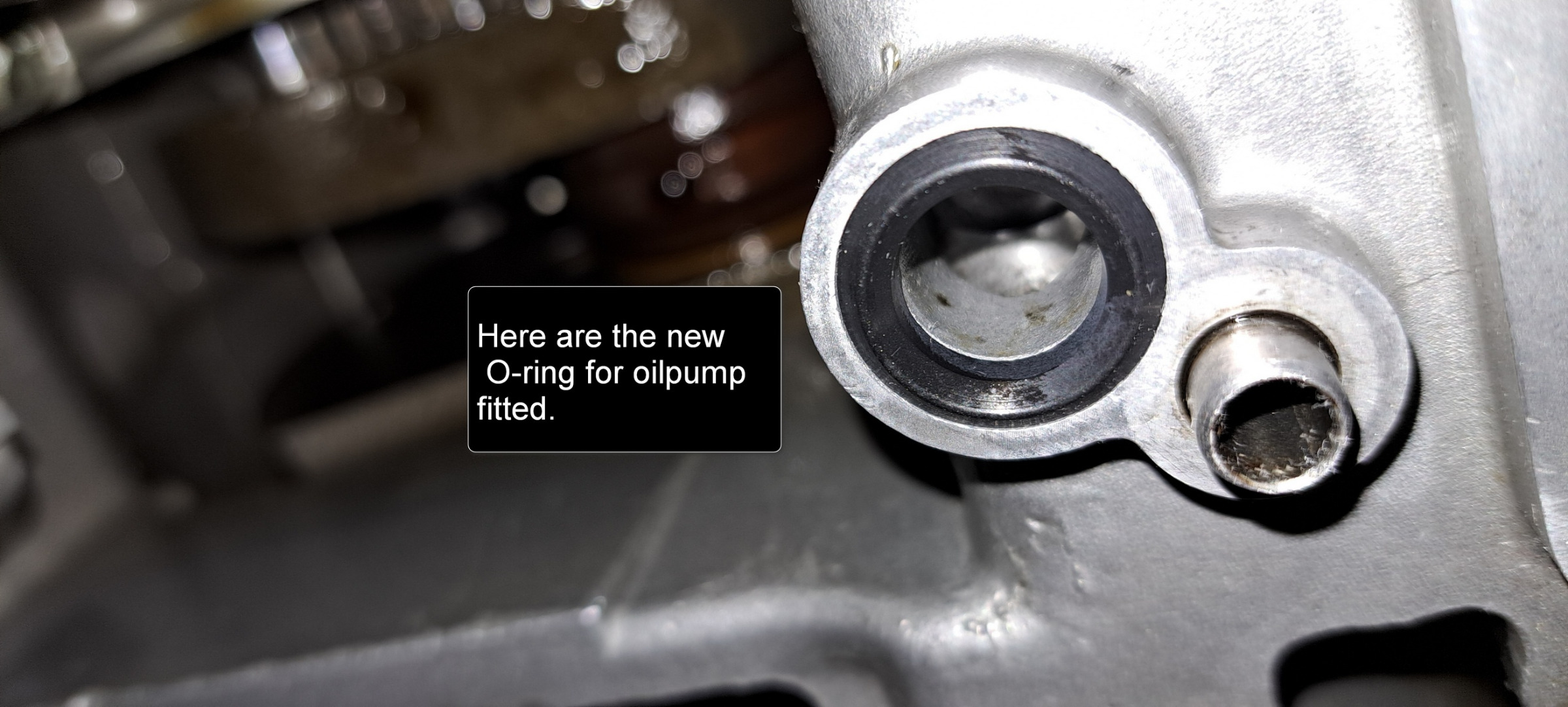

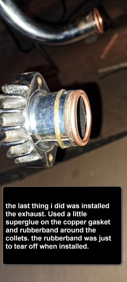

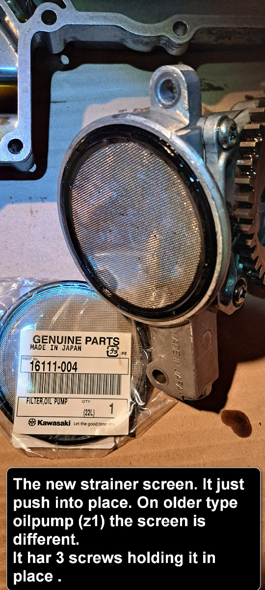

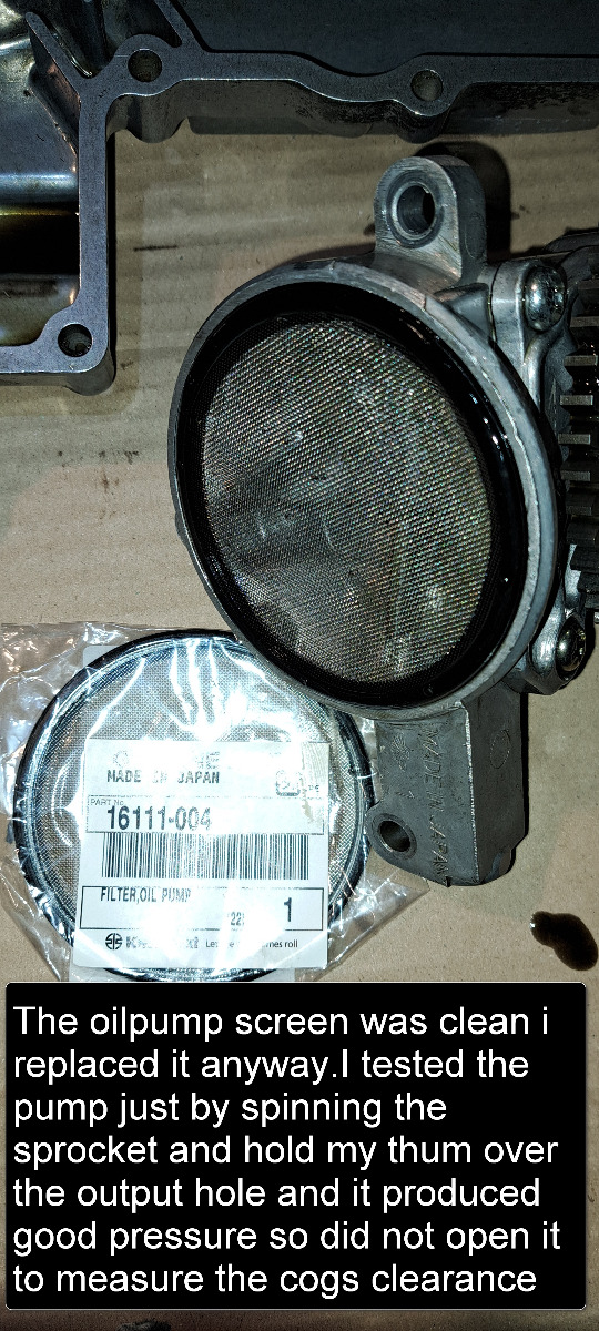

Yes buy a new o ring like Scotty recomend and while you have the pan off you can also check the oilpump screen and maybe take out the oilpump check it and replace the O-ring for the oilpump.To drop the sump you must take off the exhaust not much job, but take care so the mufflers dont fall to the ground scaratcing them.
I use a rubber strap to hold them up so they dont fall down.Also maybe you want to replace the exhaust gaskets i use a drop of superglue to hold them in place while
installing the headers also use small rubberband to hold the claps in place.The rubberbands you can just tear off after installed.
I used a little blue loctite and 8 or 9NM on the sumpbolts and a cardborad to se where they go since they have different lenghts.I post some pics from when i did my engine.Notise the nwe oem sump gasket is different it does not have a crossover part .
