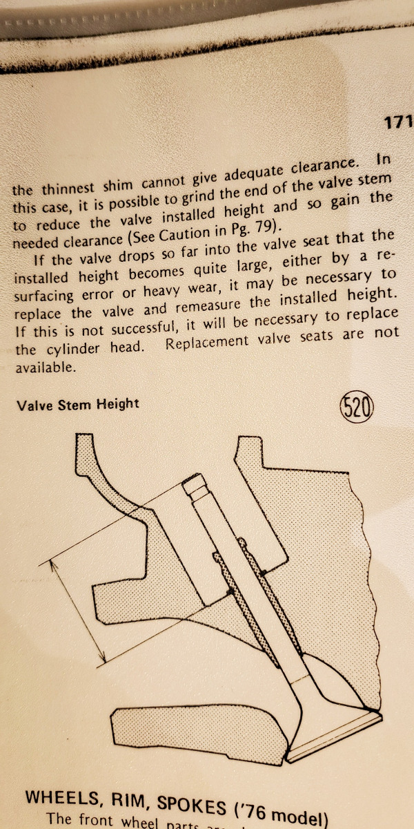

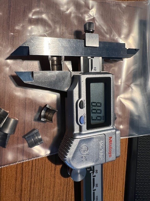

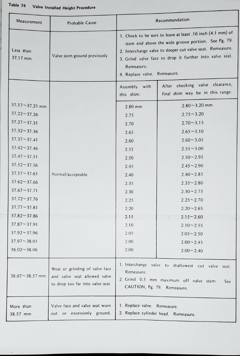

If you have 37.80 it look like you have space . look at picture 4 .I posted some more info from 1976 kz900 manua how to measure too

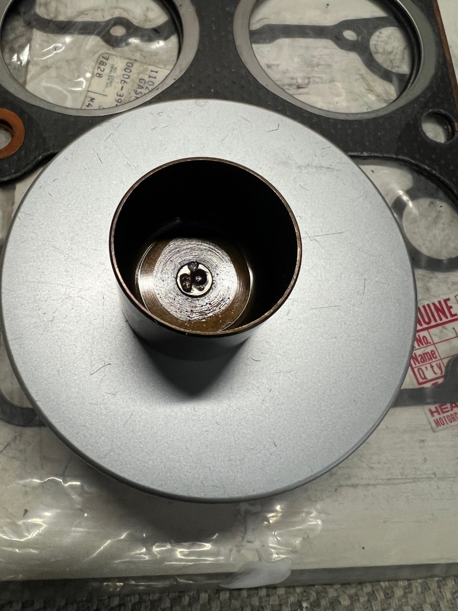

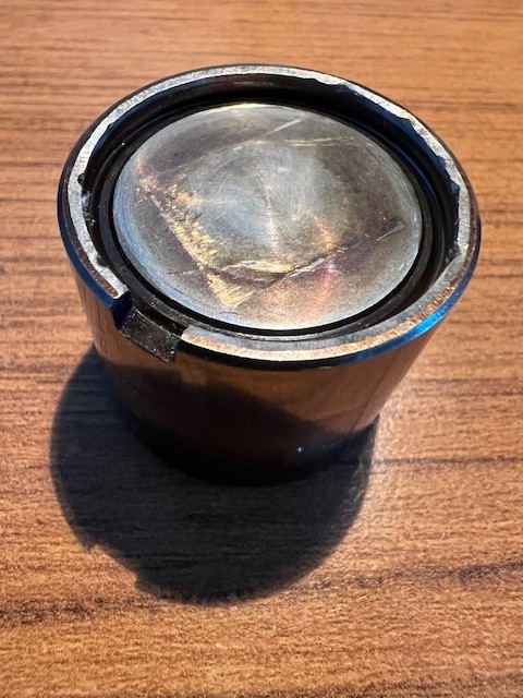

I also found a valve lifter with gouges on the inside. I have no clue of what could happen there !! The valve stem look ok.

It looks like the valve has been hitting off center and that there are welding boogers in there, too. I would consider using a different one.

27 Feb 2025 16:35It looks like the valve has been hitting off center and that there are welding boogers in there, too. I would consider using a different one.
Or maybe a keeper? And it look like TIG spot welding to replace the center.... RRRRrrrrrr!!
Anyway, a new lifter is on the way, but I'm disappointed with the salvage work that some shop of good reputation (...) in Montreal, Canada can do!
I called the mechanic who did this... No problem my friend, I have done this several times.

28 Feb 2025 00:09This is why I outsource as little as possible, you just don't know what you are going to get for the chunks of money it costs youIt looks like the valve has been hitting off center and that there are welding boogers in there, too. I would consider using a different one.

The head and valves are back from the machine shop, Sterms, springs retainers and keepers trimmed. Valves shims are 2.70 - 2.80 Ex and 2.55 - 260 mm. (2 of each from Zi Entreprises set) I'm happy with the results. Now waiting for new valve seals.
It look like the previous owner or his mechanic had issue with thin shim ! There is 2 bucket like this. What else can make this kind of marks ?

Running without a shim could leave those marks as well as damage the cam lobe.

22 Mar 2025 06:12+1 on that.Running without a shim could leave those marks as well as damage the cam lobe.
That bucket has been run without a shim.
Most likely a ground shim shattered and was spat out.
I would advise replacing any buckets with that damage.
The indent /trough on the bucket caused by the cam will leave a void under the replacment shim which could also cause that one to fracture as well.
