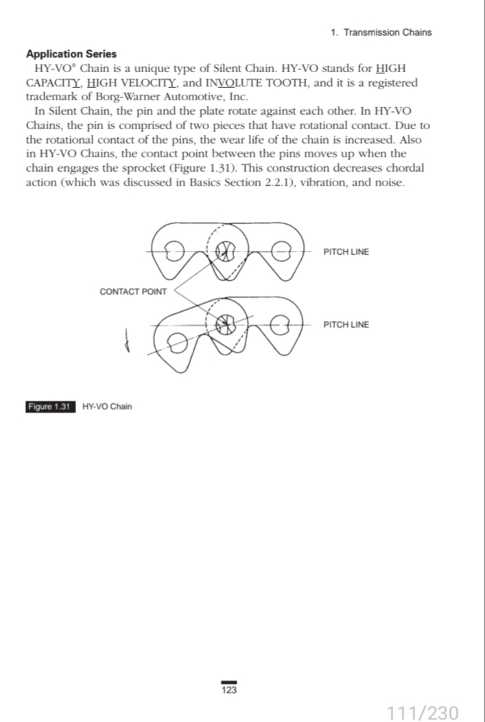

Am I right in thinking the switch to a Hy-Vo cam chain is also stronger and quieter ?

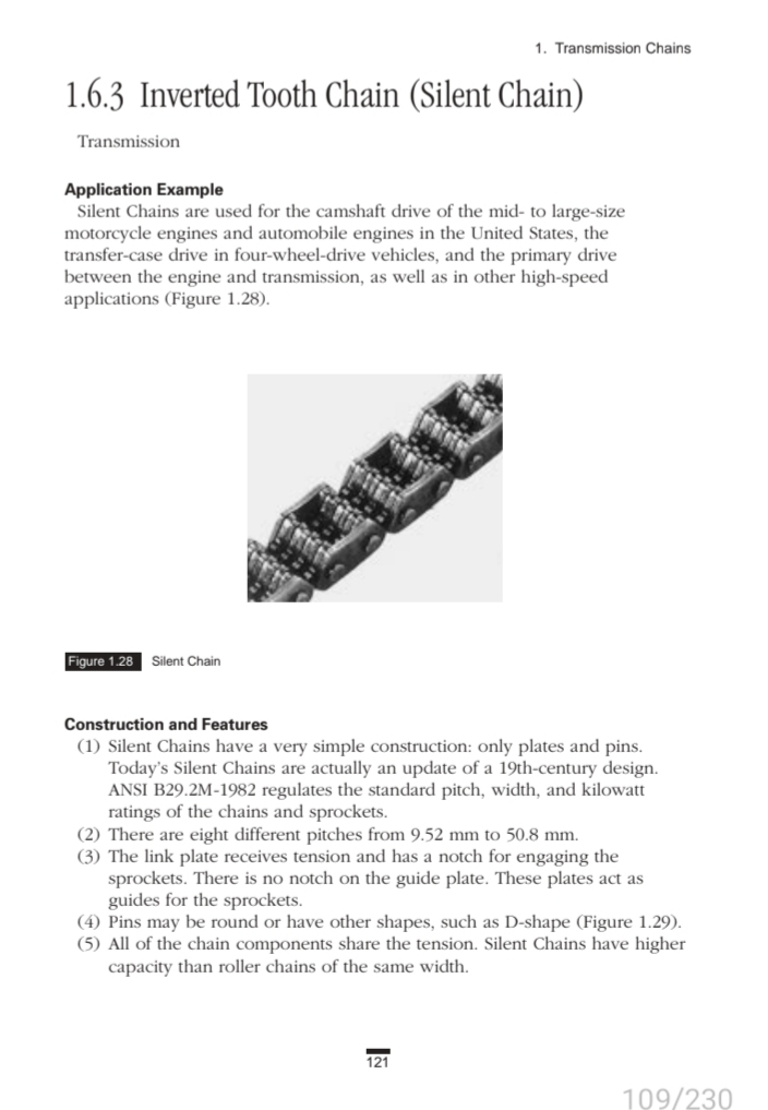

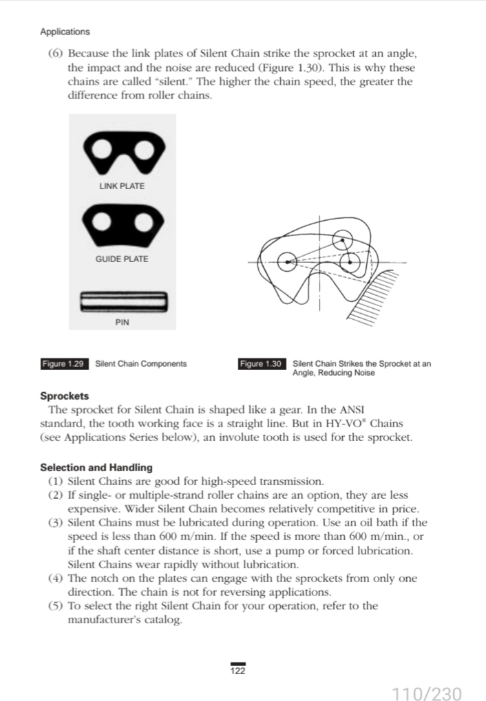

Just to add more re chains I have found this doc of interest. Though dated (1997) it is full of info that I never really thought about chains and how they do what they do.

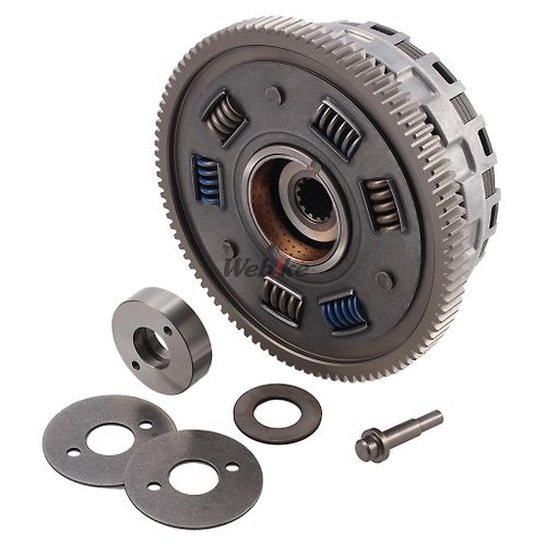

19 Jan 2025 10:45 - 19 Jan 2025 11:17On the J/GPZ there is more case clearance around the clutch basket and the cover is bigger .I'd like to hear more about the clutch basket removal without splitting the cases on a J motor.
The clutch also has largish removable bearing center behind the hub which when withdrawn allows the basket to be dropped to one side out of engagement with the crank and then lifted out of the cases.

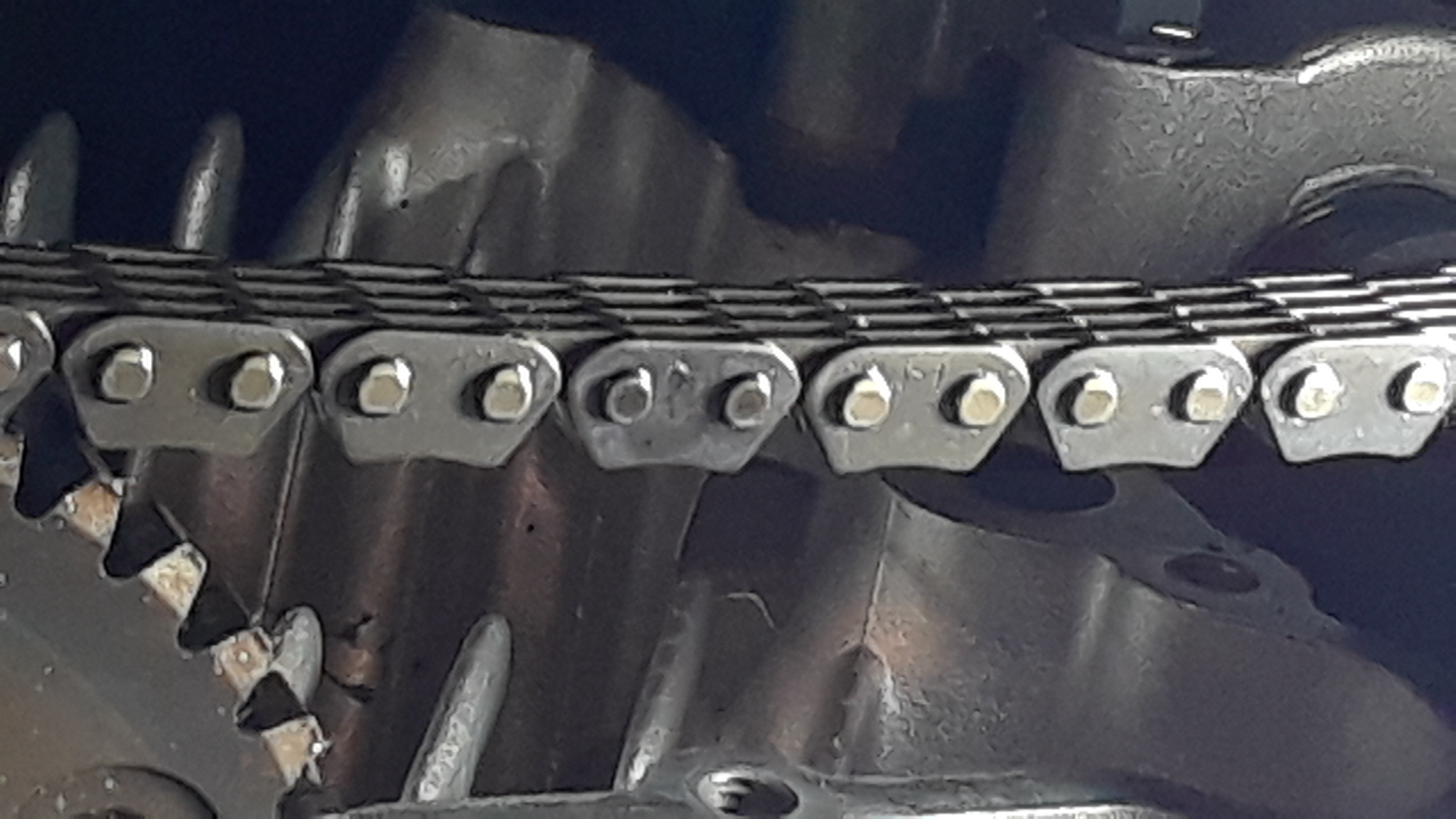

Here is an additional note regarding my experience with the Silent Cam Chain.
It has been three years (15K miles ridden) since the stretched out cam chain in my old motor was economically replaced with a separated link-kit chain, utilizing a specialized JMP riveting tool made in Germany.
I would reuse this chain if a new one wasn't available.
