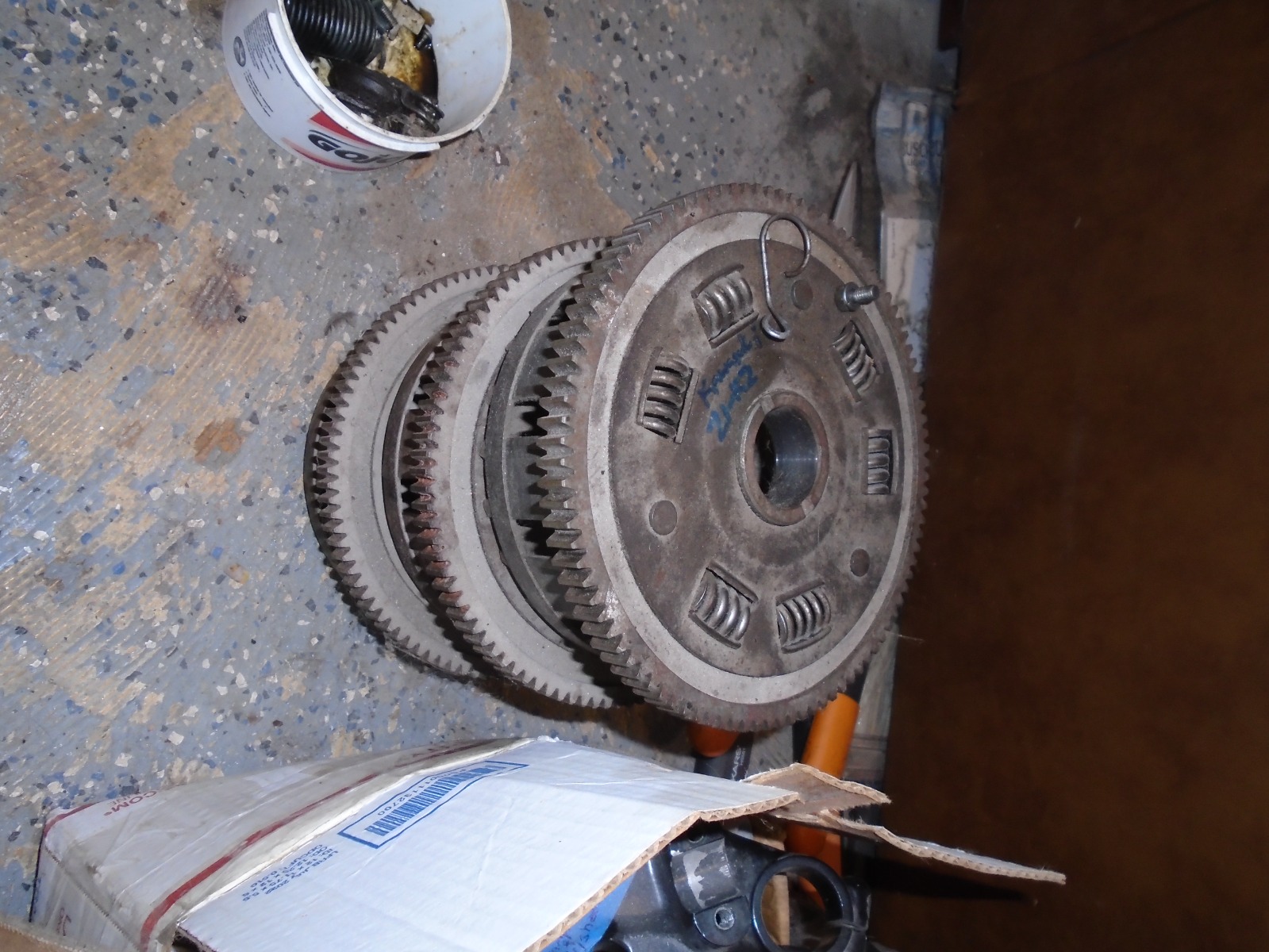

Yes,After a break of 8 years, you forget a lot of things, and as I said, I've never just removed the lower half of the housing from an otherwise complete engine...
I still have an complete Basket with all inner and outer parts here, in a very good condition: You can´t move the springs radial or axial when you touch them, looks like new.

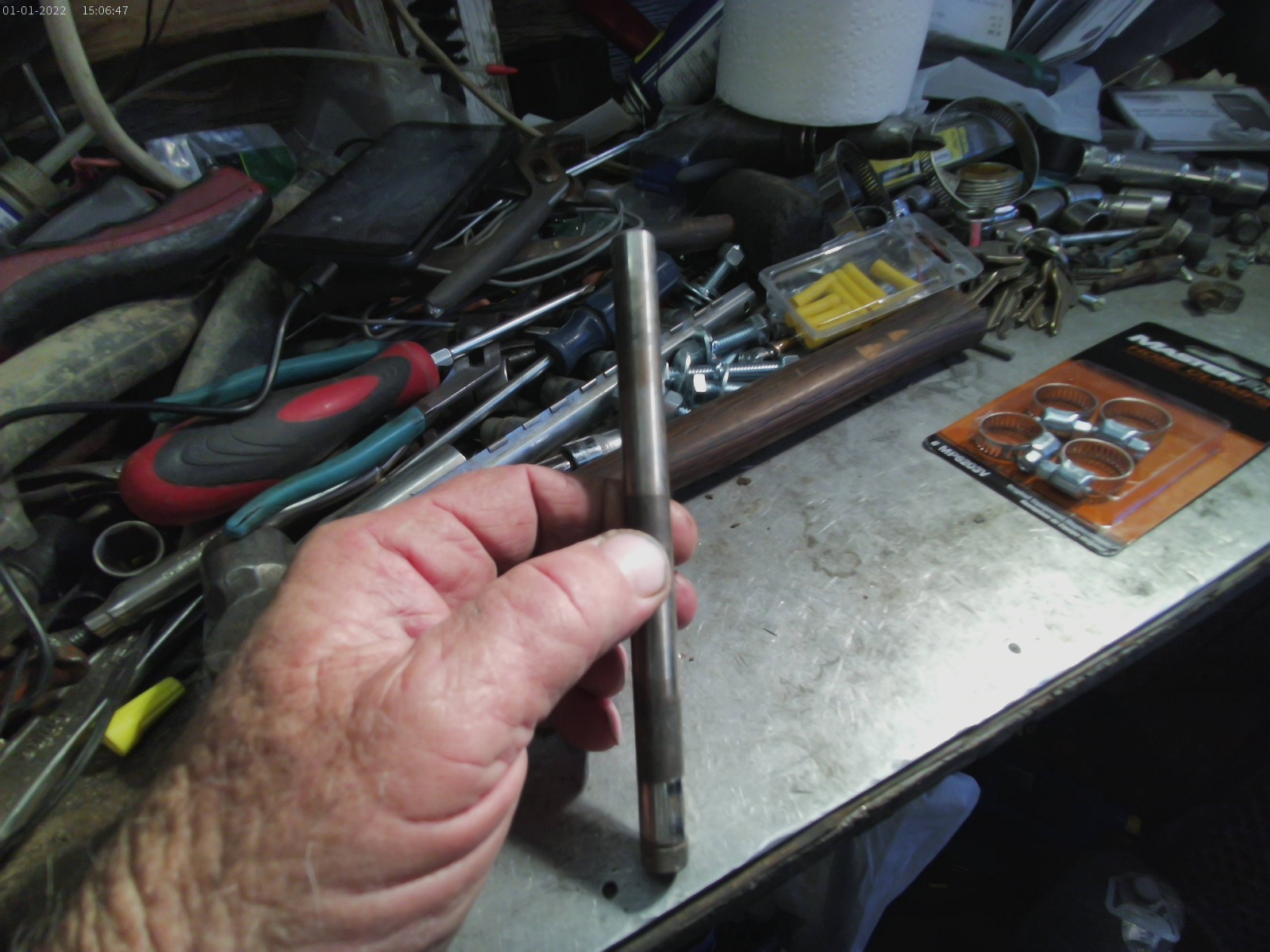

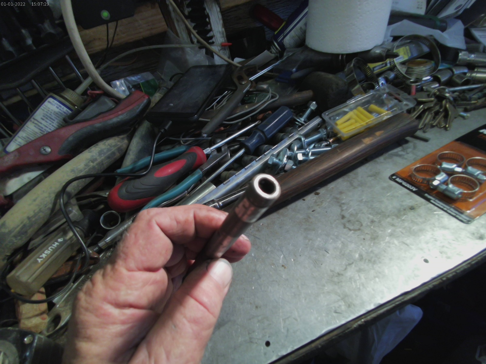

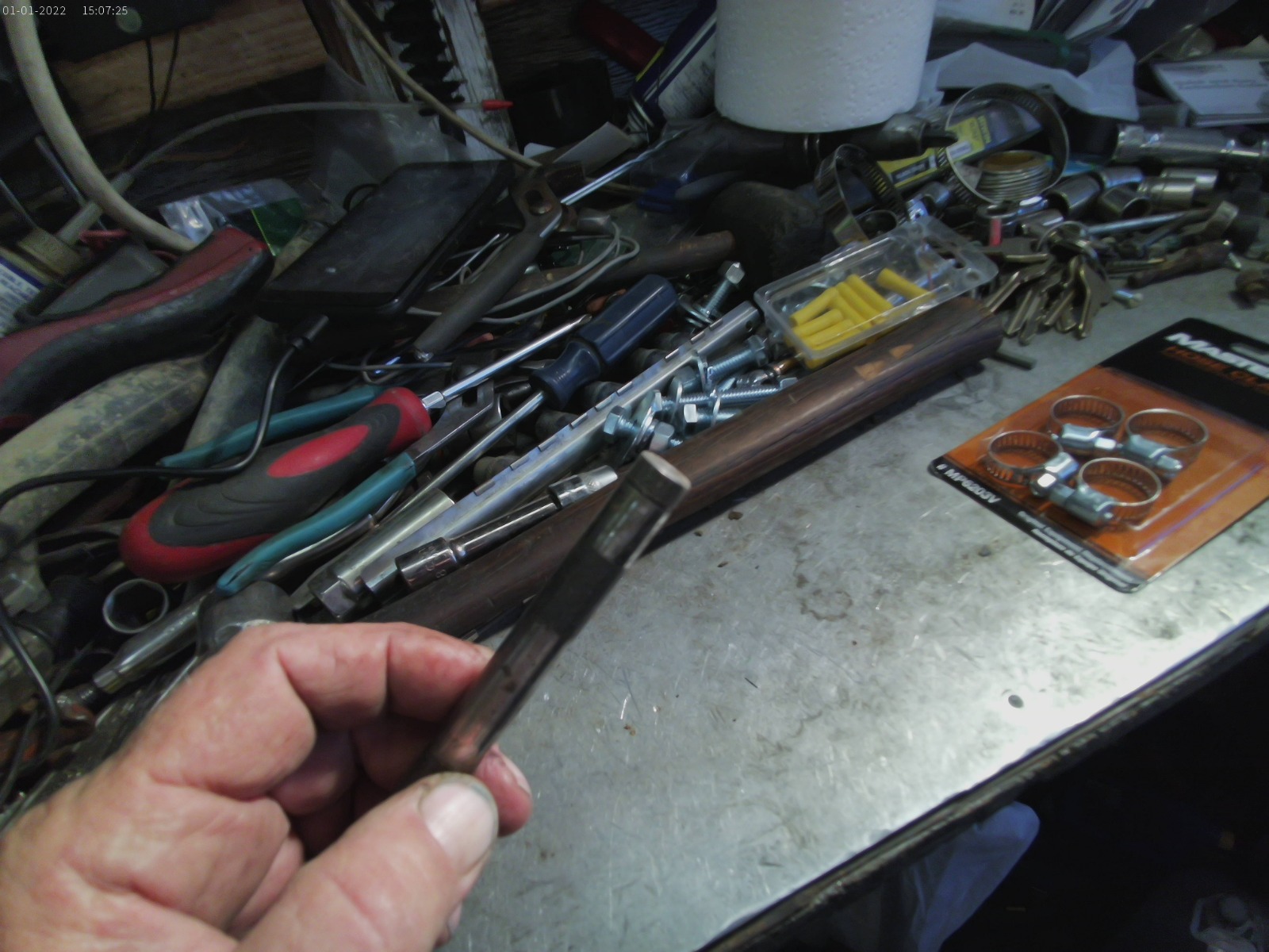

I did that to swap my transmission. The best thing I did was to install a solid shift shaft as the old one was hollow causing mis shifts in second gear and destroying the shift dogs on the gears.
APE sold solid tool steel ones.

The one I have came with a tranny I got on eBay. The one shown must be the original and when I looked it up it was said they went with solid ones. The second I installed in 15 started popping out of gear in only a few years. Then I noticed APE was selling them along with a billet main fork. The later bikes came with a heavier one so I used the new one I bought. 1075 kit and I RIDE THE PISS OUT OF IT no problems so far. It's been almost two years. I'd say it's worth looking in to.
