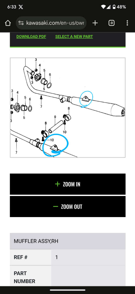

* Edit* Disregard, stared at it long enough and figured it out. Pipe has to go first apparently.
inally have all the bolts/gaskets/clamps. Took it all apart without issue...but of course as I'm putting it back together, I'm pulling my hair out trying to remember how the header pipe mounts to the engine. Followed the diagram and my memory but it seems like there's nothing keeping the pipe against the block. The 'collar' that sits around the pipe is large enough for the pipe to go in and out without stopping it and my recollection (and the diagram) makes it look like that's what holds it but I have to be missing something.

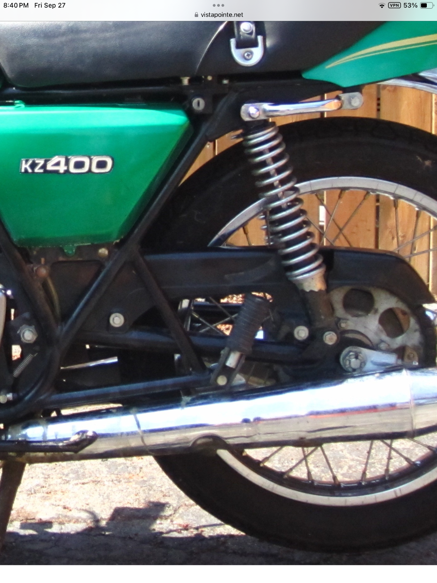

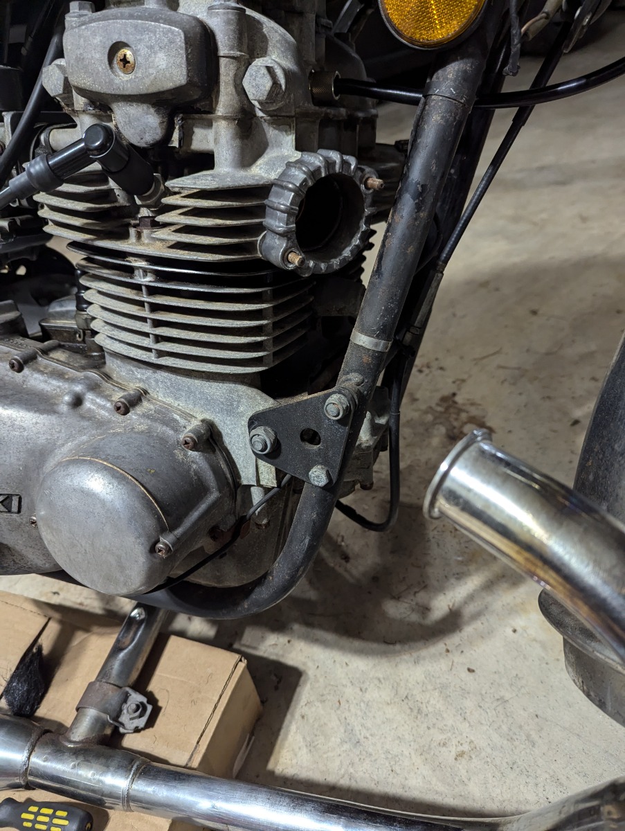

Question that's not in the diagram, are the mounting points for the pipes meant to go directly into the bike frame? I've got brackets/metal strips with holes there from the aftermarket units it came with and the stock pipes are like half an inch short of making it to those studs.
'76 KZ400
- Posts: 8403
Re: KZ400 Exhaust Swap
27 Sep 2024 18:42
The following user(s) said Thank You: ThatYeti

Thanks and it looks like there may have been a second pic that didn't load but the one that did is hard to tell how it mounts, is there a bracket? Or does it mount right to the frame stud?
'76 KZ400
- Posts: 8403
27 Sep 2024 19:29
No extra bracket. The welded on bracket slips over the end of the foot rest mounting bolt.
