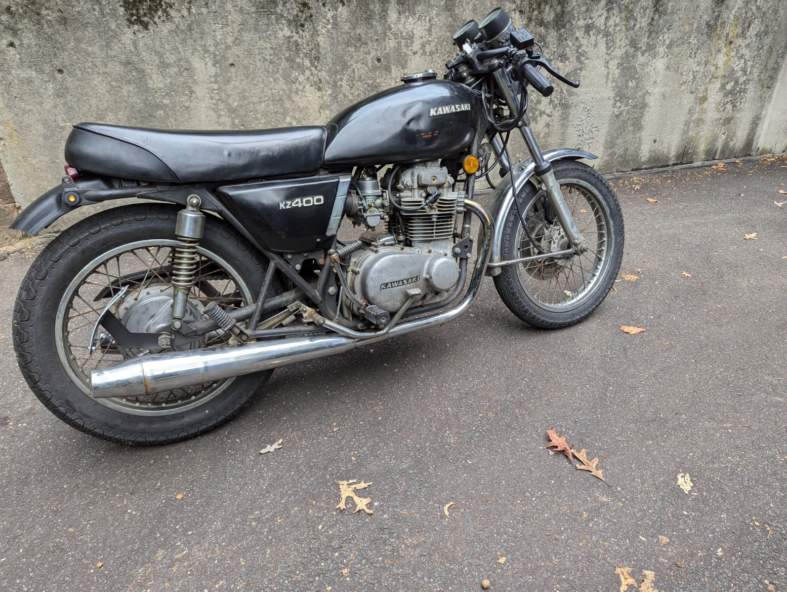

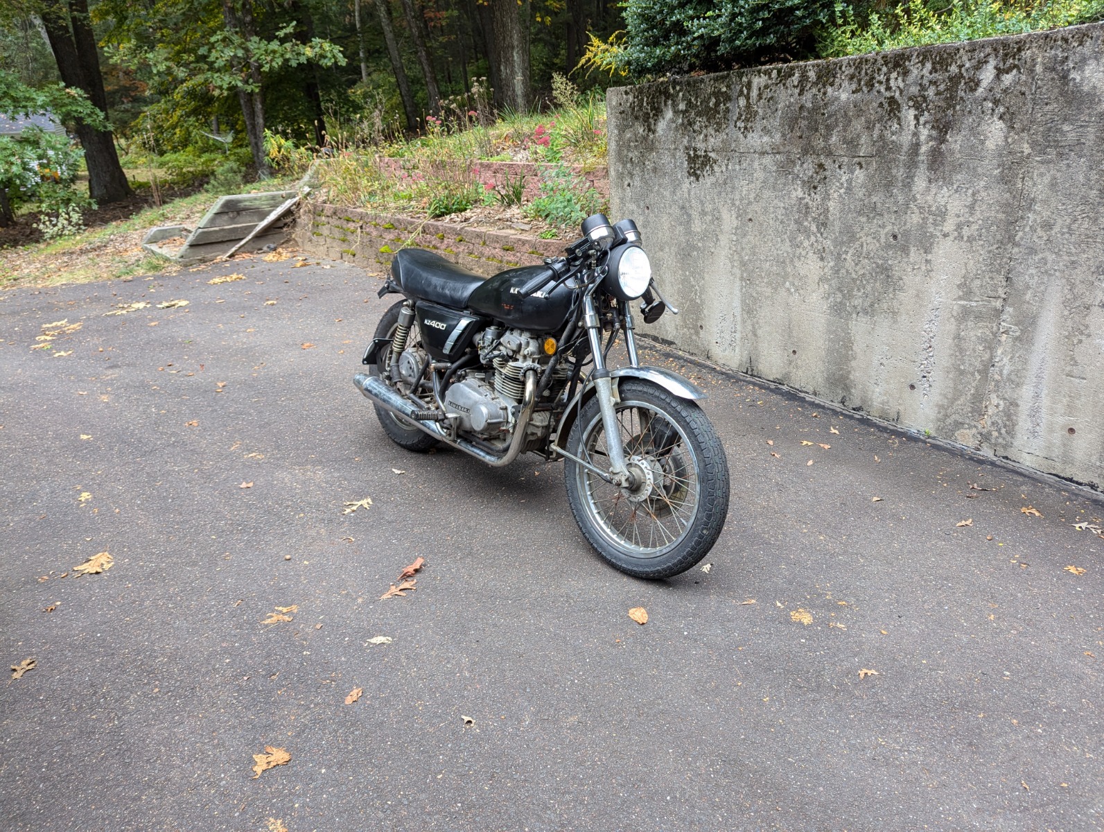

Lots of wiggling and fiddling but managed it get it all on and connected. I'd guess with an extra set of hands and doing it anywhere but on the ground/kickstand would have helped immensely but really happy with how it sounds. Much quieter and aside of a little extra weight there really shouldn't be any downside. Will try to post a video but a pic at the very least.
