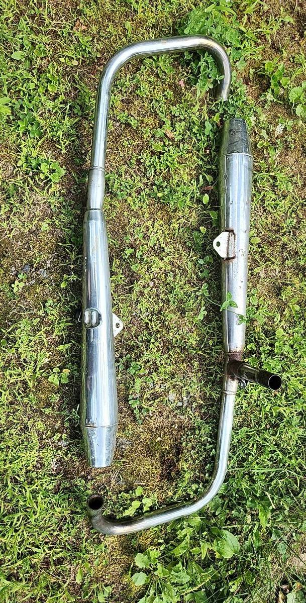

Finally managed to find a used original exhaust for my bike to replace the super loud franken exhaust that it came to me with, after having zero success quieting it down with different replacement baffles.
Question now is what all I might need to swap in the new pipes. Do I need to replace any gaskets? Any tips on getting the old pipes off the studs without breaking anything? And are the pipes I got the style that caused oil leaks due to the crossover pipe? If so should I cap those off?
Looking to swap everything all at once so if I need more than the missing clamp for the crossover pipe I want to order it ahead of time.
Thanks as always
Thanks as always

You should replace the gaskets between the pipe and cylinder head, you can use a small amount of exhaust sealer on the balance pipe. With the studs you should soak them with penetrating fluid and repeat over a couple of days (not when hot as penetrating fluid is flammable) when removing the nuts - if they go tight wind them back on and clean the stud with a wire brush, apply penetrating fluid and wind off again (keep repeating this process until the nuts are off)

According to Kawasaki site the exhaust pipes for the 76 and 77 models did not have the cross over pipe, but it does show this pipe for the 78 model year. Which does show the clamps and gaskets it used.
www.kawasaki.com/en-us/owner-center/parts/142603/1978/KZ400-B1

Guess the new to me exhaust must be from a slightly newer bike, but holding it up to the pipes on it seems like it'll fit just fine. Do I need to worry about that crossover pipe? Saw an old post talking about how an early version that seemed to run through the engine caused leaks. This one seems like it would run underneath but I guess I could see about welding those holes shut if it'll be problematic.

18 Sep 2024 13:00I believe what you are referring to was a passage in the head (happy to be corrected) the balance pipe in the exhaust helps torque and smooth running by balancing both cylinders - I'm not aware of any downside (probably why the factory fitted it on later models)Guess the new to me exhaust must be from a slightly newer bike, but holding it up to the pipes on it seems like it'll fit just fine. Do I need to worry about that crossover pipe? Saw an old post talking about how an early version that seemed to run through the engine caused leaks. This one seems like it would run underneath but I guess I could see about welding those holes shut if it'll be problematic.
