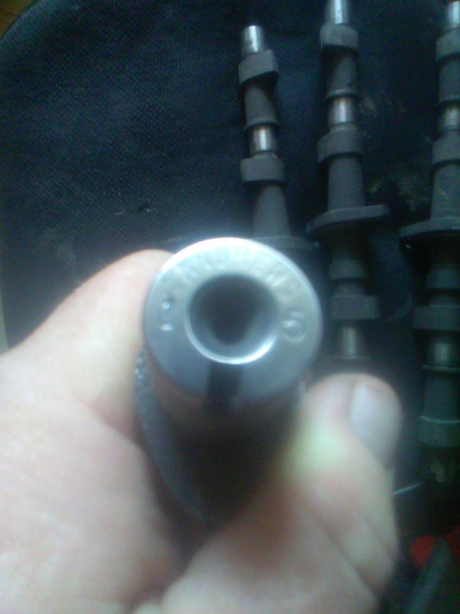

- Nebr_Rex
- Posts: 1889
- Thanks: 295

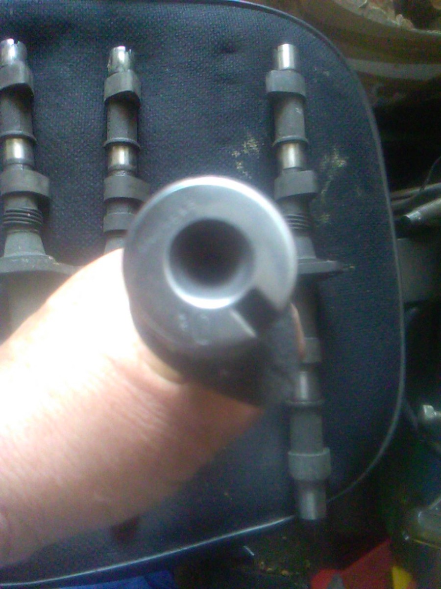

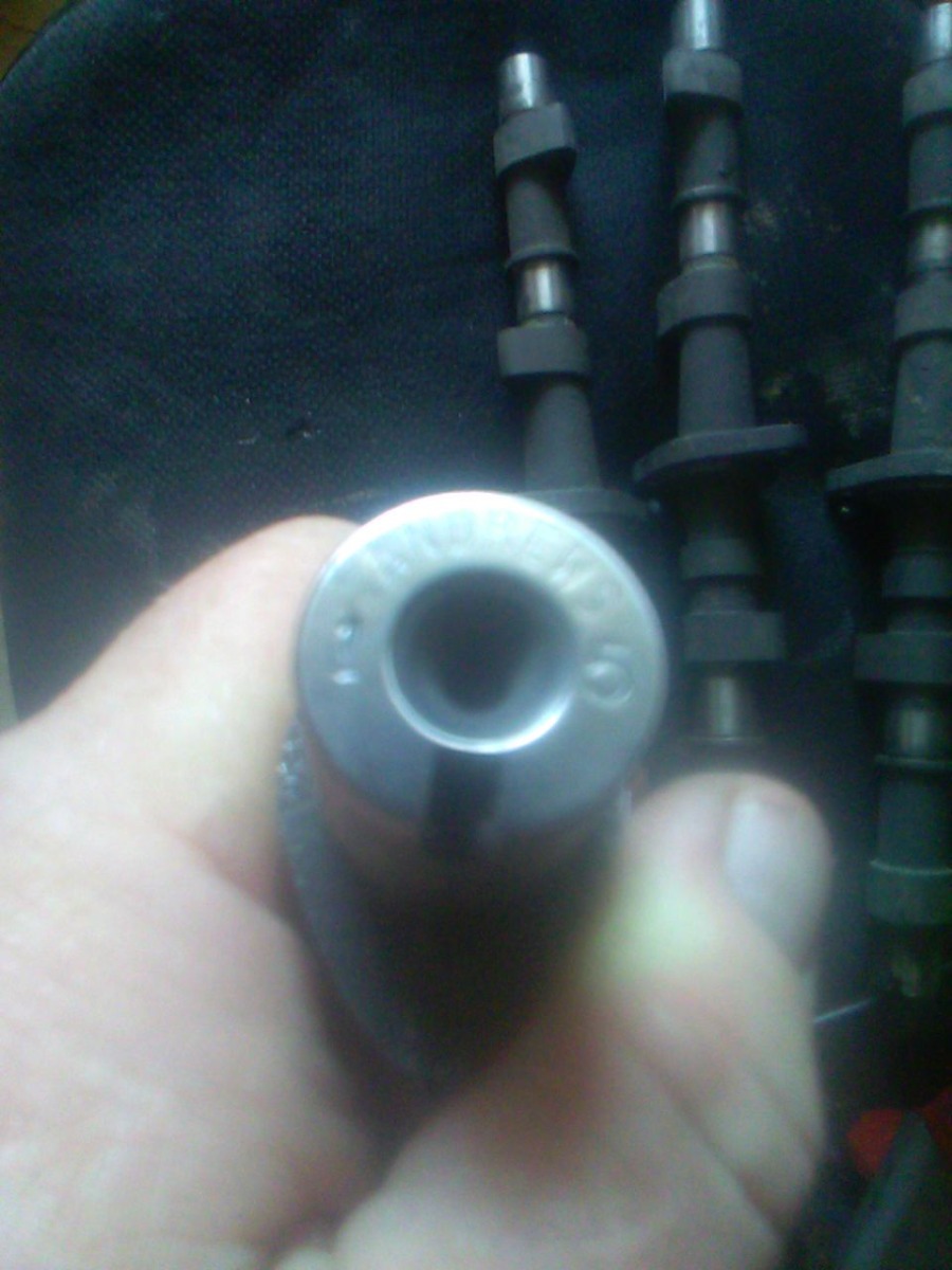

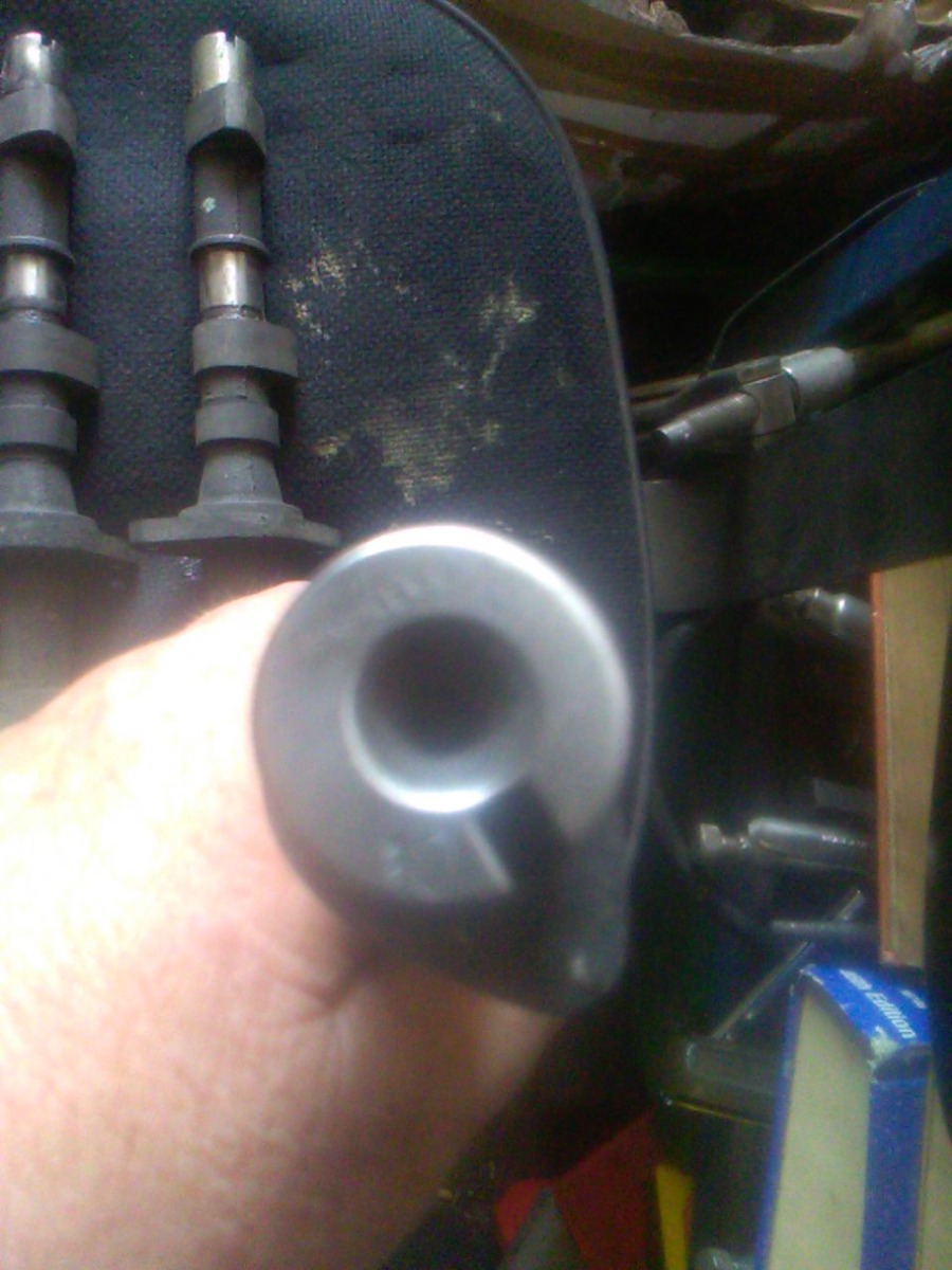

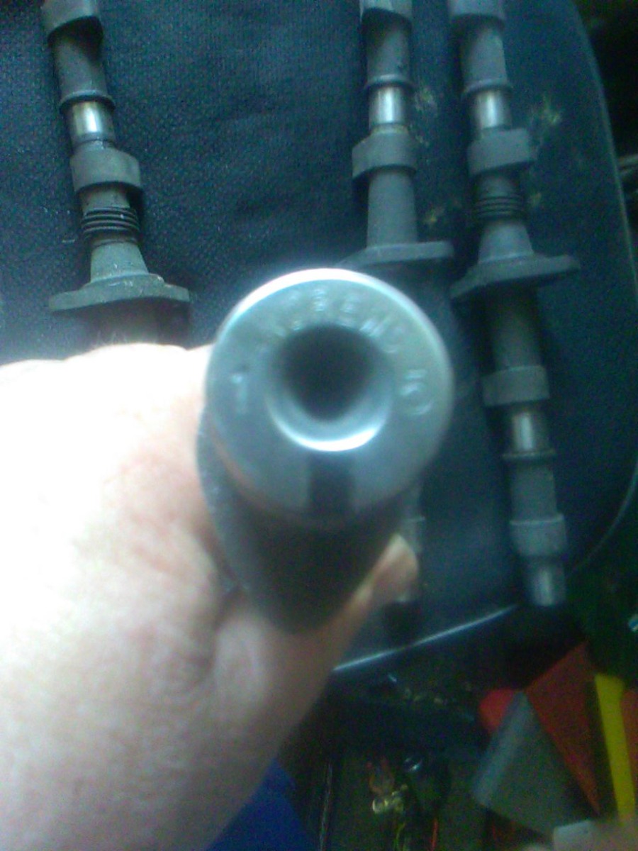

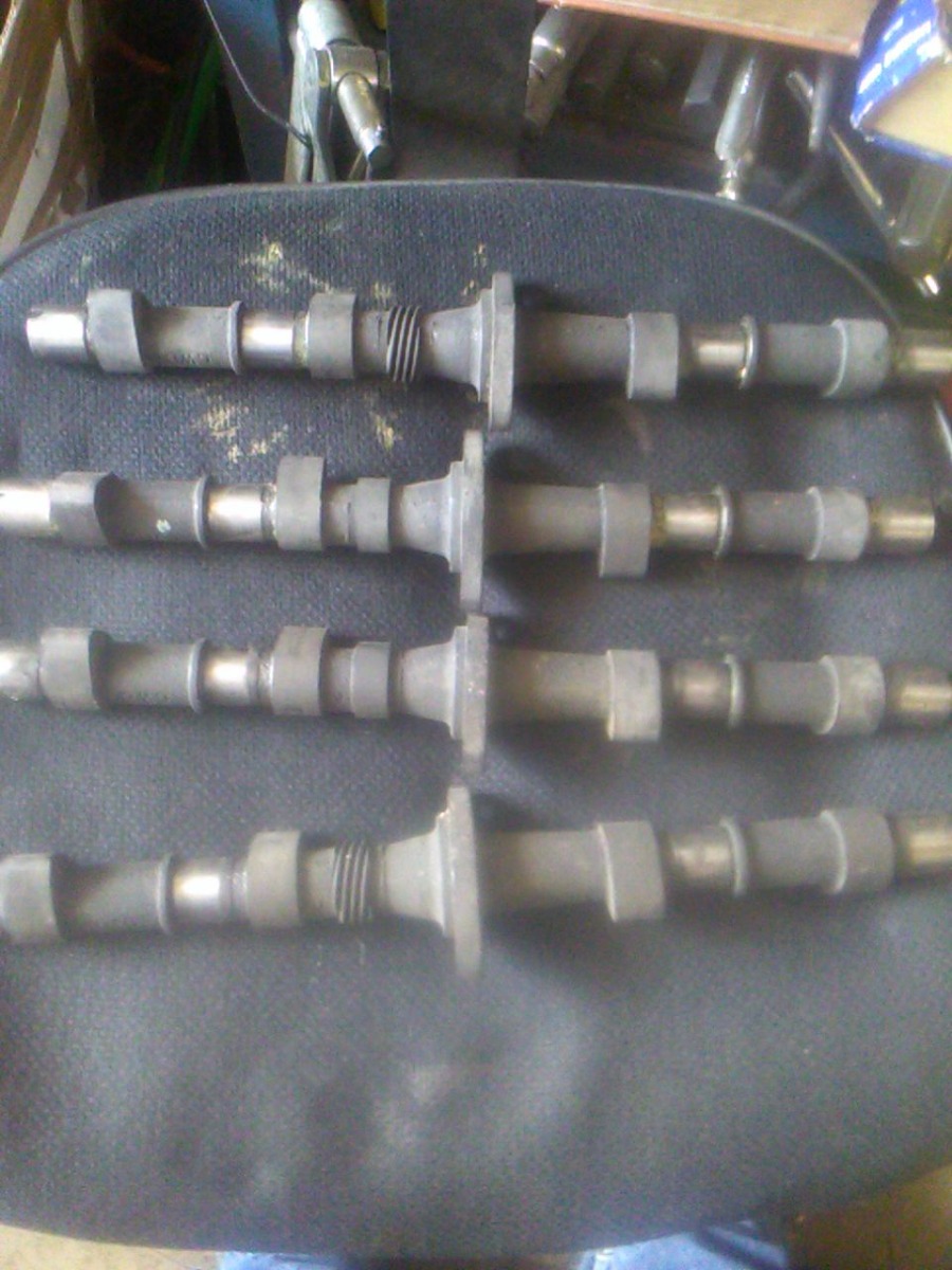

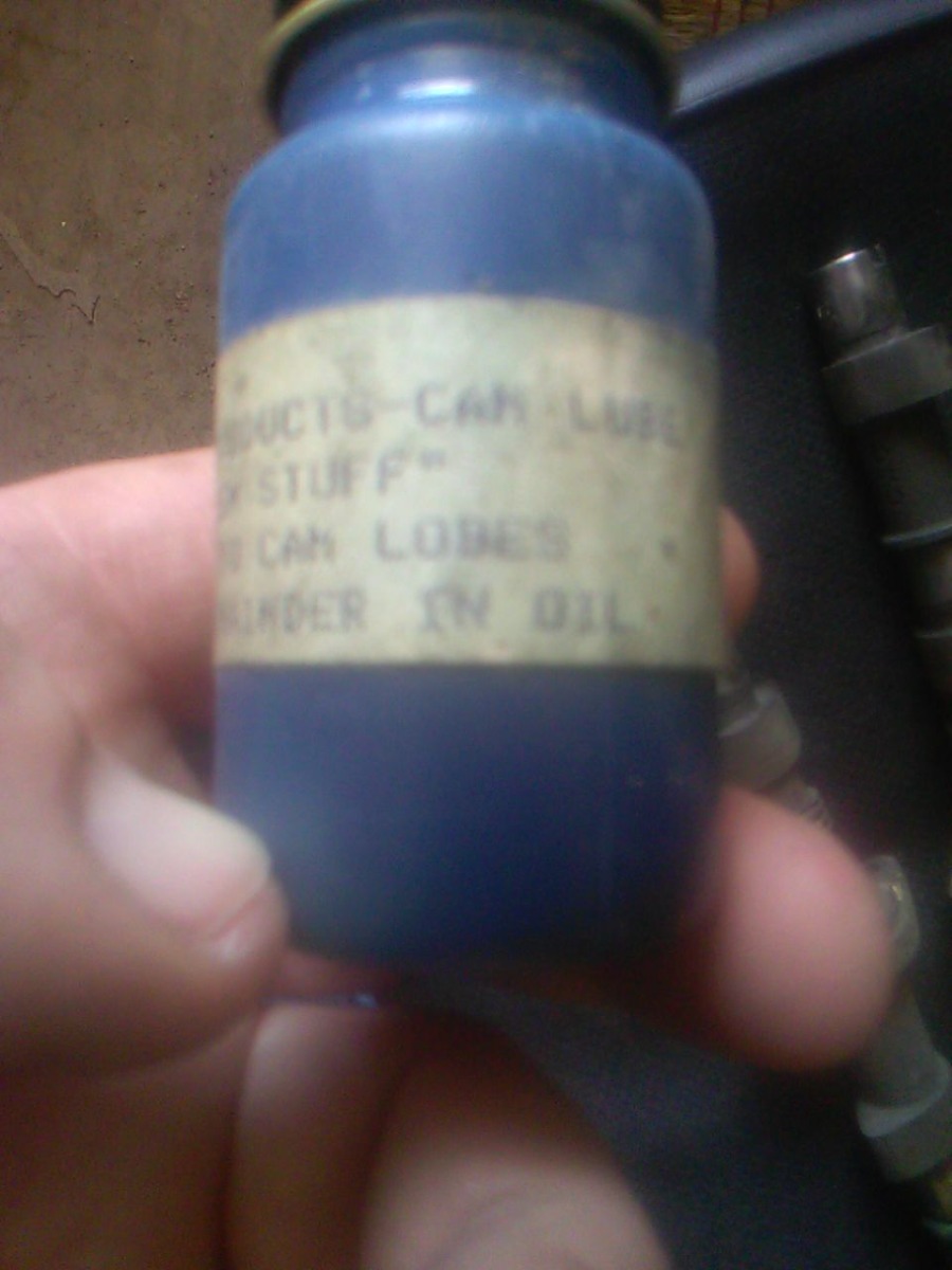

Re: Andrew Cams Question...
17 Jun 2023 18:12 - 17 Jun 2023 18:15
Here they are along with an original bottle of break in lube.

- Franklin
- Posts: 56
- Thanks: 13
17 Jun 2023 19:14
Thanks for putting those pictures up. I'm interested in the #15's and would like to know what you want for them. I attempted to PM you but that didn't work for me. If you are able to send me a PM we can communicate that way. Otherwise I have a secondary email address I can post here and you could email me. Let me know how you want to work it, I'm kind of new on this forum so not sure how to coordinate this.
