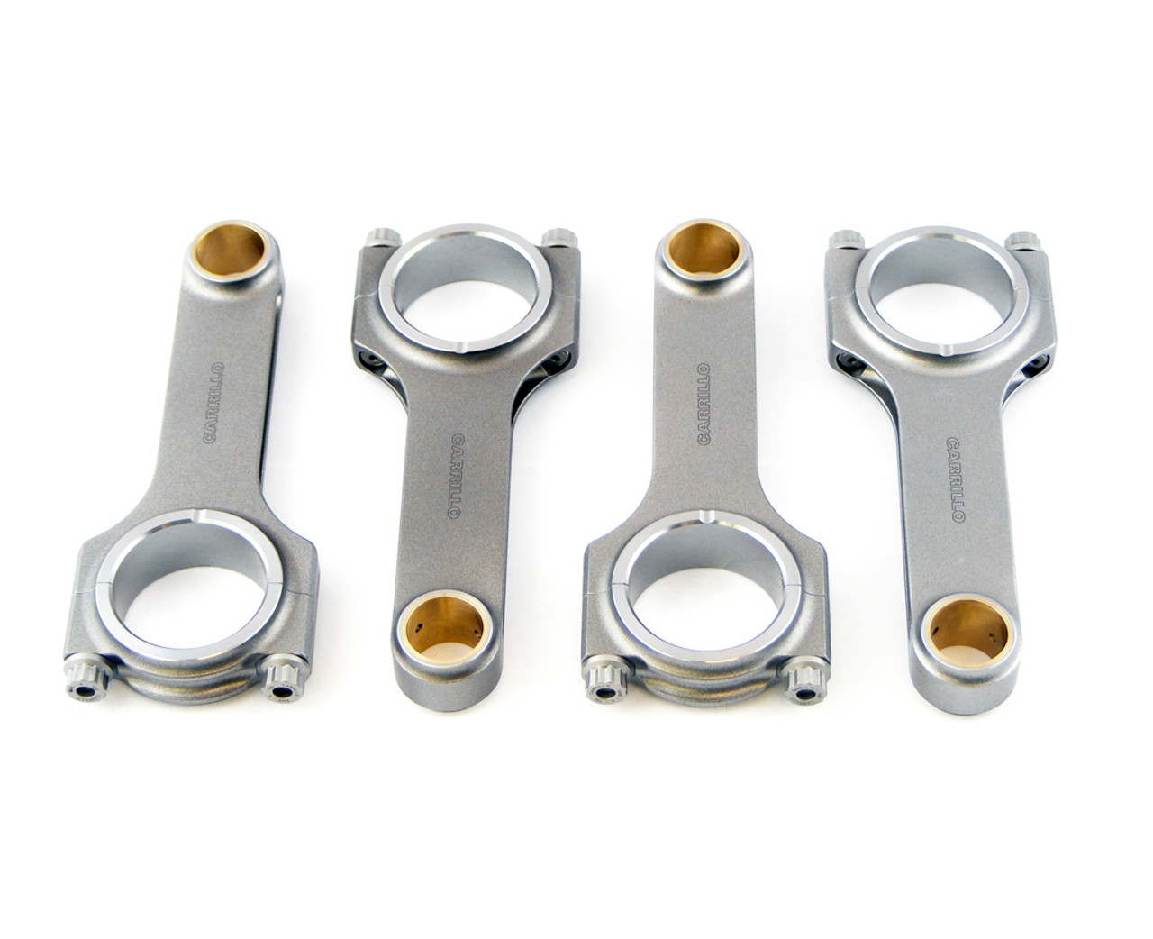

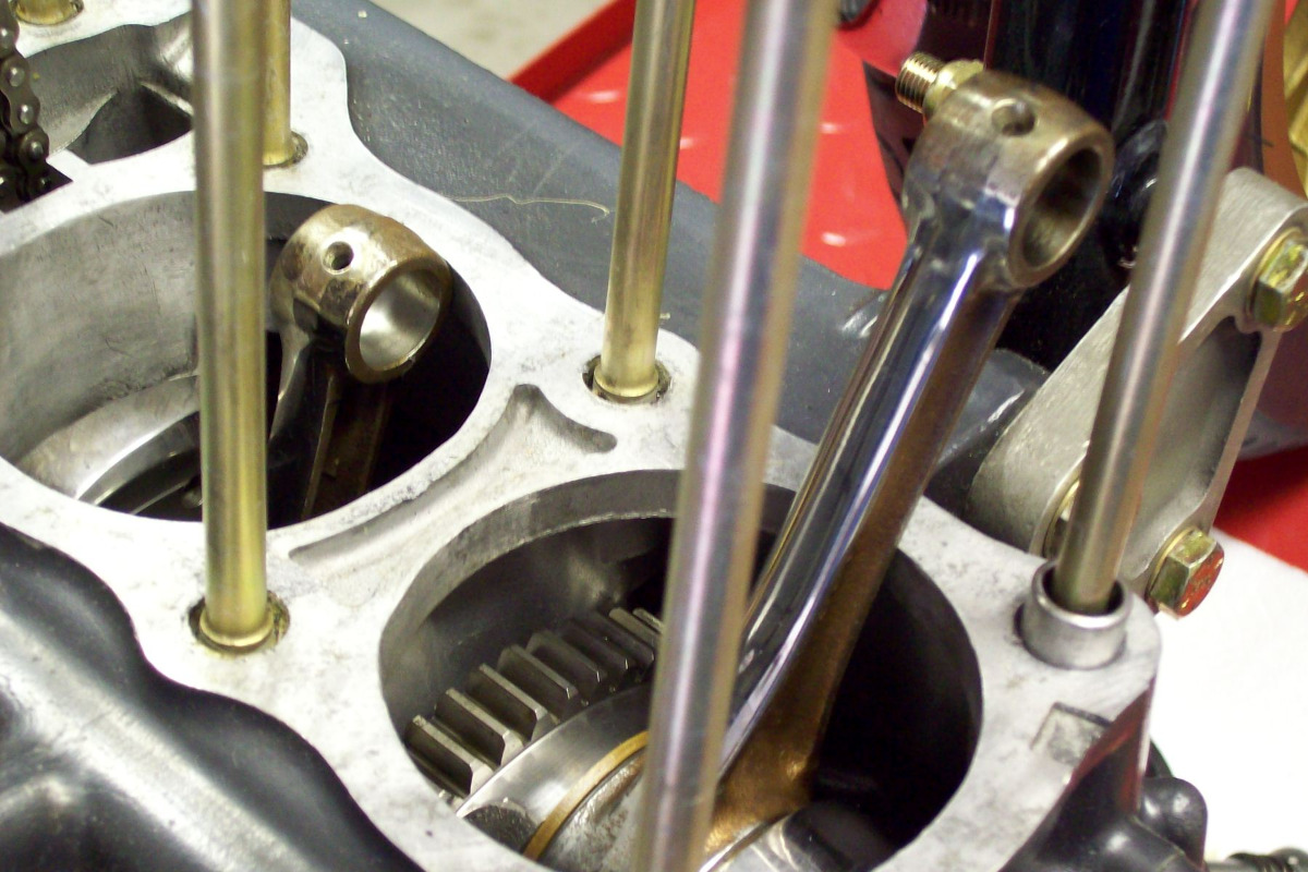

If you plan on getting 100 horsepower out of a Kz750 motor, you better find yourself some stronger, better con rods. Just remember your motor is only as good as its weakest link. In the 750 motor I built for road racing I used some shot peened and polished GPz or Turbo 750 rods. I don't remember for sure anymore. Or if you could find yourself some Carrillo rods that would make your bottom end damn near bulletproof!!!! It really sucks when you spend all that money in a motor and it puts a rod through your cases!!!!
