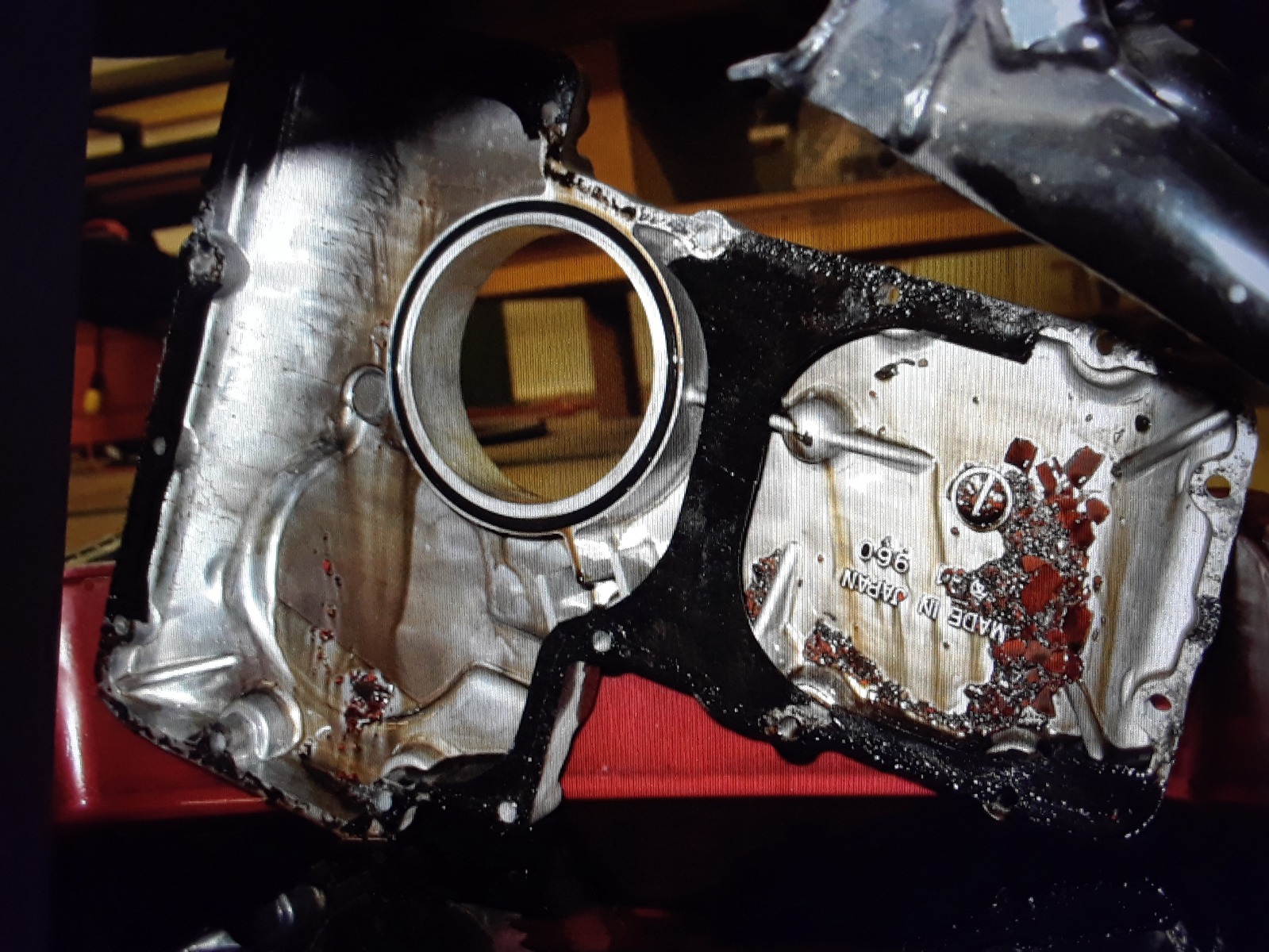

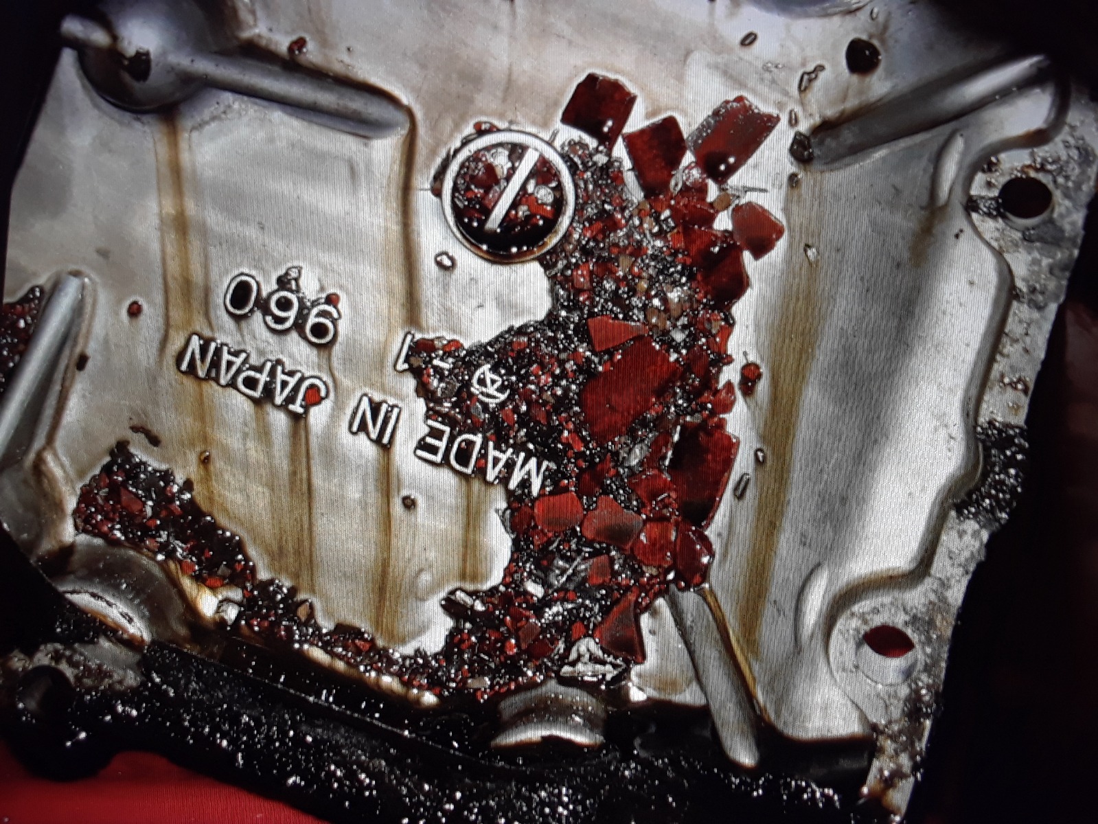

Re: Piston Hole Kz1000LTD 1982
12 Dec 2024 07:50

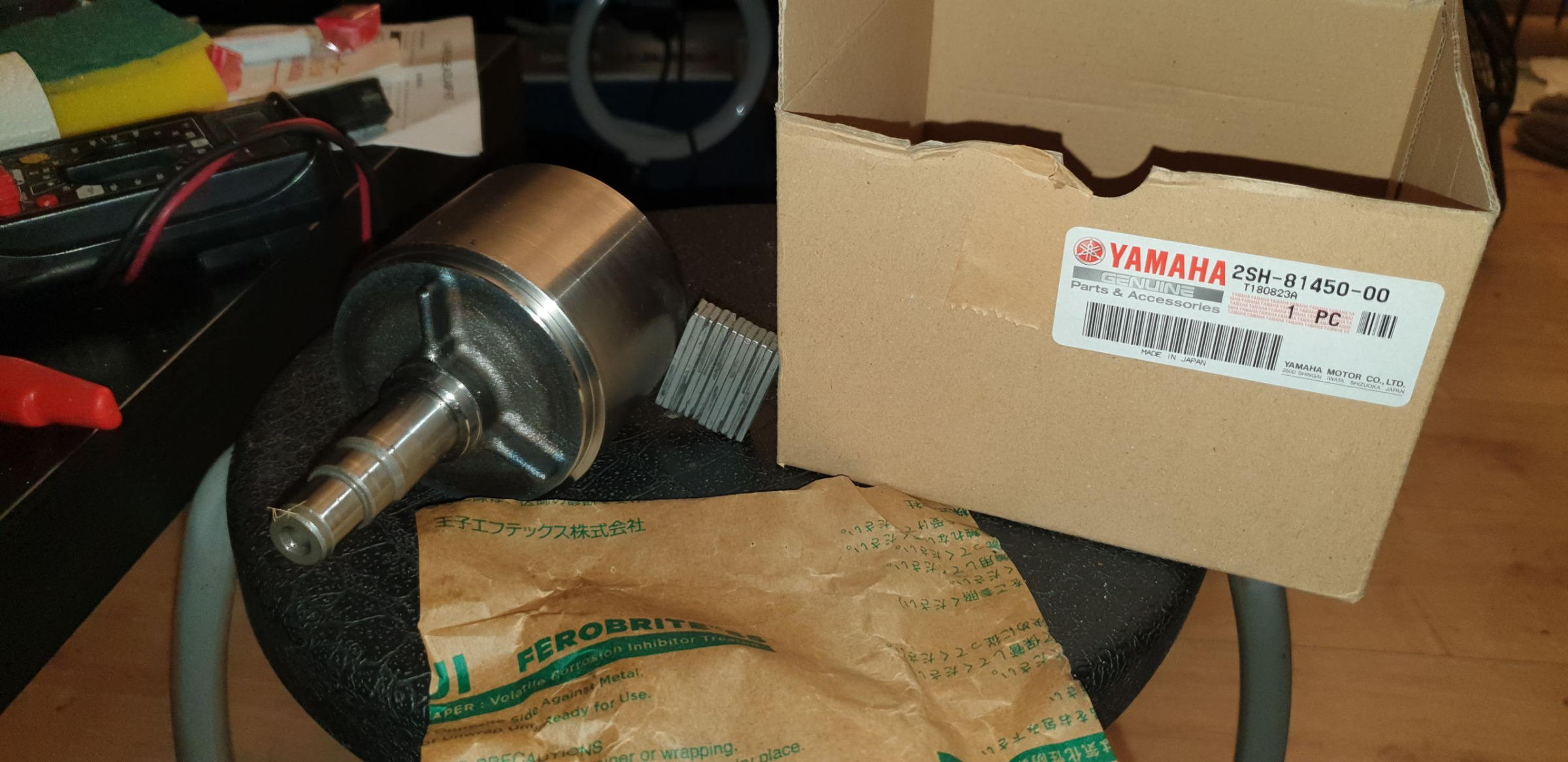

As the magnet and edge material breakdown continues in your engine, the larger fragments will end up in the oil pan, and the rest should ideally get trapped in the filter.

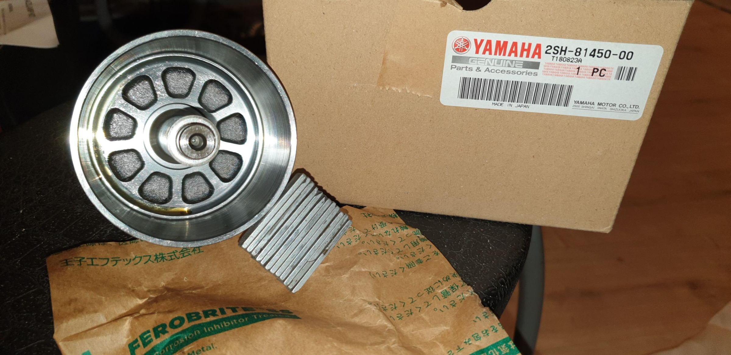

12 Dec 2024 13:12
The rotor only missing some area of the epoxy glue you can easy re-new.
Nothing wrong or worry about the rotor...
For example, Yamaha R1 rotors are common to known to lost the neodym magnets strips due to glue failures.
The next gen R1 rotors have thin metal sheet drum belt to hold the magnet stips in place if the glue failed.
The following user(s) said Thank You: daveo, cartal
12 Dec 2024 23:15I guess in this case at least, the debris is in someone else's oil pan Lol

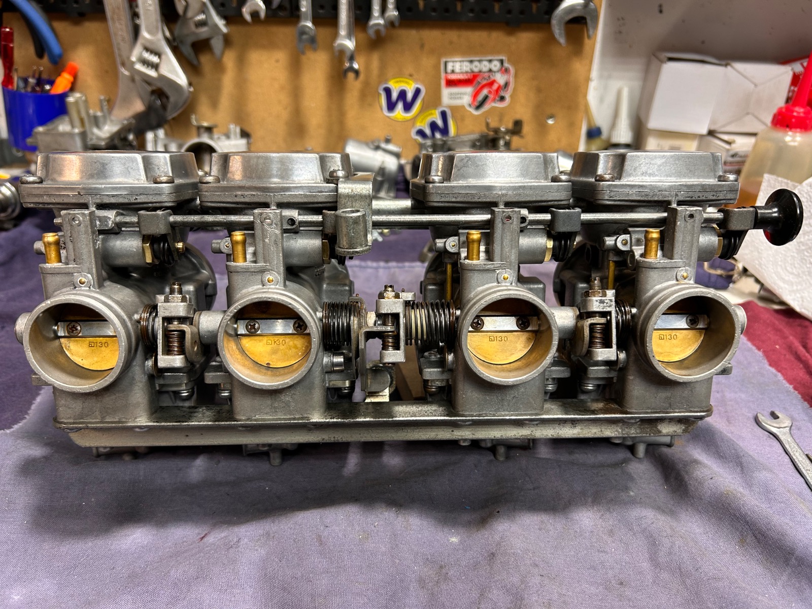

15 Dec 2024 01:54
“New” rotor should be here from Germany in a week or so. In the meantime, I got back to the carburation, as I have a very rich condition.
Took the carbs out and measured rhe float height. Some adjustment was needed and I am now waiting to be able to test the bike.
Gave it a go again at balancing the carbs (as I couldn’t before). Quite satisfied with the end result.

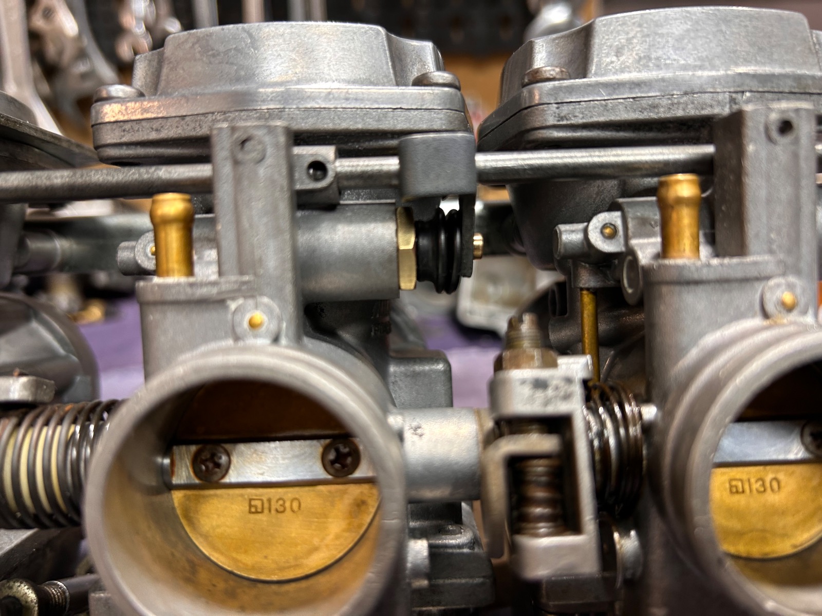

08 Feb 2025 12:58
Got carried away with rich carbs and followed a thread in carbs, so left this thread a bit abandoned. Back in business. New “intact” rotor from Germany arrived and has been installed. Charges well and makes no noise. All is well there.
in regards to carbs I have now assembled yet another set of carbs. I found a set of carb carcasses really cheap and really clean in Germany, so I decided to forget about those funny restrictors by us carbs had, and start from scratch.
i have now transplanted everything and have also mounted the repaired (by @zed1015) choke plungers, together with new rubber boots. Choke rod works now as it should.
i am finishing now to set up float levels and expect to do a test start later on tonight.
Let’s see if this will run well now. Cheers!
The following user(s) said Thank You: Wookie58, Rolf1976_KZ900

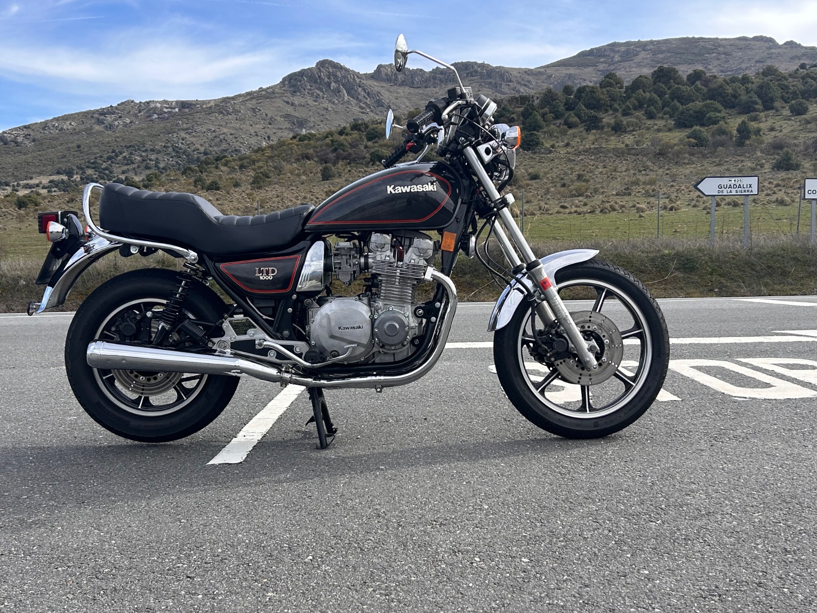

And yes, this is it! Got it’s MOT and finally got her on the road. Just a short (60 km) round trip to get acquainted with, and the realisation it is a much more manouverable bike than I expected, and a really nice engine, with great acceleration. I still did not thrash it, as it has done less than 100 km on the new pistons, but everything works at it should.
great experience.
need to get my speedo fixed, or I will start collecting fines really soon!
16 Feb 2025 06:11
Congrats Cartal!! As you've found, those BS34's are NOT all the same. The Jet needles/needle jet combination is critical. A lot of times person, without knowing, just mix-match bits that fit. Leads to a lot of running crappy issues. Have fun now!!
The following user(s) said Thank You: cartal
