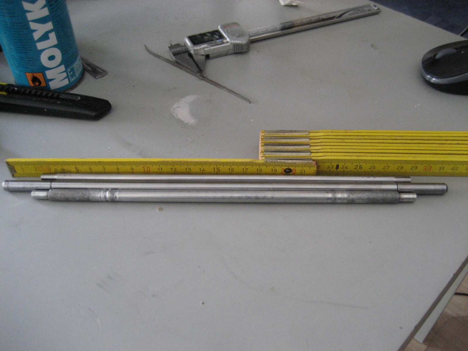

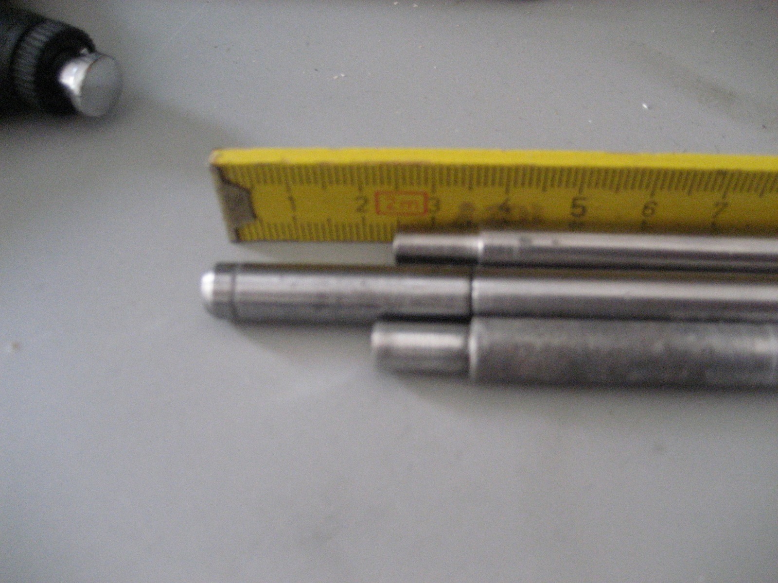

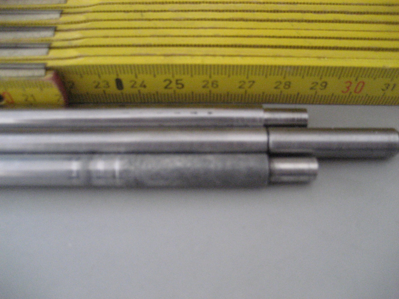

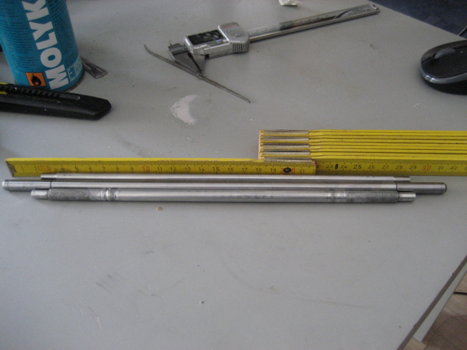

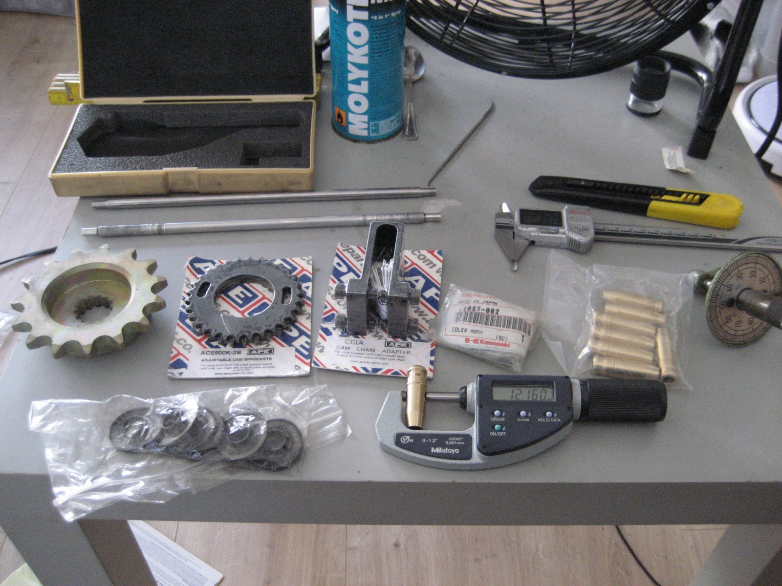

Hardened shaft ends of an aluminum clutch push rod. The oil seal did wear the aluminum rod fast.
Made some spare prarts push rods out of steel.

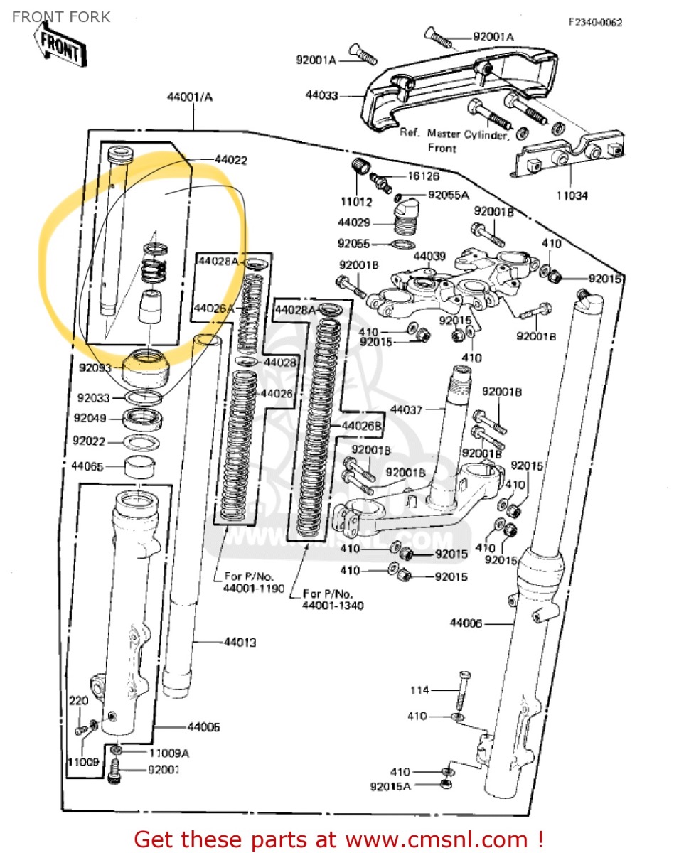

Re: Piston Hole Kz1000LTD 1982
06 May 2024 14:54

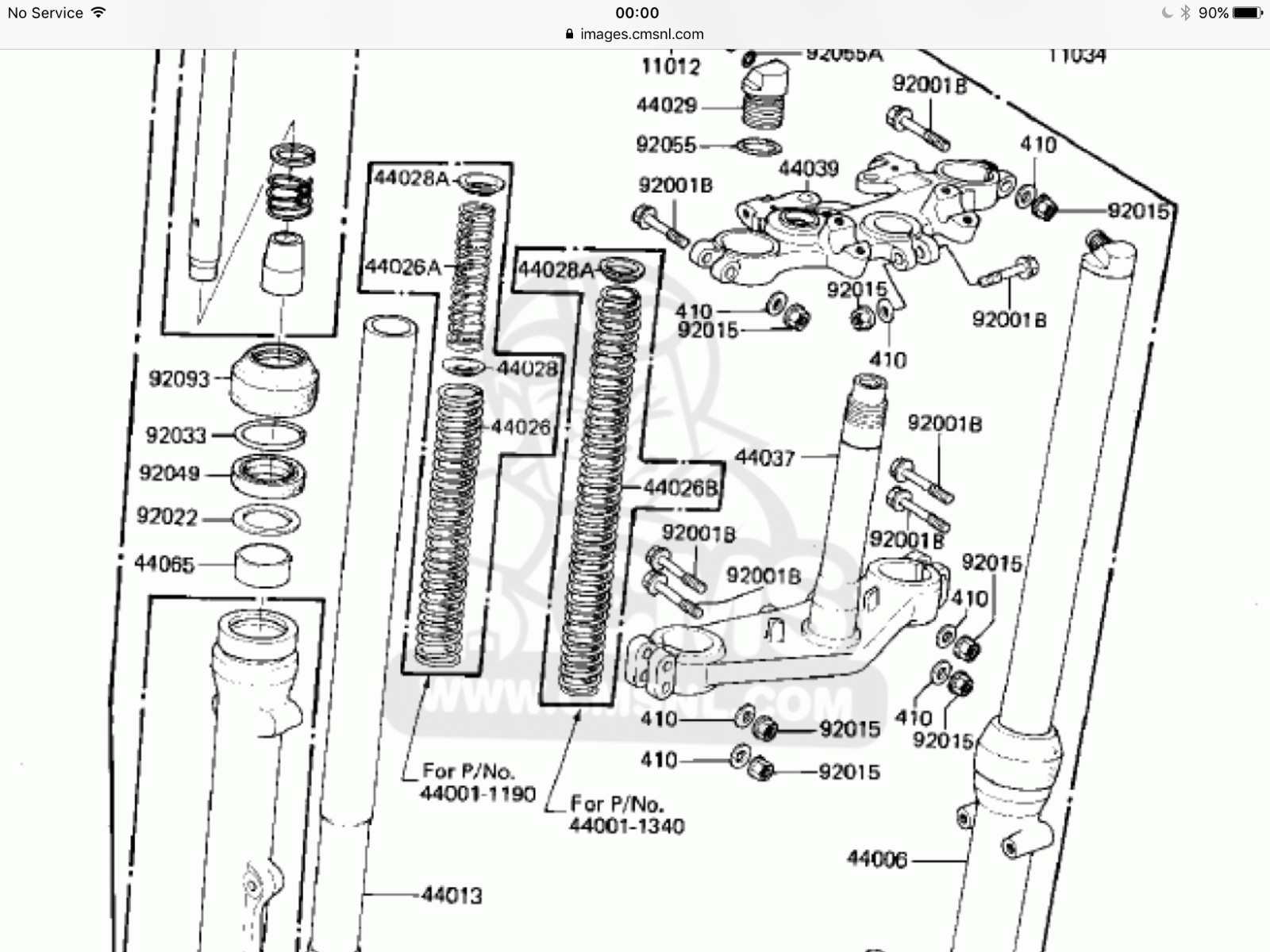

On one of the forks you probably stacked the short rebound spring in the wrong order. I did it once on my 84' Honda Sabre 700S. It took me a little bit to figure it out.

Will give a try to this. I measured both and the short leg is exactly the length Wookie posted.
11 May 2024 17:49
As Kelly says, I’d bet you didn’t get the short rebound spring on the damper first, inside the longer fork.
17 May 2024 15:51
Hello fellow kz lovers. I went into it tonight; only to find that the longer hanging fork has no spring in the hydraulic inside the bottle. The little spring (the really short one) is not there.
im starting to worry about my memory capabilities, but I am 100% sure all parts that came out went in again.
so one fork bar has the lower spring; and the other one doesn’t.
any ideas where can I find such spring? I completely stirred every corner of the garage, but it’s not here.
Could a spring from another bike work?

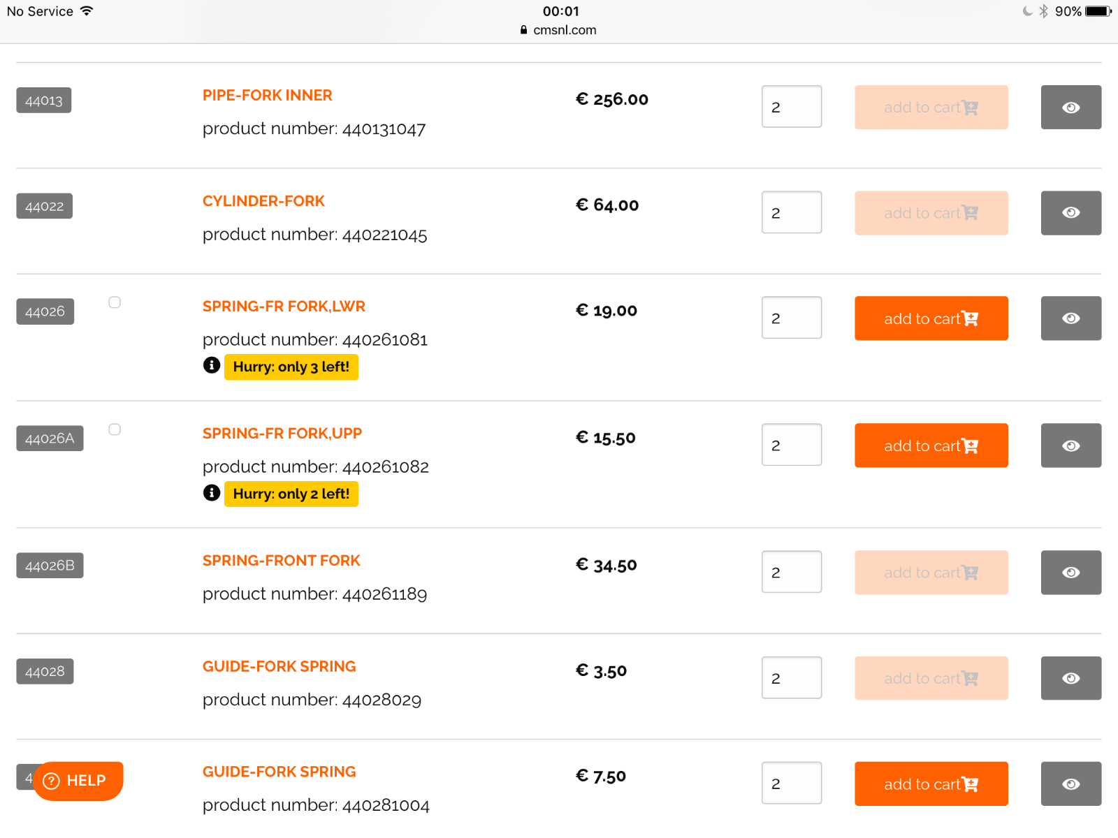

18 May 2024 00:54
The smaller one that goes in the bottom.
seems unavailable. I’m thinking it should not be very different from other forks, so perhaps I can try to find a Vulcan fork spring or similar (just the bottom one, and possibly both legs at the same time so there is no difference).

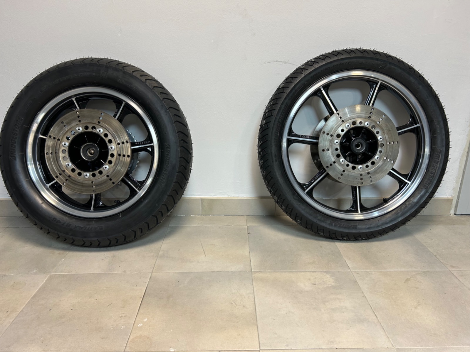

19 May 2024 14:07

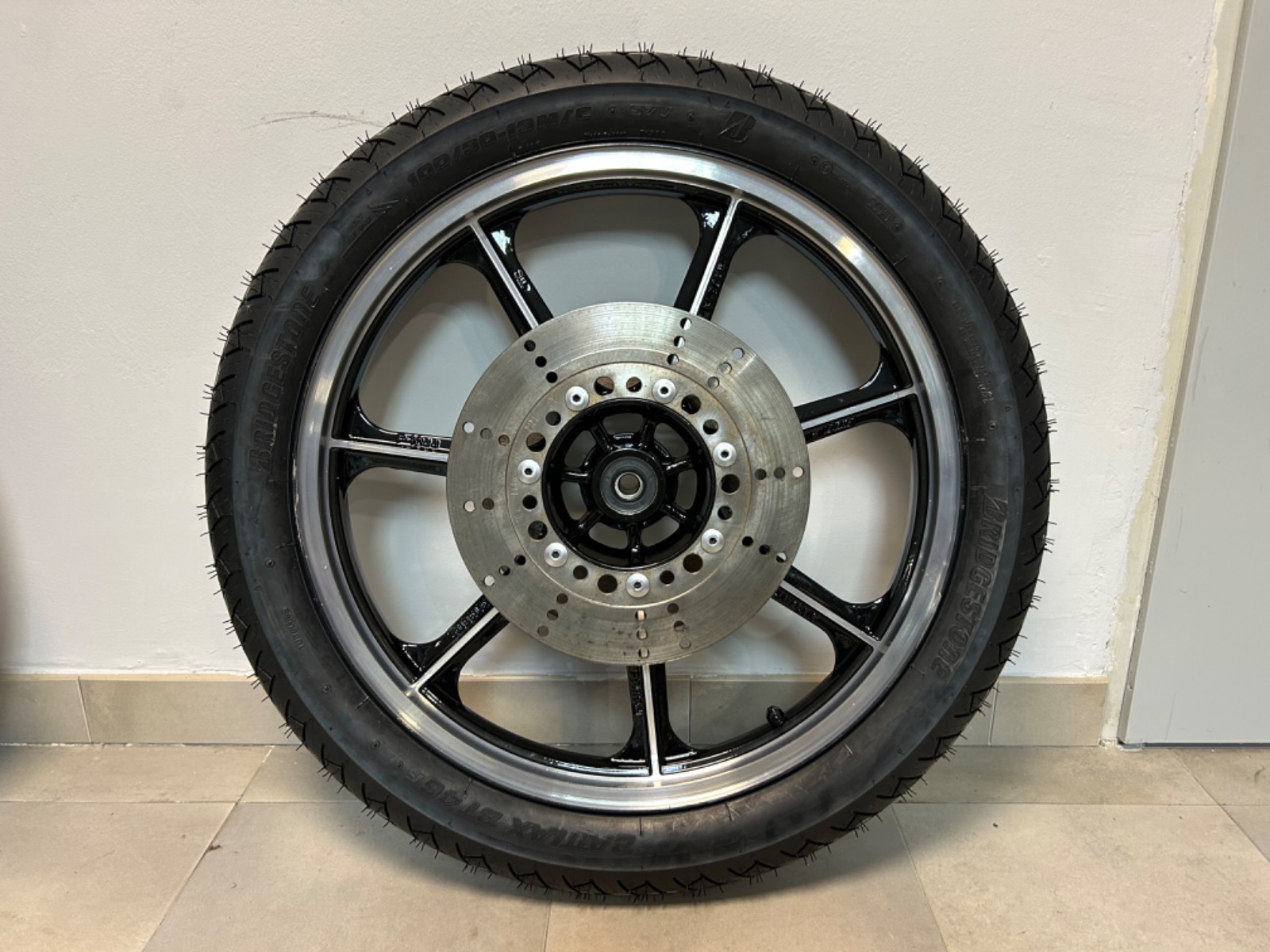

I finally found a complete fork leg from ebay Germany, for 50 euro including shipping, which is the best solution right now.

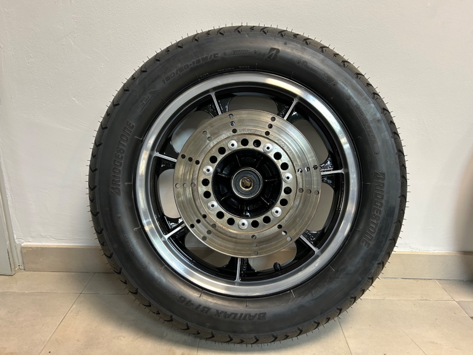

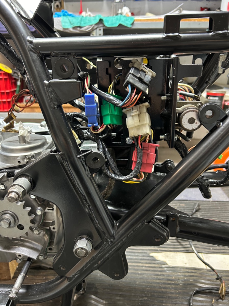

Got the wheels assembled this weekend, and advanced a bit with the electrics. Wheels look absolutely amazing!

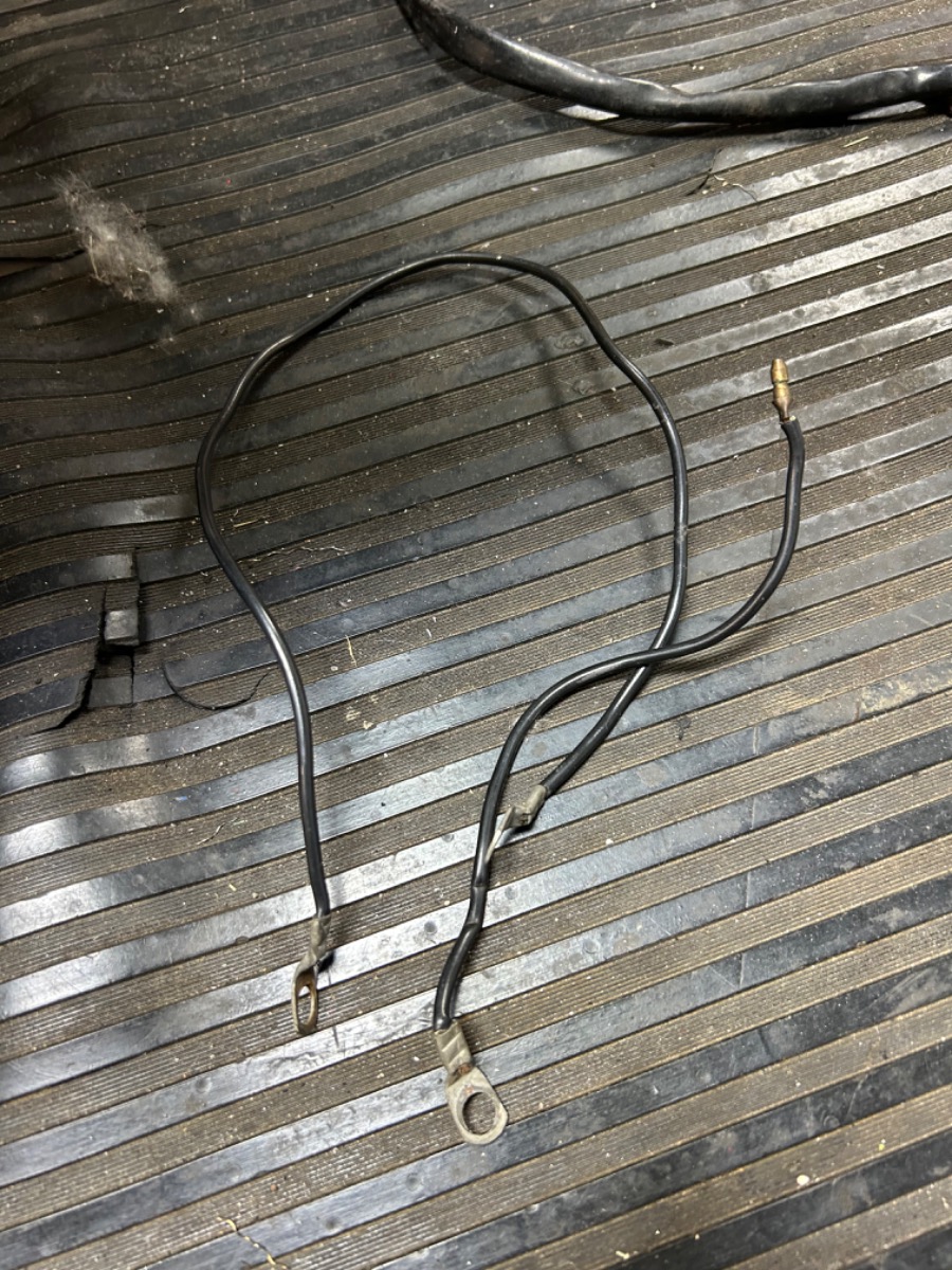

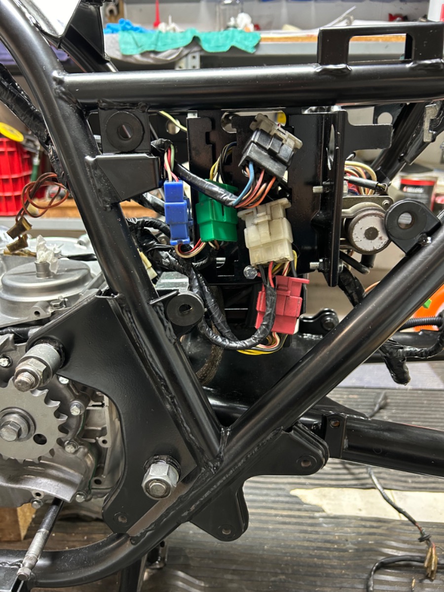

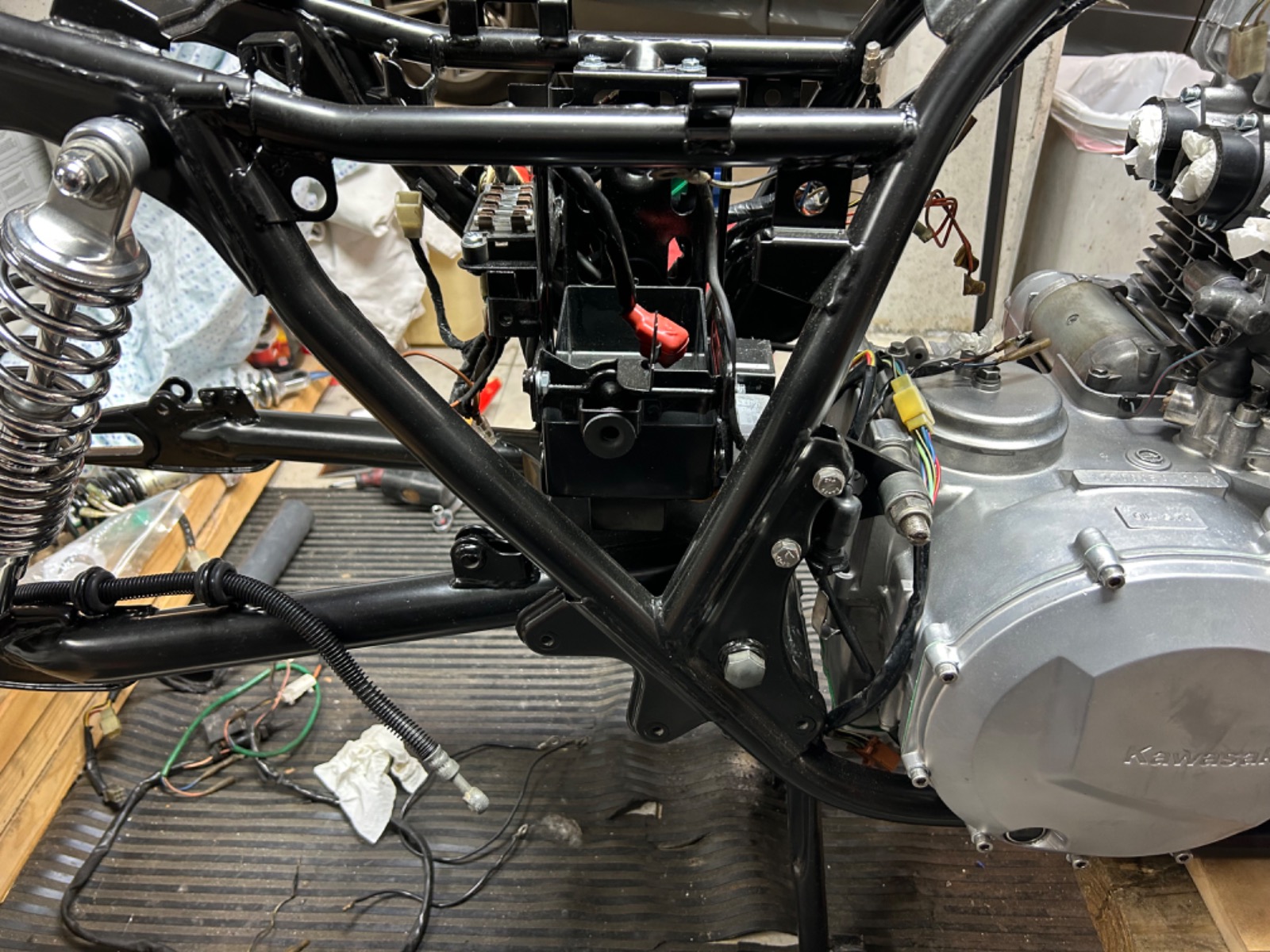

I have no idea how to “arrange” the cables and connectors so they look tidy and not a mess; which they do now. Could someone post a pic of how the cables are arranged? I’ve been searching the forum, but did not find anything.
440221045[
attachment=169980]IMG_2888.jpeg[/attachment]
I also have a couple of grounds I have no idea where to attach… electrics is definitely NOT my thing

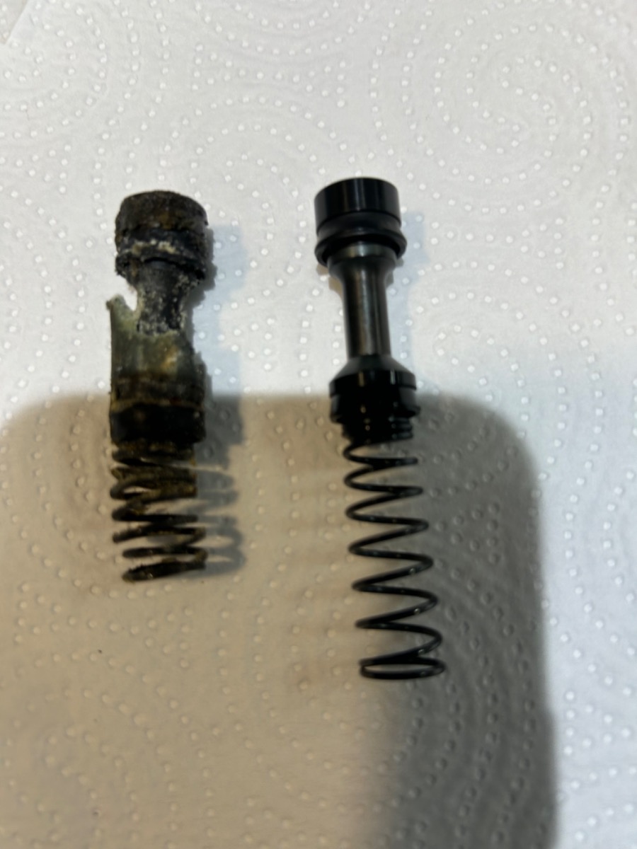

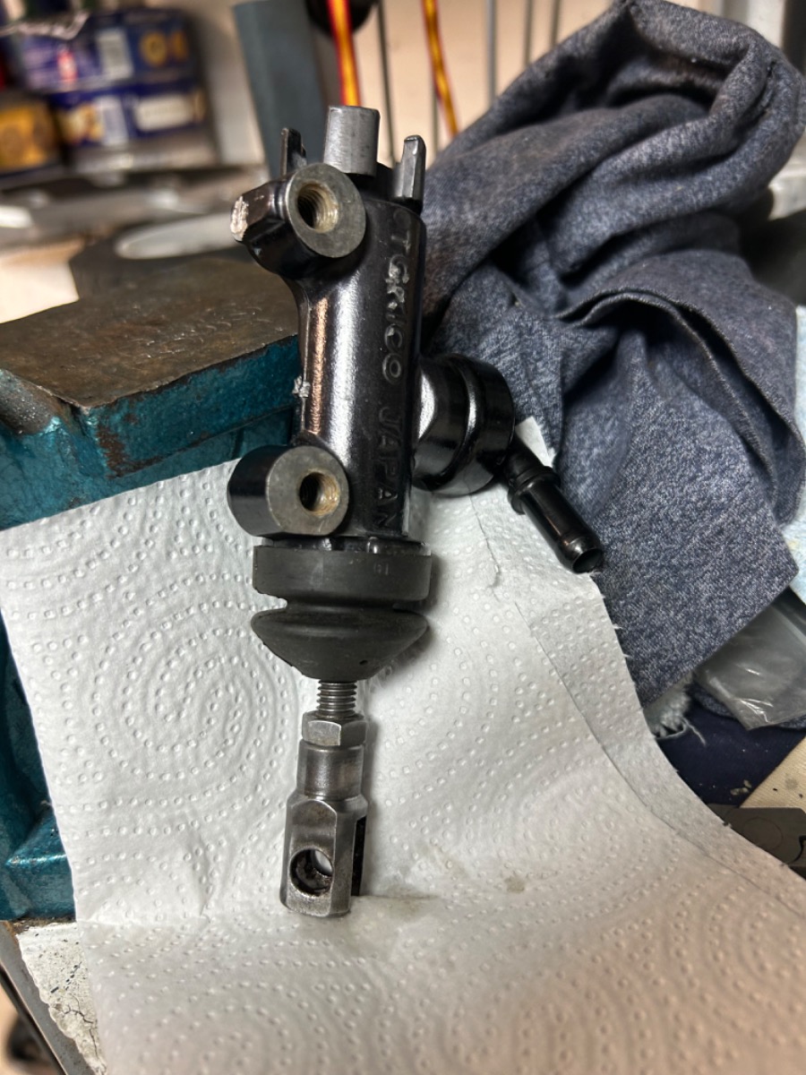

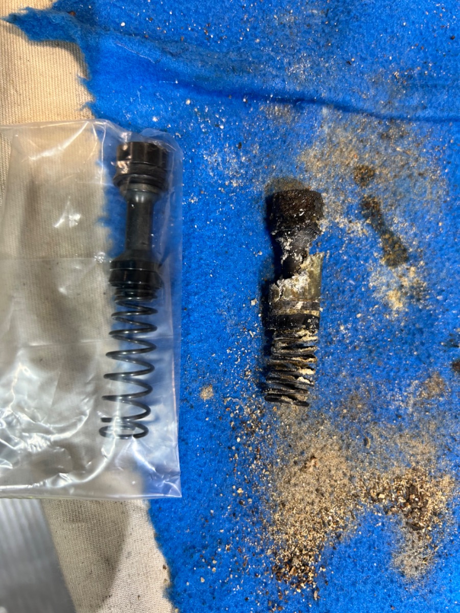

I forgot to mention I also redid both brake pumps. Amazing to find fossilized brake fluid on tha back pump….
19 May 2024 14:15 - 19 May 2024 14:54
Wheels look great! im member in the non electrical club too ,but i know that the ground straps is usual connected one at the backside of egine and to the battery and one to the starter engine and to the starter soienoid negative.
19 May 2024 14:44
I think I am looking at a future BOTM here, those dark days of neglect and abuse are long behind her now
