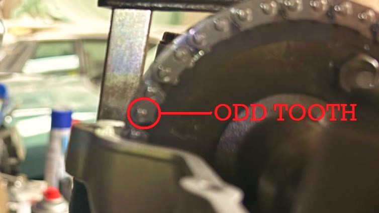

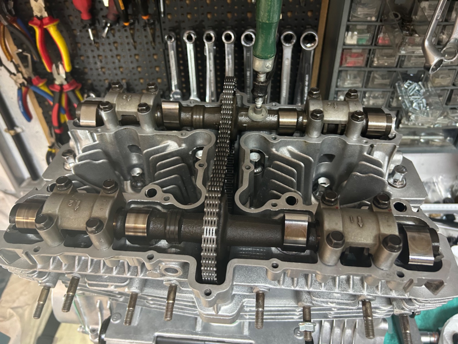

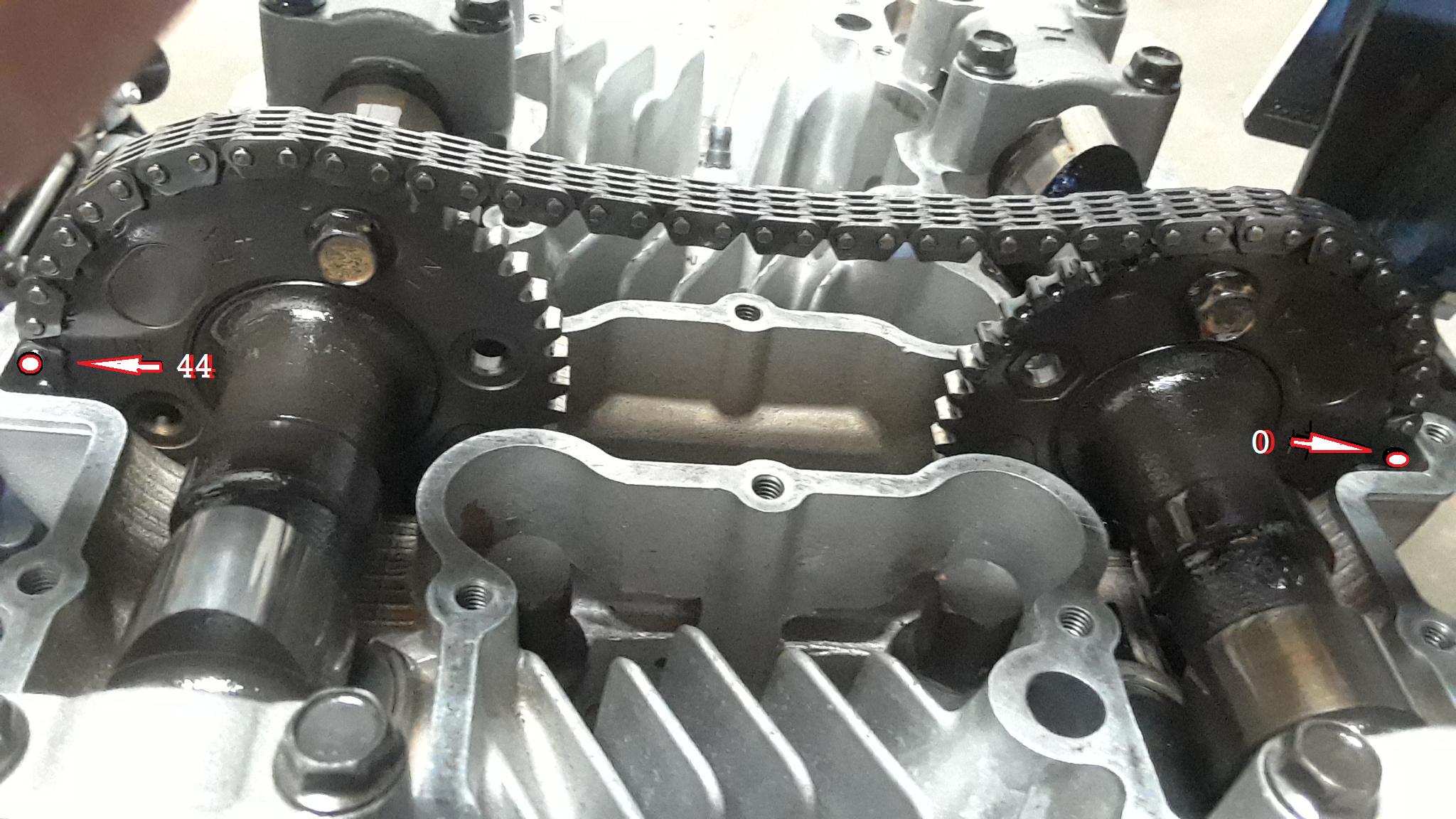

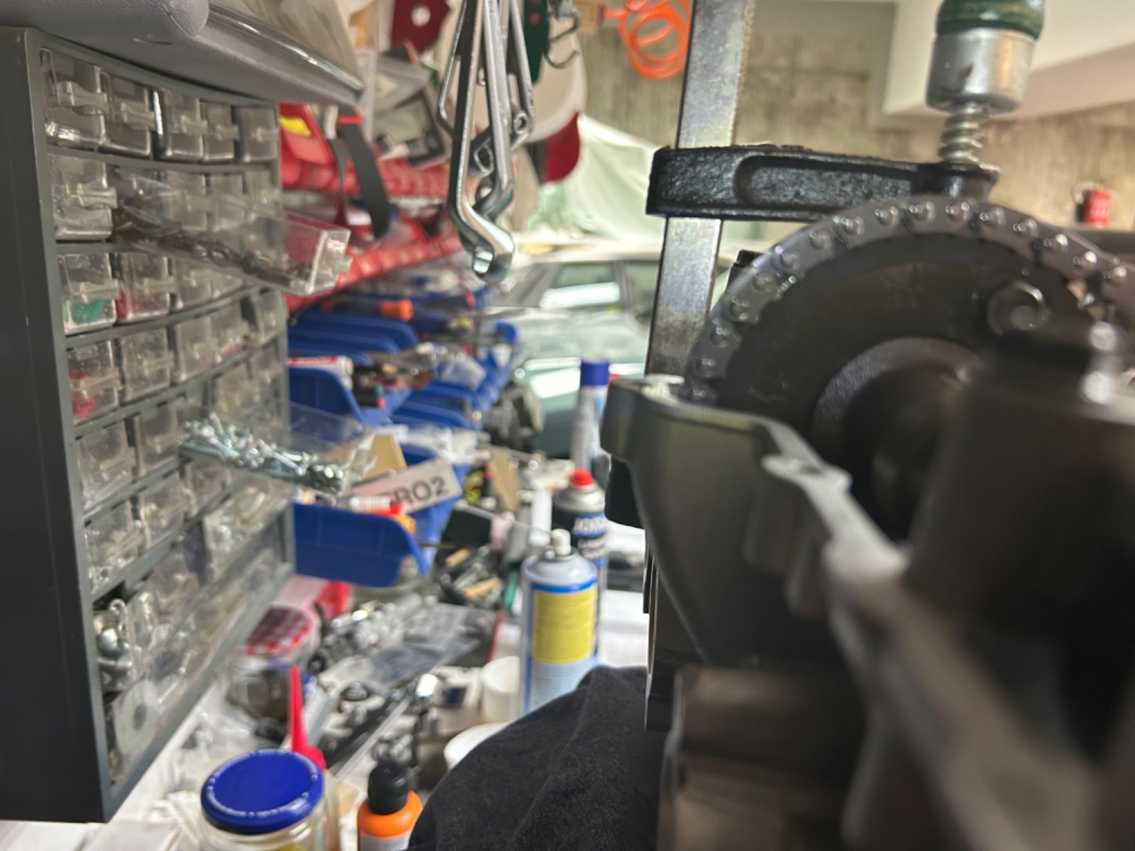

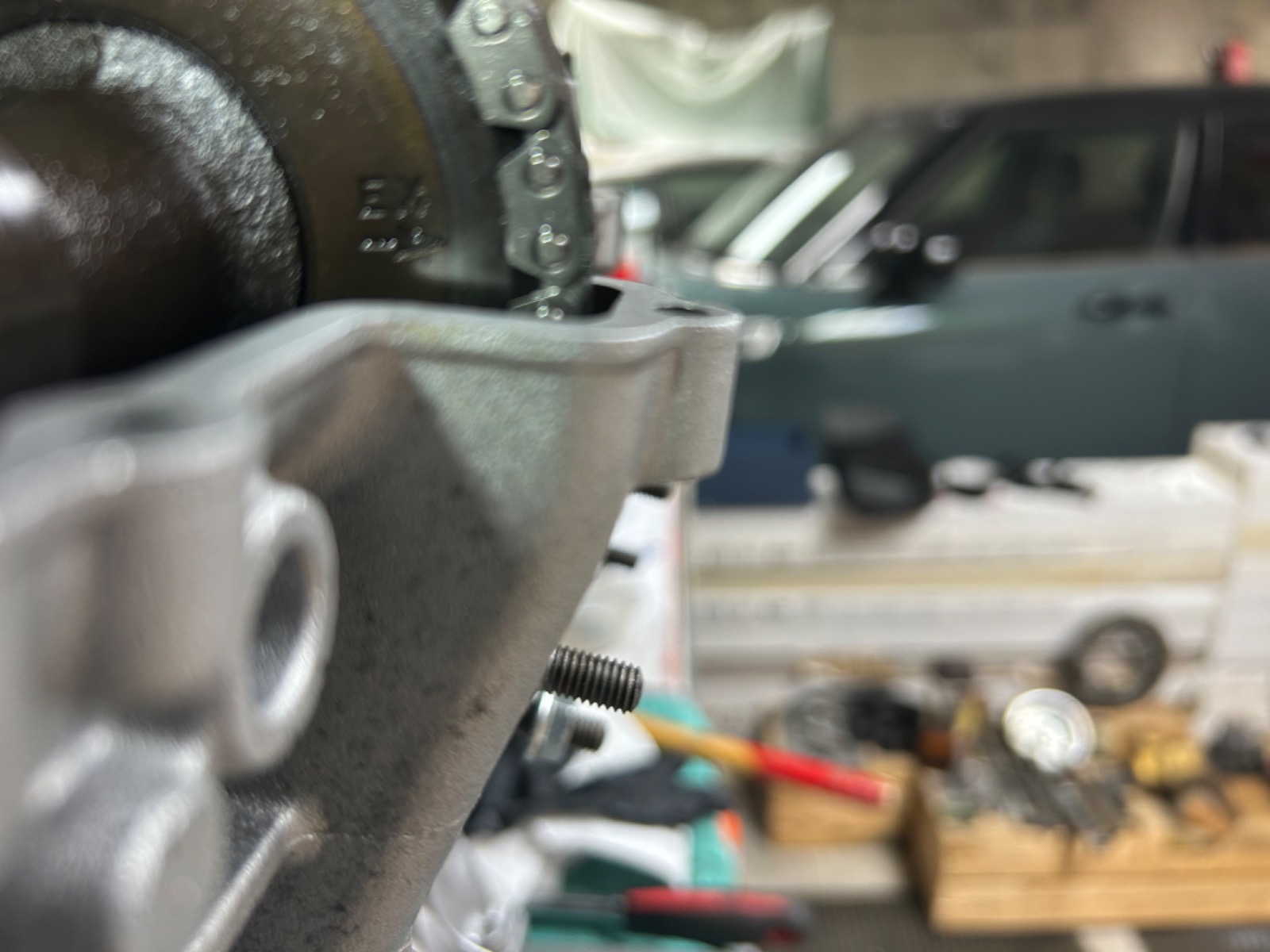

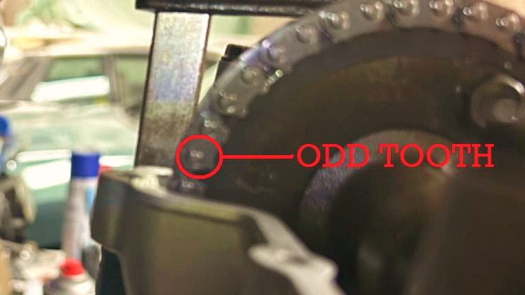

So… following all the advice; camshafts want in really well, being held down with a clamp. I did it differently this time, and I got the camshaft caps for the exhaust side in place before putting the intake camshaft in place.
So now I have both camshafts in place, two lined arrows and a 44 pin count from arrow to arrow.
Will follow advice and torque them down to a lot less that in the manual, and get the cam cover on and then the tensioner, rather than as the manual says.
looking good! Some pics for reference

23 Mar 2024 13:47Excessive chain slack between the cams?.
Doesn't hurt to triple check
1982 KZ1100-A2 (1170cc sleeper 🫣)
The following user(s) said Thank You: cartal

Chain is brand new, kawa original. Will double check, though

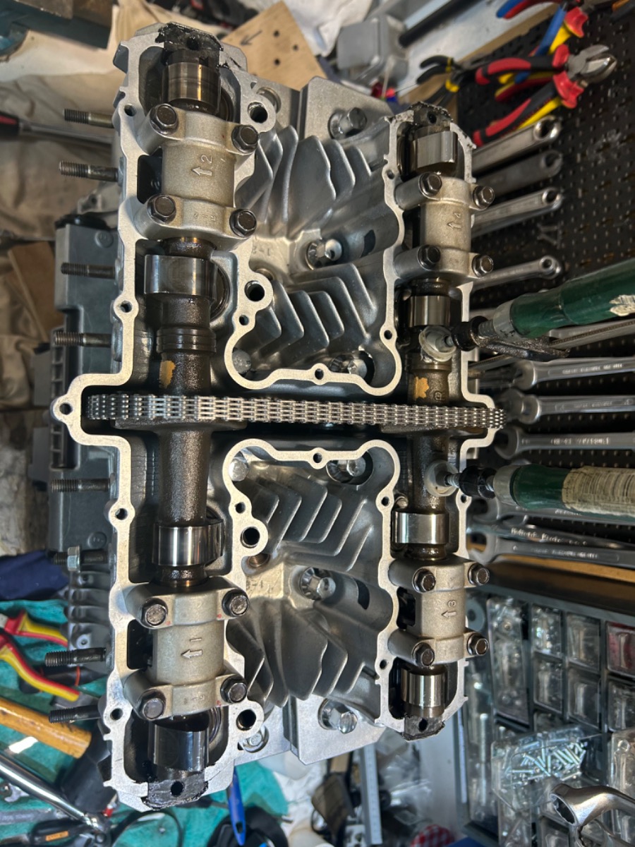

Looks good nice work.One thing ... i might be wrong, but i think the camcaps on the intake is switched ?
The following user(s) said Thank You: daveo, cartal, howardhb
- zed1015
- Posts: 3281
- Thanks: 1975
Re: Piston Hole Kz1000LTD 1982
23 Mar 2024 15:44 - 23 Mar 2024 15:46Looks good nice work.One thing ... i might be wrong, but i think the camcaps on the intake is switched ?
Yes! You are correct.
Well spotted.
3 and 4 need swapping back otherwise the cam endfloat won't be controlled.
Last edit: 23 Mar 2024 15:46 by zed1015.
The following user(s) said Thank You: daveo, SWest, cartal

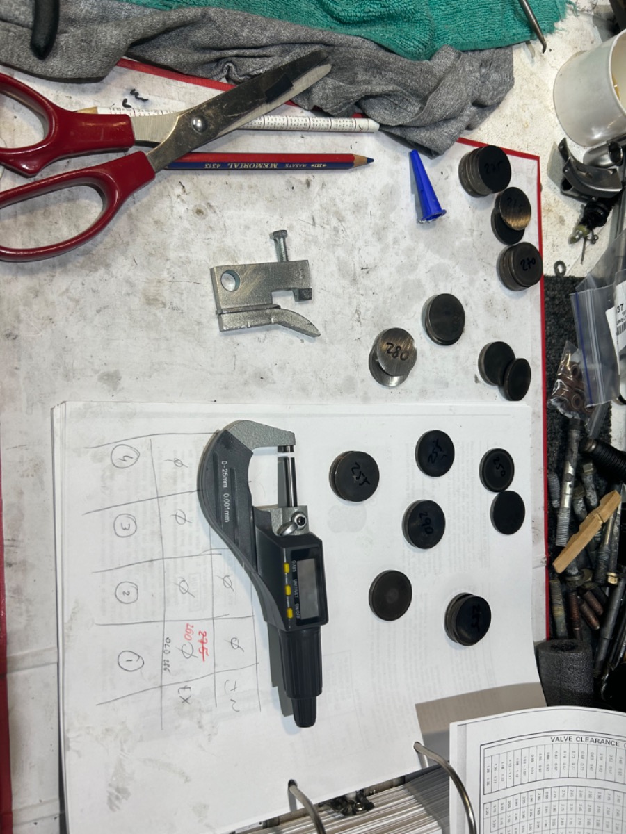

Wow! That was a close call. I must have misplaced them in any of the xx times I took them off. Thank you so much guys!

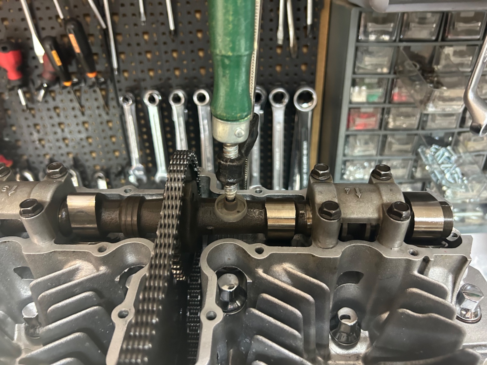

i had actually not read the thread and went along with adjusting the valves.

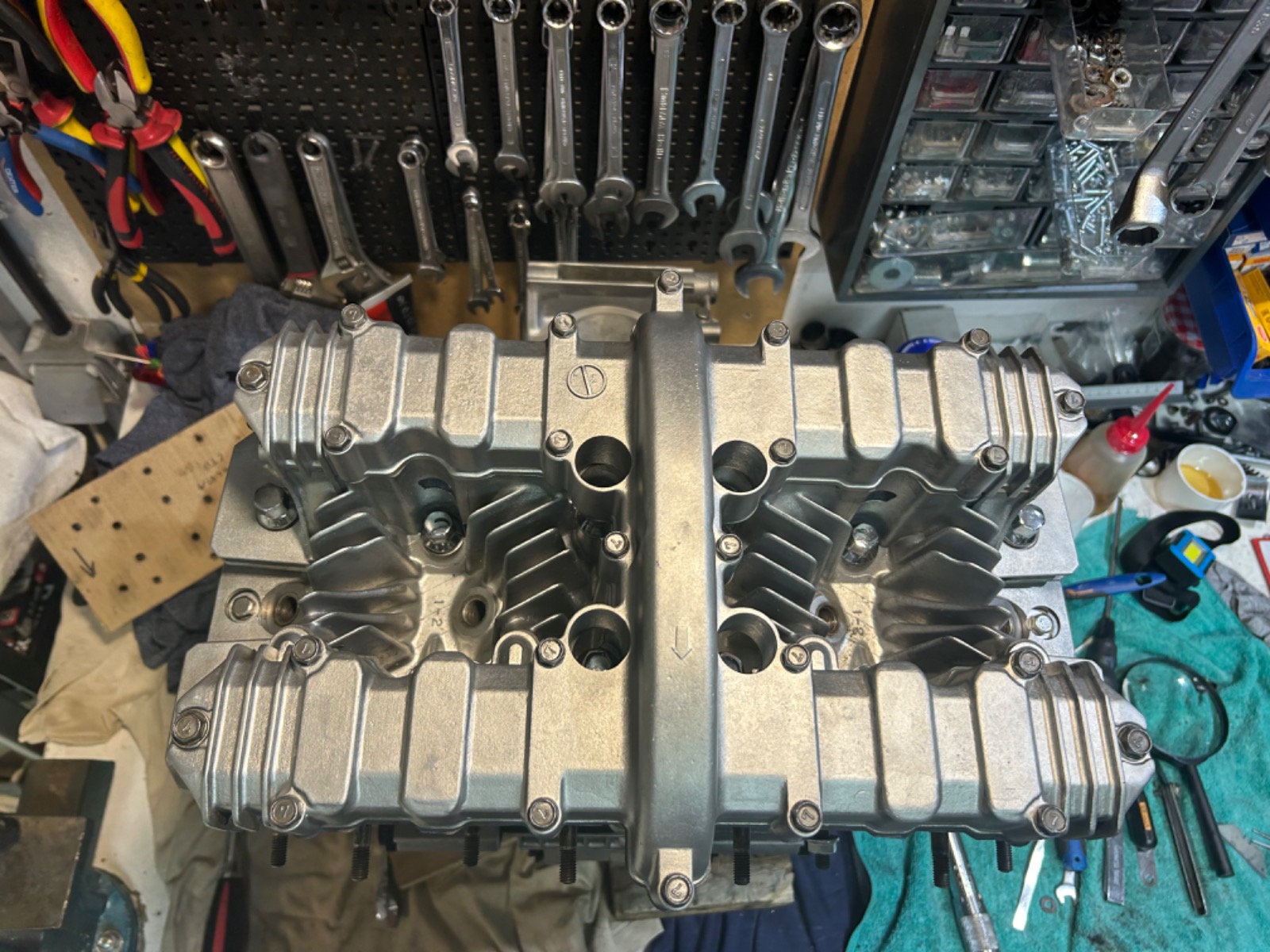

triple checked the timing and all seems ok to me. Chain is really taught now the tensioner is on.
opened the cover and held the camshaft in place with clamps; and swapped the camshaft caps.
valve adjustment is done, all of them close to 0,15.
ready to move on to the frame!
some pics again

24 Mar 2024 02:28I hope you backed off the tensioner before refitting the cover .Chain is really taught now the tensioner is on.
The following user(s) said Thank You: daveo, SWest, cartal, Wookie58
- cartal
- Posts: 262
- Thanks: 129
24 Mar 2024 04:41
No I didn’t….
What is your advice on what to do.
Should I take it off and back off the tensor before refitting it?

YES!
