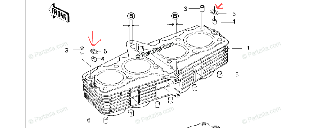

3. The manual keeps talking about O rings along with the head gasket. Where/what are the O rings?? Are we talking about nut washers here?

3. Part number 92055-1147. There are two ovoid rings underneath the engine head that go around two oil metering blocks; I suggest getting replacements and using a light coat of Yamabond or similar to make sure they keep the oil in.
