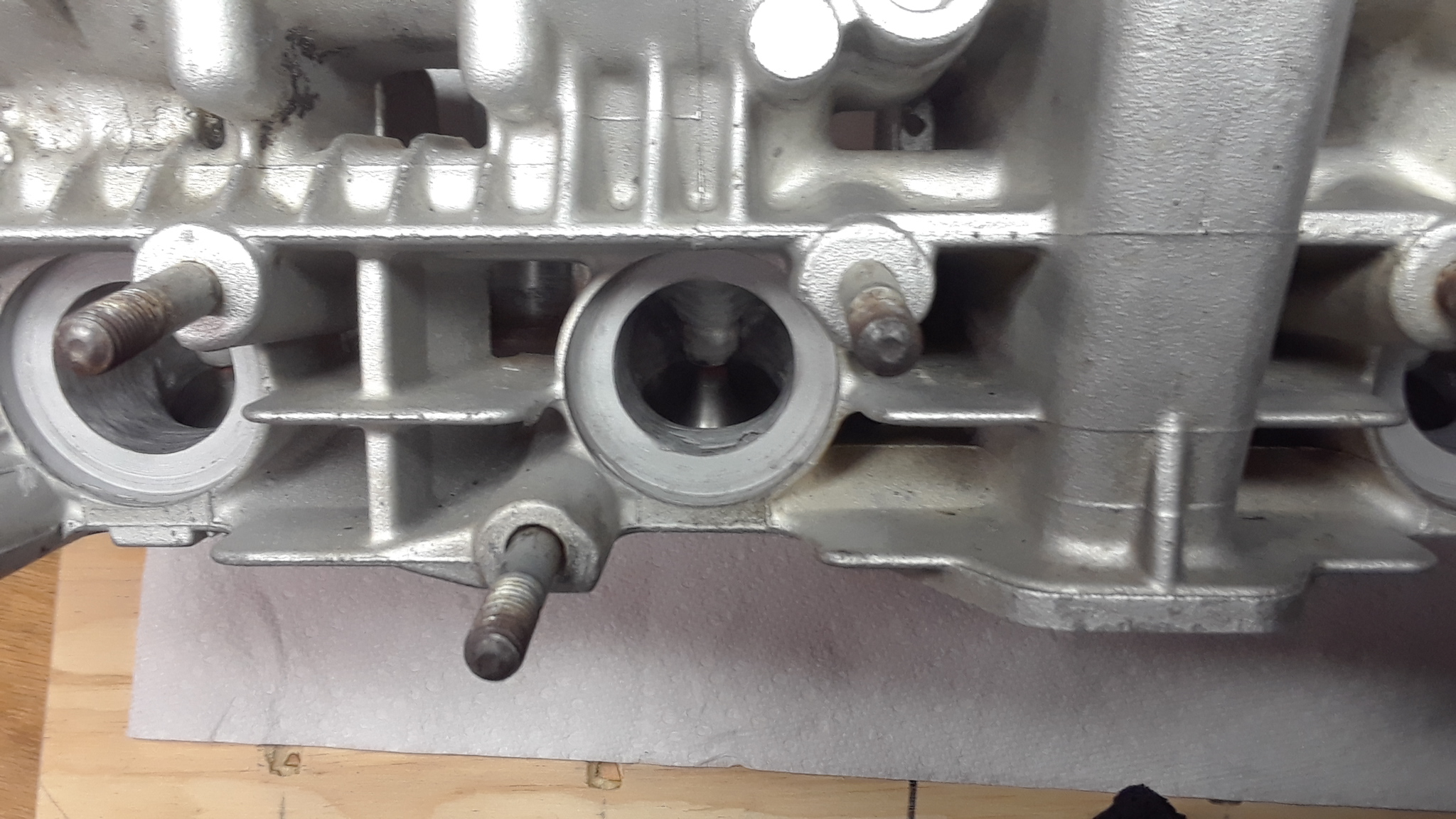

That head looks to be a real beauty!  Those intake ports look massive!  Don't like the look of those exhaust studs though.  It's not the look per se, it's the corrosion.  Best use a liberal dose of anti seize on those threads.
For the price it seems like a really nice job was done on the porting and valve job, and the guy was easy to work with.  He claims thirty years of experience, which is evident.  The new  power sensation is undeniable.
It feels like the engine is leading the transmission for a change, and the gears shift with a simple click.  Can't recall that happenening much with consistency before.
The exhaust fasteners are stainless flange nuts.  They came off easily with little effort.  I applied a coat of engine oil on the stud threads before reinstalling the nuts.

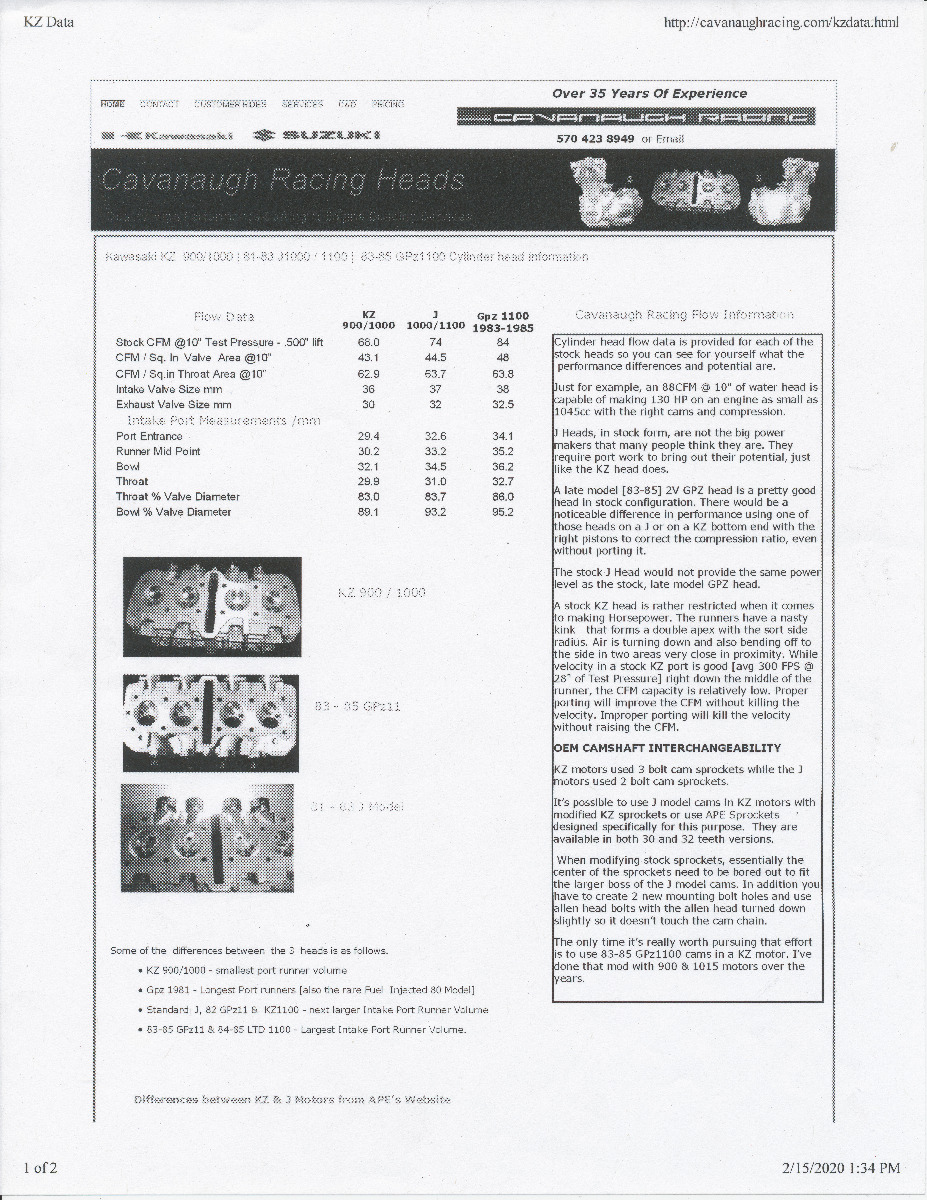

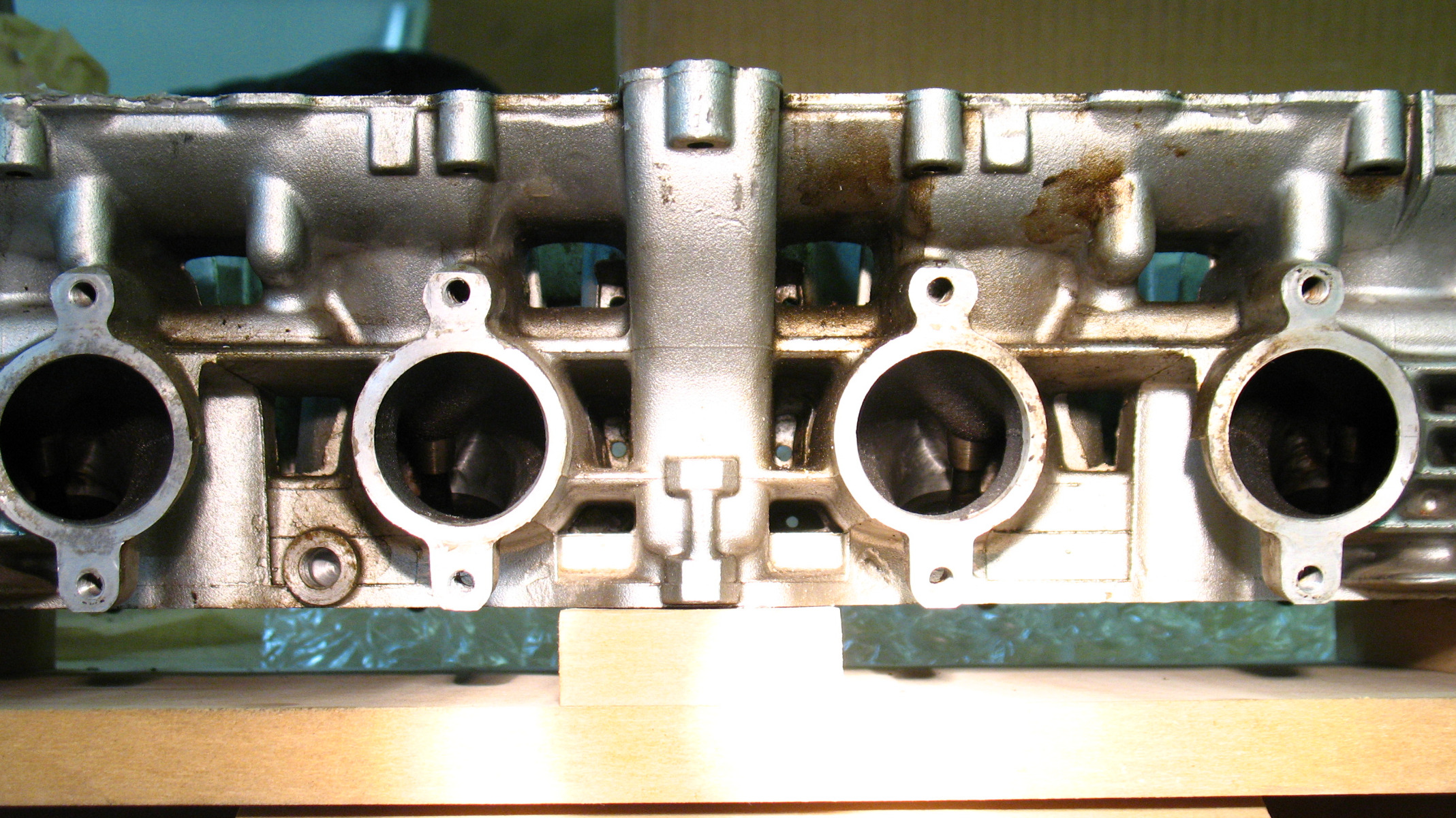

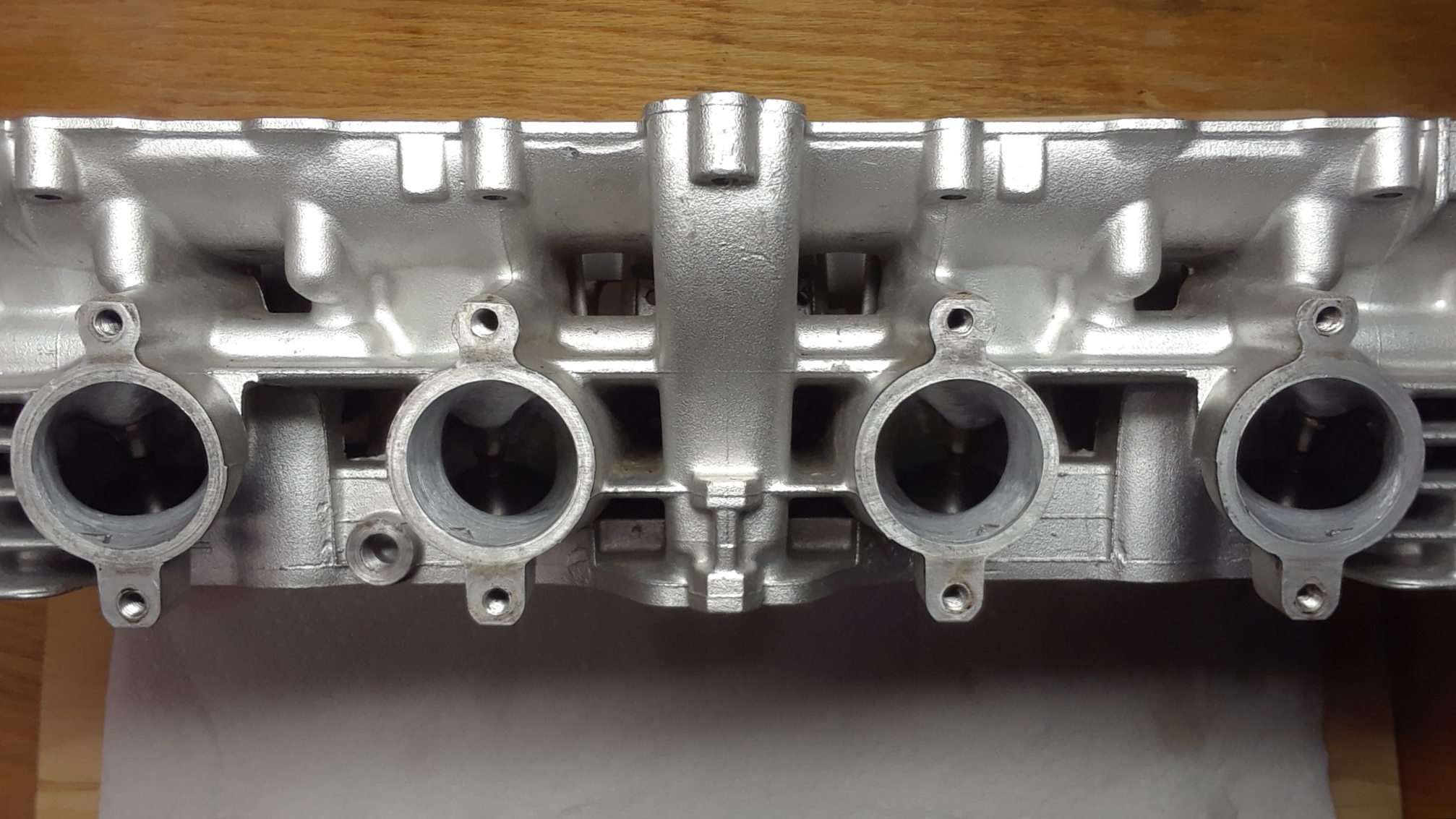

Intake runners were opened up some and smoothed out to meet the stock 34mm port openings.  The exhaust side received the same treatment.
Image below when purchased in 2015:
Images (2) below 11/27/2021:
Relevant head information per Cavanaugh Racing below:
