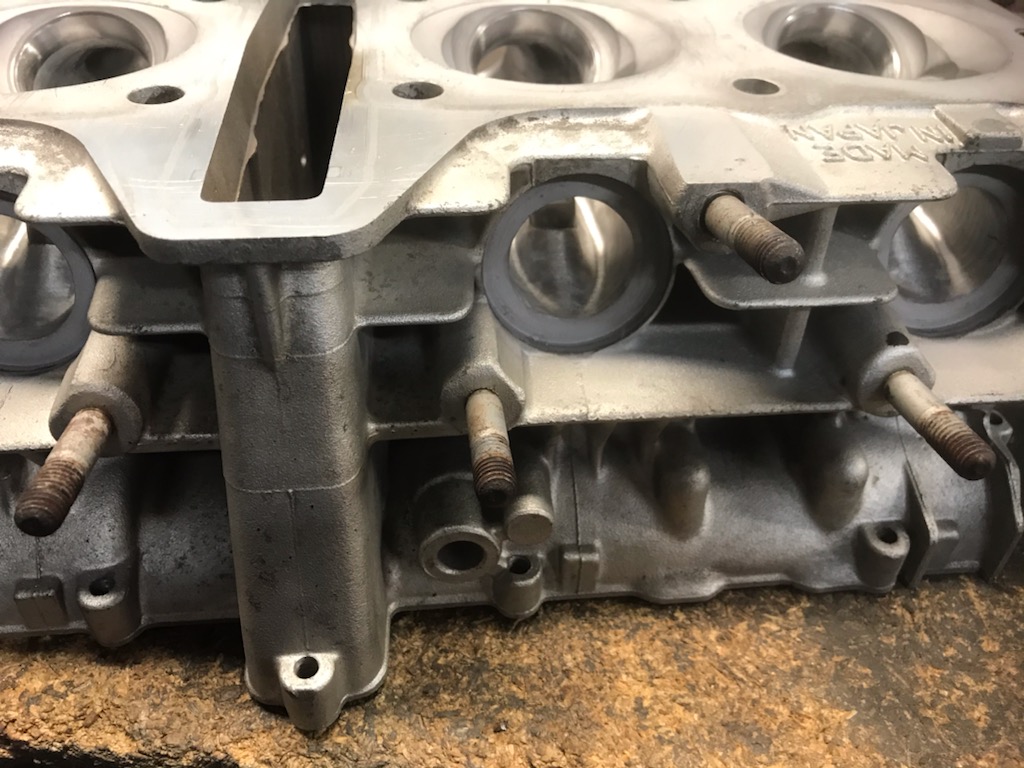

I don't know how much it matters but I usually do some light pocket porting to smooth out any big chunkies.

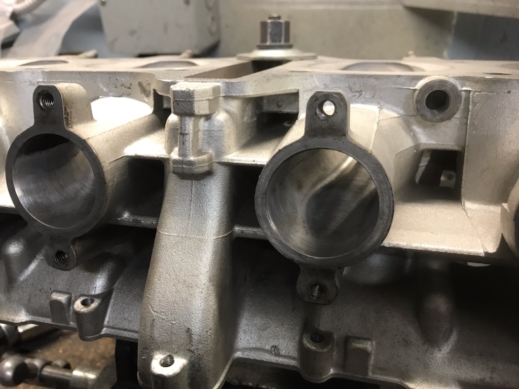

03 Nov 2021 17:18 - 03 Nov 2021 17:23
The light porting I did made a BIG difference.
Took out the casting marks, smoothed the shelves made by the valve seats and made the intakes match the manifolds. Lots of slag in and around the valve guides. Left a rough finish for better fuel mixing. Exposed a weak clutch in second gear at WOT. The Z1 head wasn't half as bad as the KZ 1000 head I have on the bike now. RIDING THE PISS OUT OF IT.

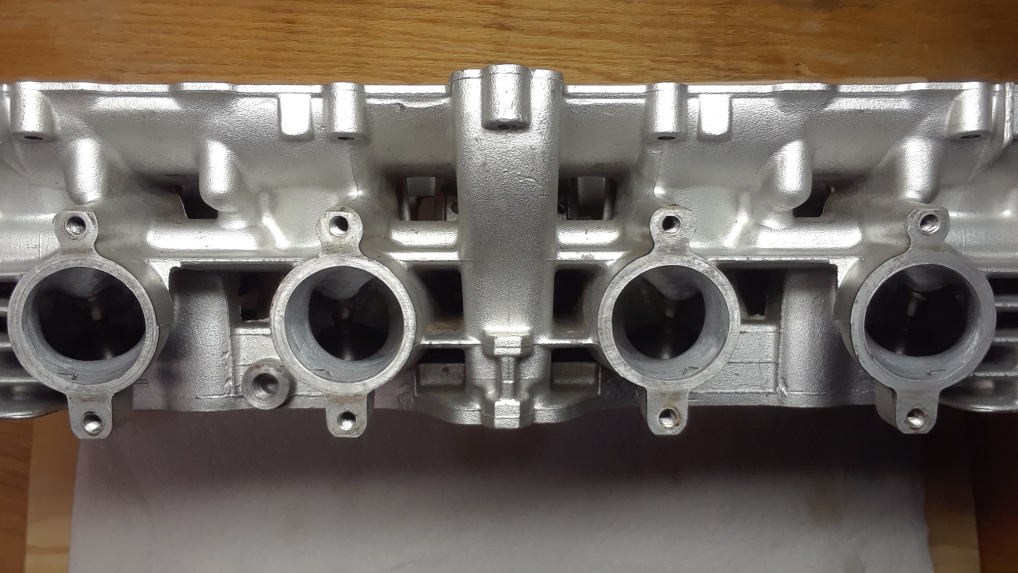

On top of a Serdi valve job, we're having a mild port job done, and the intake valves will be back cut to increase low-lift flow.
Not sure what to expect when she's all back together, though I anticipate some sort of a pleasant surprise.

Lashed the valves and sync'd the carbs twice after startup. I assume that fresh ground valves and seats need to get worked in as the engine runs, since several shims needed to be changed already. Will probably need further lash checks and adjustments until the valves become fully seated, however long that takes.
Head nuts re-torqued, and may do again before Winter sit-time in the barn.
Great suggestion to port the head. It is the cherry on top!
