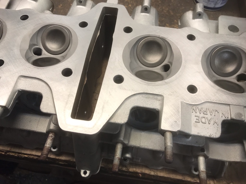

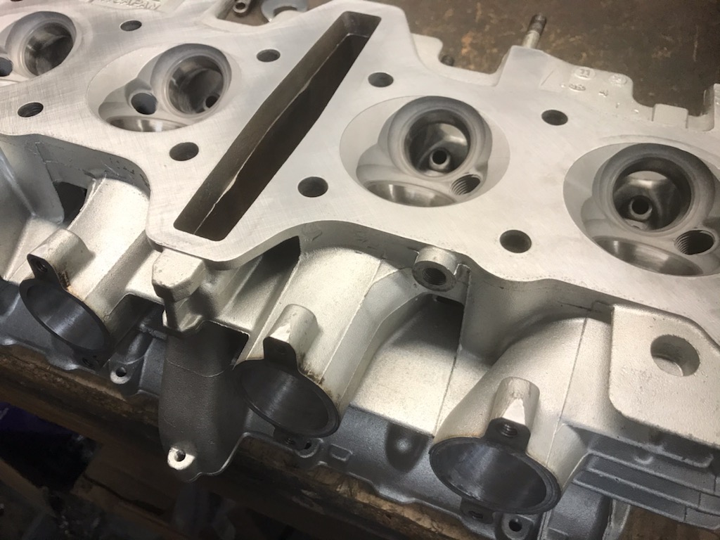

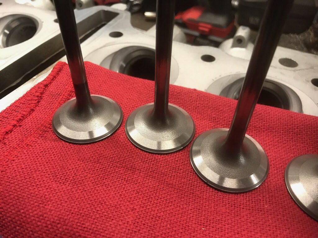

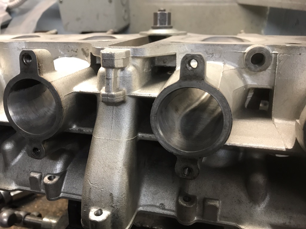

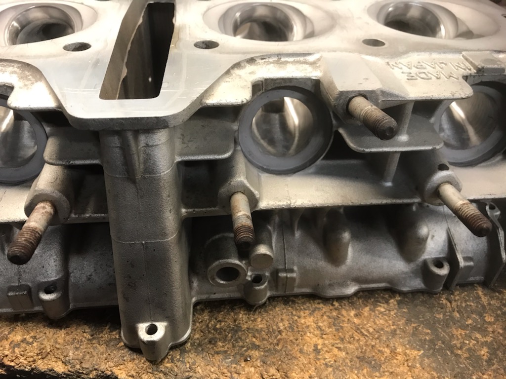

21 Nov 2021 16:45 - 21 Nov 2021 21:02
1982 KZ1100-A2/1170 sleeper 😀

Re: 84 ZN1100 Cylinder Head Upgrade?
21 Nov 2021 19:10
Very nice.
