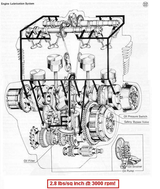

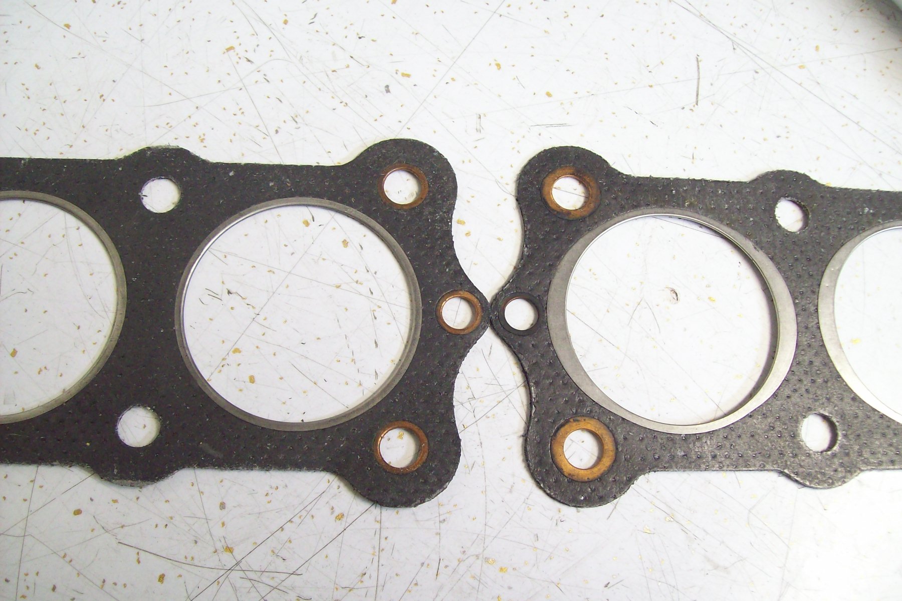

Even if the PO installed the head gaskets up side down, it would not block oil flow to the top end. I think the term is the head gaskets are symmetrical.
Any use of that blue or red RTV silicone on base or head gaskets is a sure sign of a rank amatuer alley mechanic in my book. In my whole life I have only seen two Kz900/1000 motors where the excessive use of RTV blocked oil flow to the top end. You cannot believe how much RTV you have to put on the base and/or head gasket to stop the flow of oil to the head. The first thing that goes if there is no oil flow to the head is the cam bearings. They are a plain bearing and the minute they lose oil flow, they gaul!!!! Pull the cam caps and see if the cam bearings are waxed. Then you know there is no type of oil flow to head.
O.E.M. head gaskets. Left one is up side down. Right one is the correct way they are installed on the motor.

If there was an oil shortage your cams would be toast , blued, blackened and scored within a few miles of riding which they obviously aren't.
When stood, oil drains down past the buckets and back to the sump via drillings linking the bucket bores and the camchain tunnel.
It usually only pools and sits mainly around cylinders 1 and 2's buckets when left parked on the side stand as the oil can't run uphill to drain.
Normal oil pressure is around 3psi and down to almost zero when hot.
It's the oil volume that counts on these engines not the pressure.

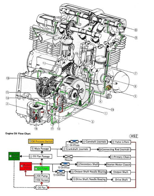

The oil goes to the mains and tranny first at the same time it's pumped up the galleys at the back of the barrels then across the head. The exhaust cams get it last. If you have oil there there is enough for the intake cams and valve train.
