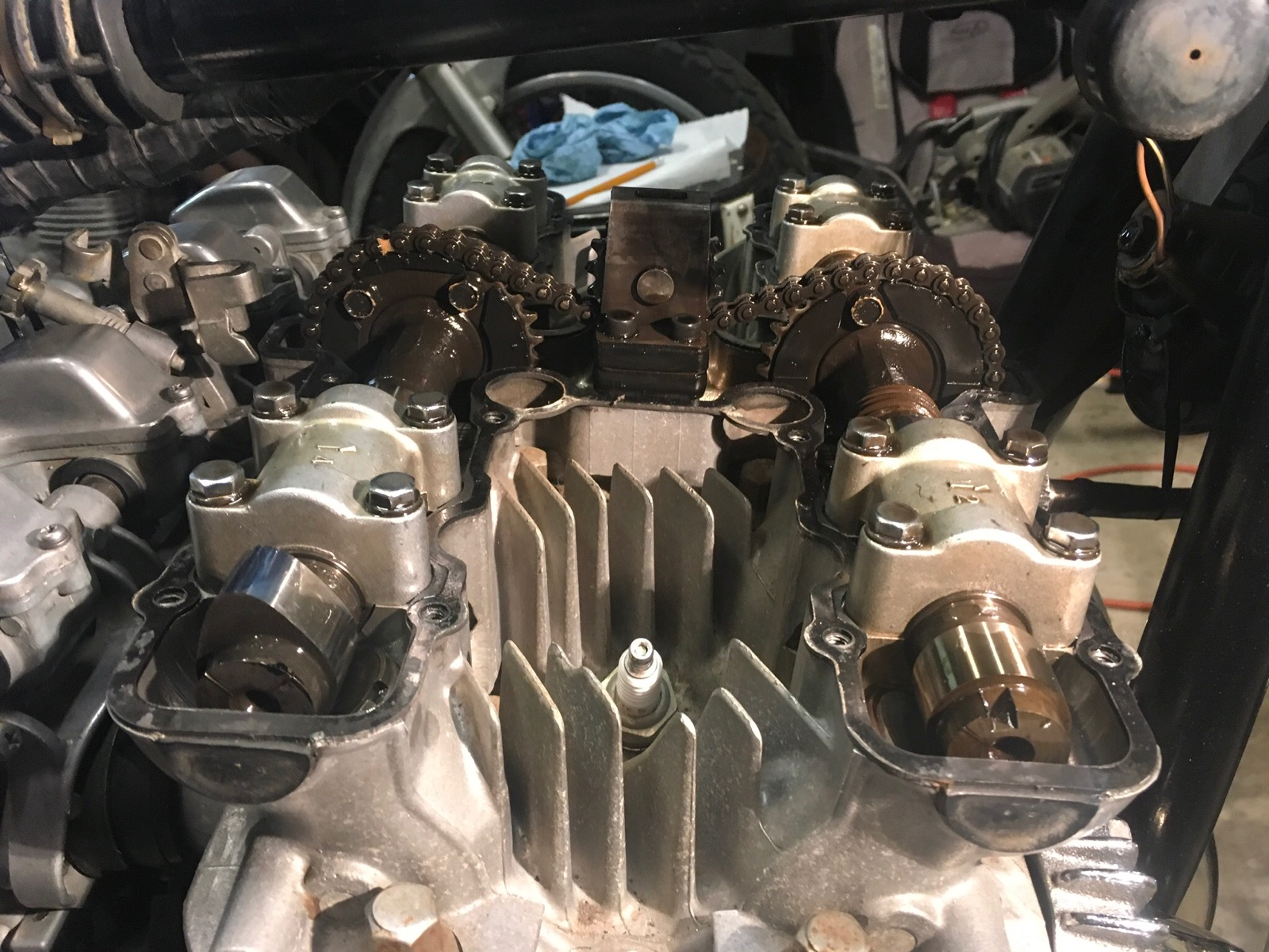

Not specifically taken to show oil amount but this was when I was shimming my valves this past spring. You can see oil covering the cams, chains, and idler gears.
The following user(s) said Thank You: SWest, Robb2018
Re: Cam don't seem to be getting enough oil
12 Aug 2021 15:06
That's normal.
