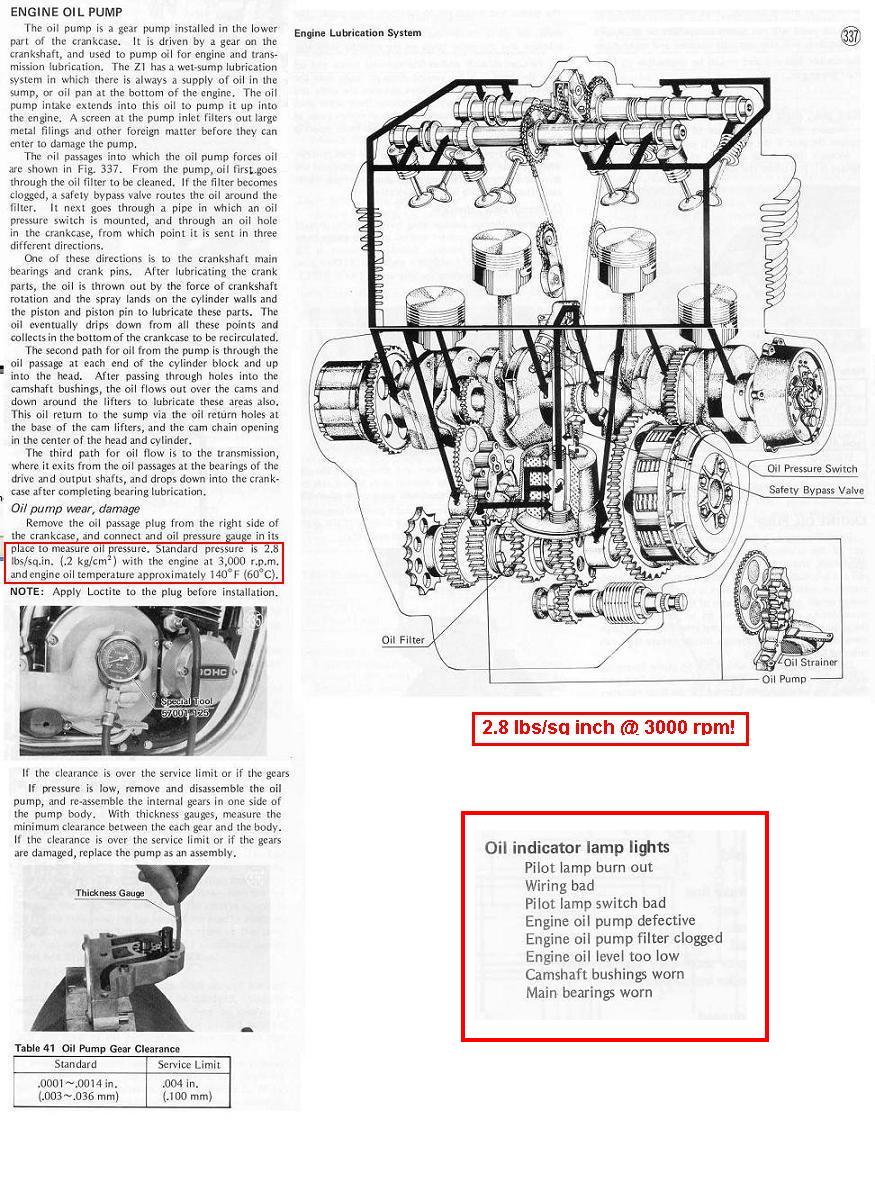

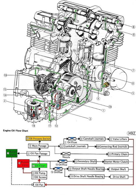

Re: Kz1000 Running Way Too Hot
26 Jun 2011 10:20 - 02 Jul 2011 17:41lexor wrote: ...what's the best way to check the oil cooler?
One way to test for circulation through the cooler ---
Detach the hose from cooler exit nipple, and attach a temporary test hose with exit into a catch pan or bucket.
Next, spin the engine over by using the electric starter.
Oil should gush from the test hose, which shows it's passing through the cooler.
But if not, the next test would be to detach the hose from cooler input nipple, and allow the hose to exit into a catch pan or bucket.
Oil should gush from the hose, which shows it's reaching the cooler.
Reattach cooler lines and top up the crankcase oil before re-starting the engine.

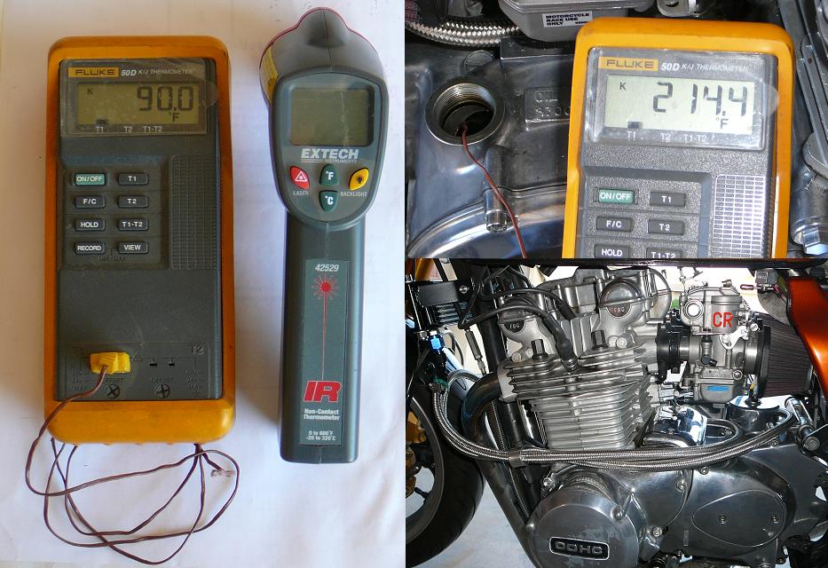

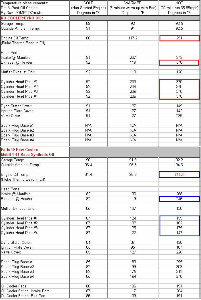

26 Jun 2011 11:33
1976 KZ900-A4
MTC 1075cc.
Head: P&P via Larry Cavanaugh
ZX636 suspension
MIKUNI, RS-34'S...
Kerker 4-1, 1.5" comp baffle.
Dyna-S E.I.
Earls 10 row Oil Cooler
Phoenix, Az
MTC 1075cc.
ZX636 suspension
MIKUNI, RS-34'S...
Dyna-S E.I.
Phoenix, Az
