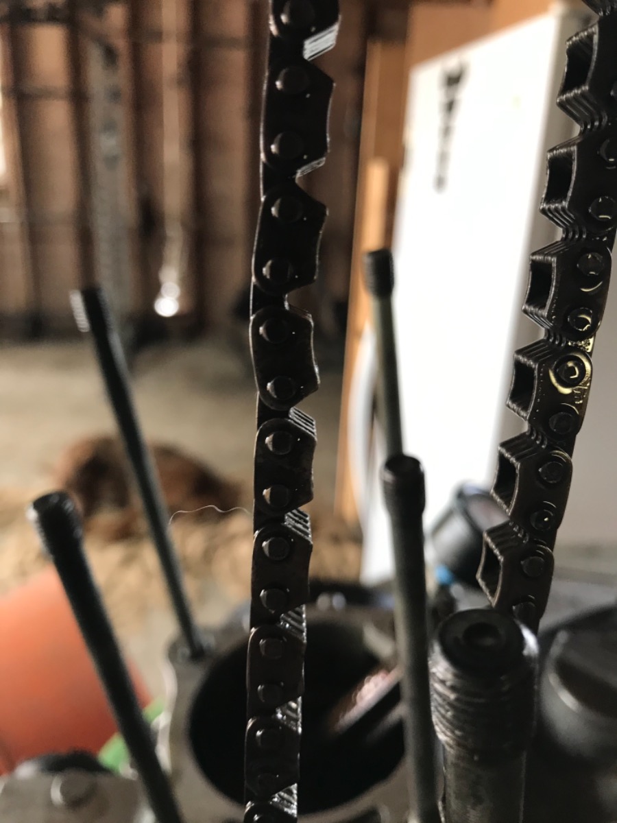

I’ve been reading and watching videos is it a must to pull the clutch basket off is I ain’t pulling out the trans, I plan on just the crank to change the cam chain

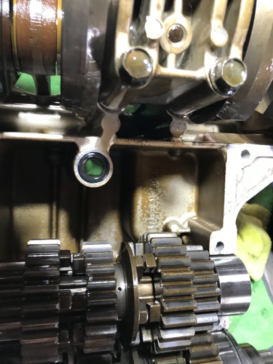

Re: Oh sh%#t monument
25 Mar 2021 08:23
#845488
That’s where it took the tooth off , ain’t seen it yet gonna split the cases closer to when the chain is gonna arrive.
31 Mar 2021 12:38
#845869
Is the oring in the pic the same size as the one on the oil pump?
01 Apr 2021 05:24
#845902
Check the number on Partzilla.  If the same number then the same o ring.

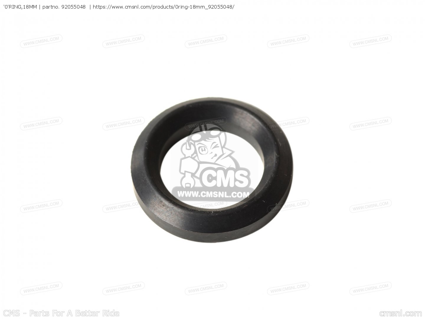

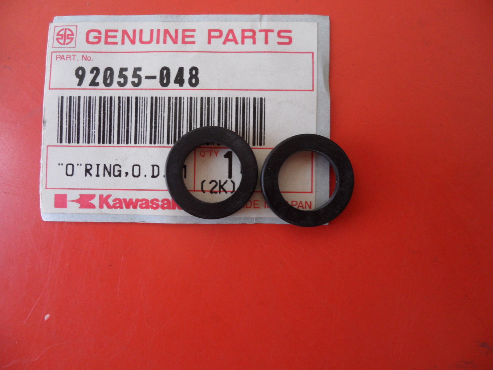

01 Apr 2021 13:03 - 01 Apr 2021 13:25
#845934
Zilla post=845920What bout the big o ring inside the oil pan,it's in between the pan and motor, I think it's the same size as the one for an oil change, can't find a number on it on partzilla
oil transfer port o-ring Kawasaki part#  92055-048
www.cmsnl.com/kawasaki-kz1000p5-police-1...0ring-18mm_92055048/
www.partzilla.com/product/kawasaki/92055-048
the big 91 mm o ring inside the oil pan,between the pan and motor Kawasaki part# 92055-052
breather cover / oil pan / oil filter cover = Kawasaki part# 92055-052, all the same size.
www.partzilla.com/product/kawasaki/92055-052
