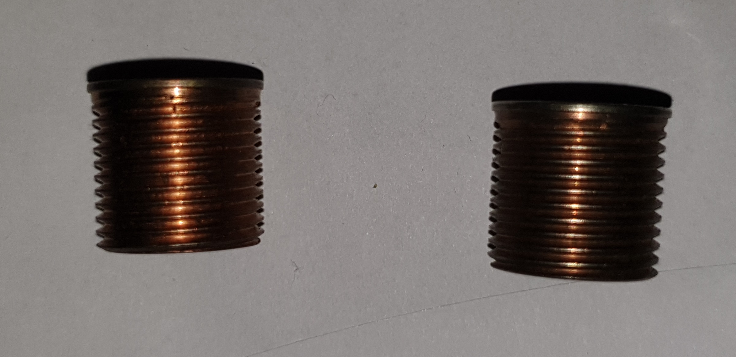

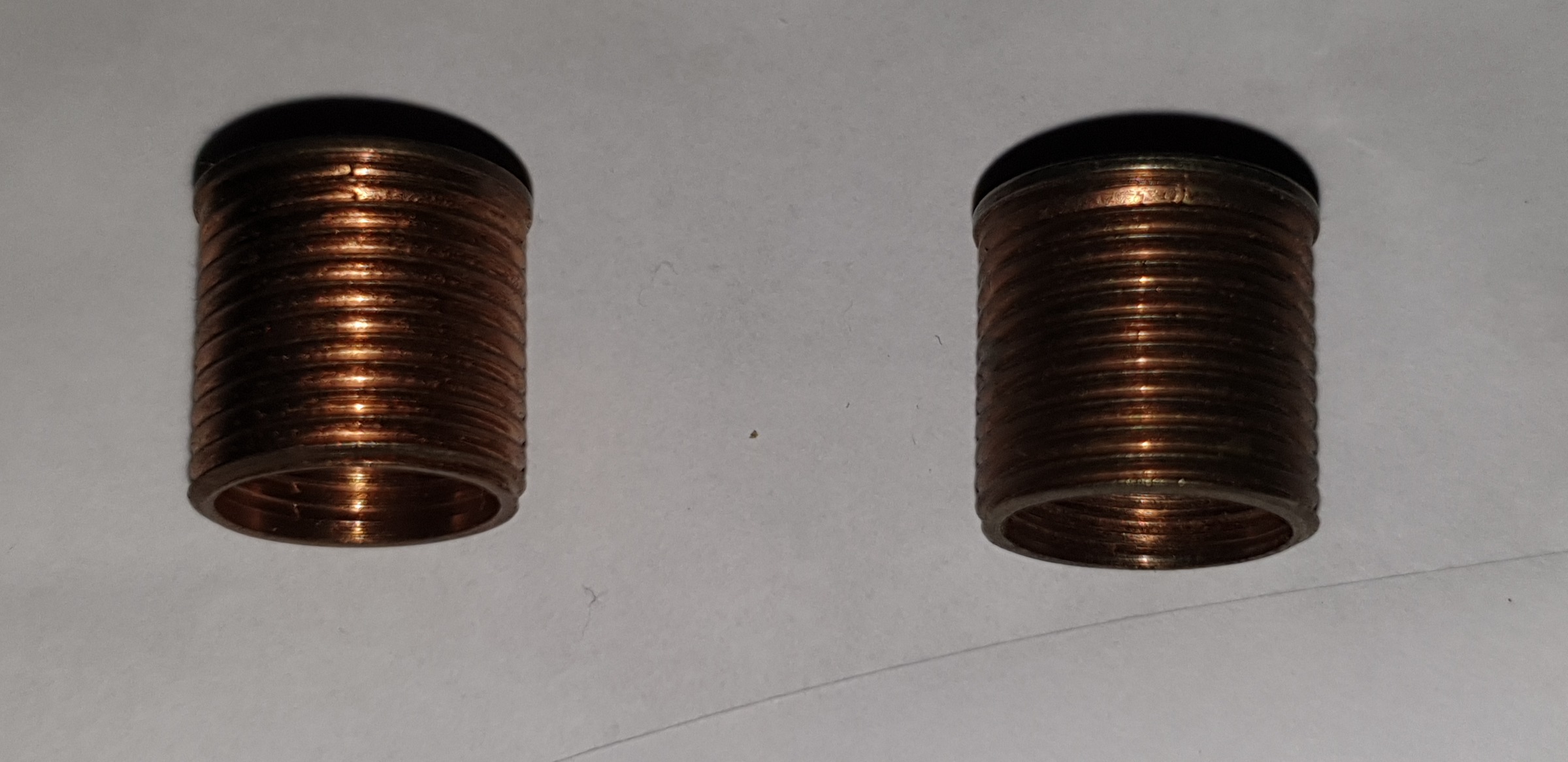

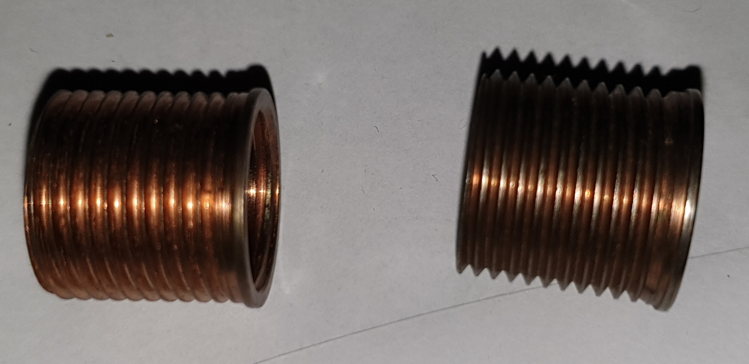

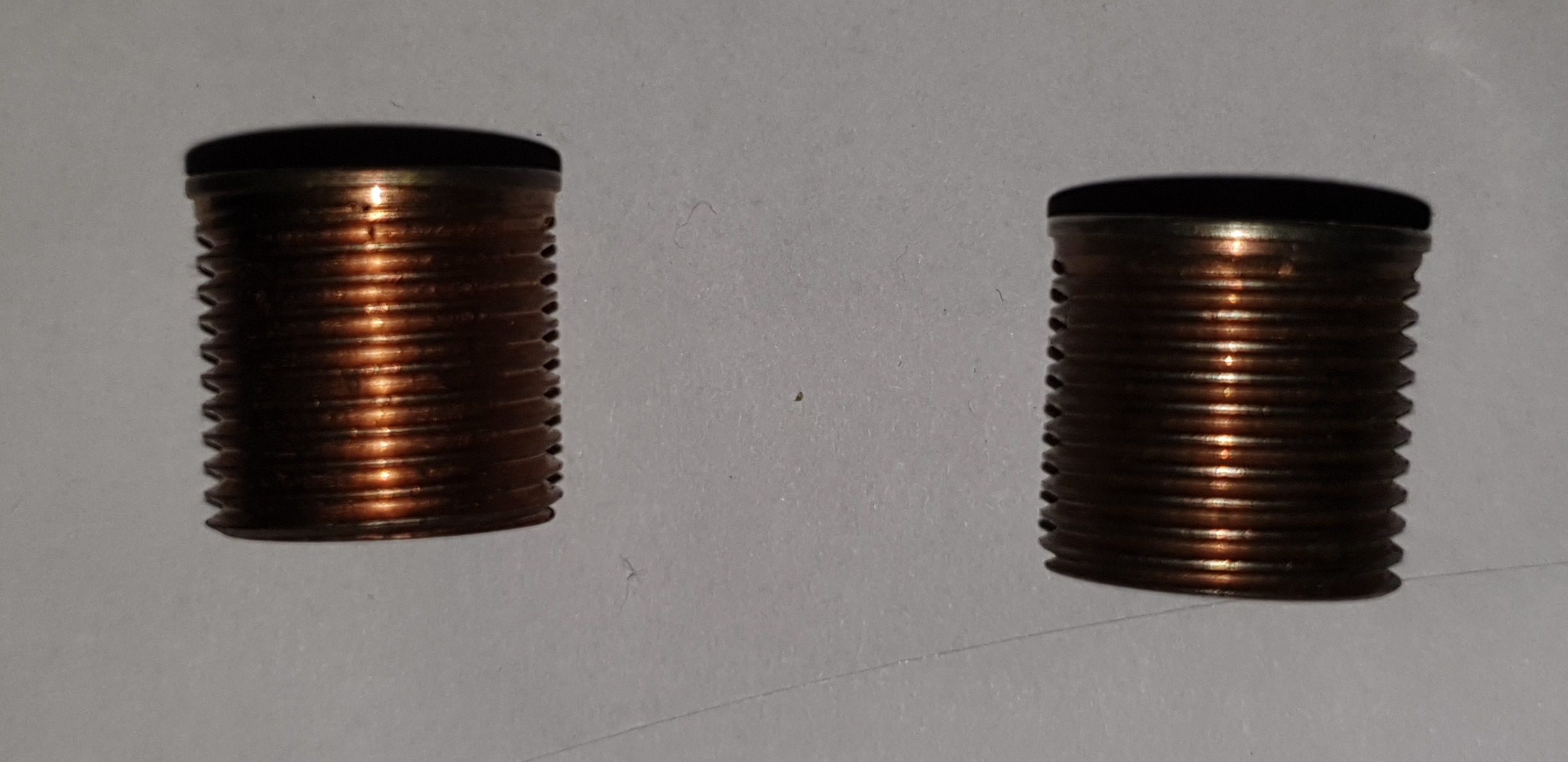

I bought these kit and fixed my threads, it had been working perfect for years.
I think the threads is then stronger then orginal?
eshop.wuerth-industrie.com/Product-categ...1543.cgid/en/US/EUR/

For me, the Würth Time Sert kit is the best for a spark plug thread repair. It´s a little priciey but worth the money you have paid for.
