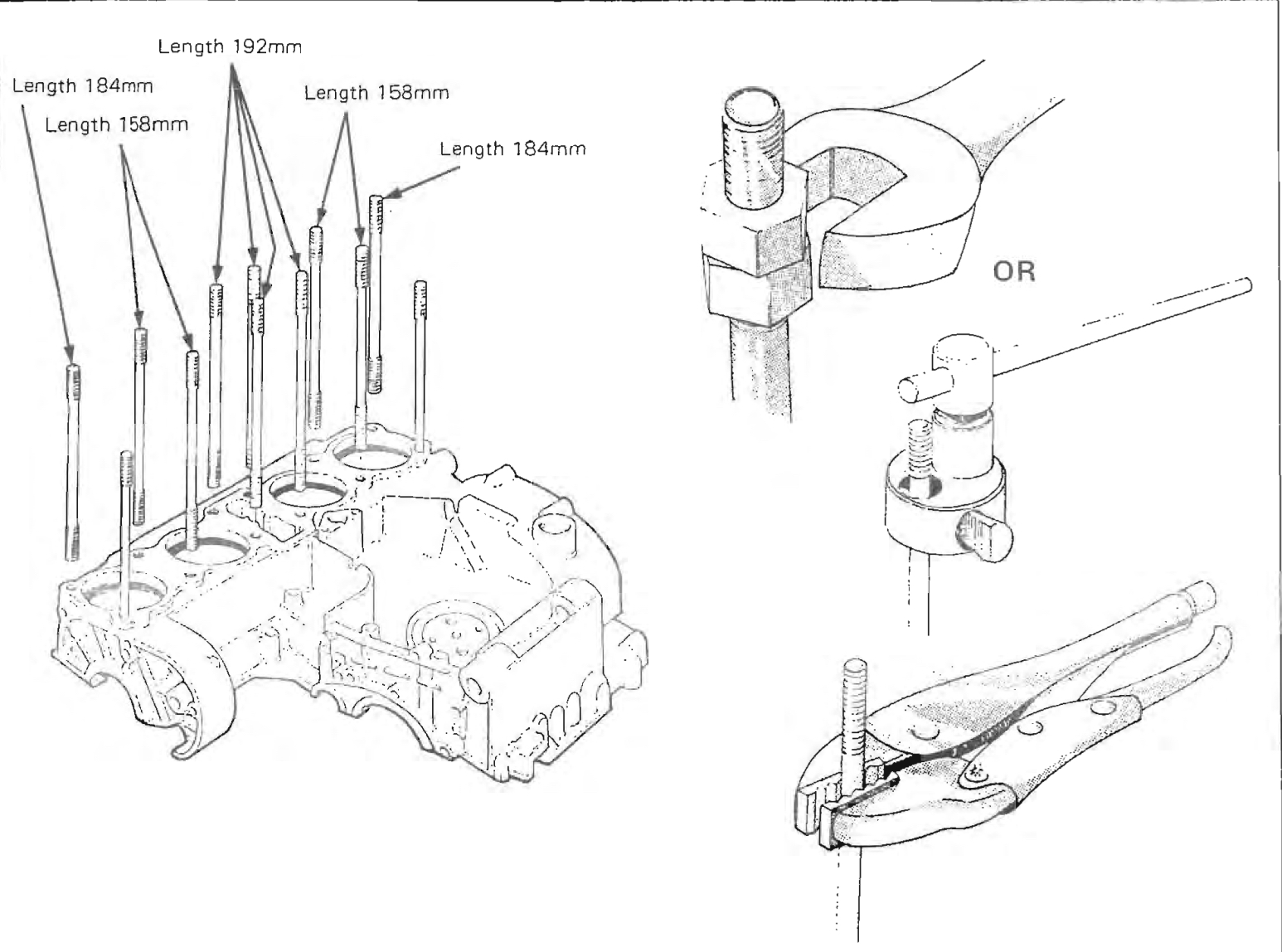

Re: Exhaust stud stuck, no thread left to put two nuts on
24 Nov 2020 09:07
This is a sreen shot of a Z1 service bulletin. Appears vice grips are a factory approved stud removal tool. :woohoo:
