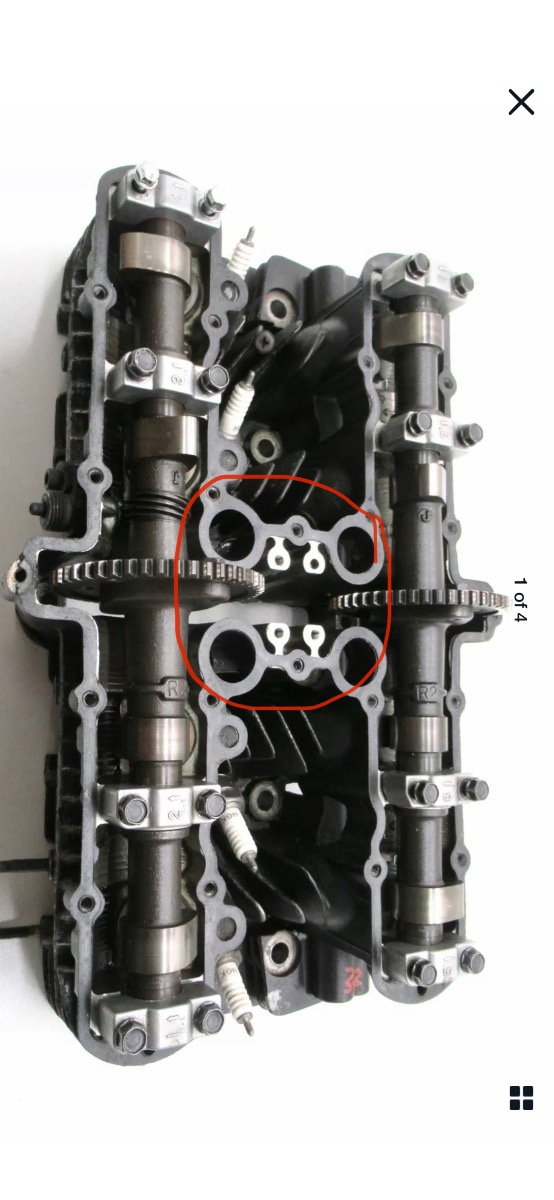

I have a 81 kz650 csr h1. So I over tightened a bolt. Snap! Fucked up the hole when i drilled it out. Might be able to make it work cause its not so bad. Wondering if 80 kz650 ltd cylinder head will work if bought?

Not sure. Some of the 80 models use the hyvo cam chain and some did not. But all of the 81 models did make use of the hyvo cam chain. Offl the top of my head I do not remember if the LTD used this type of cam chain or not. That is the thing I would suggest you look into.

It most likely will. When you have an existing head with everything your options are good. You can just bolt you cams and running gear from your old head into the new - if it runs a different chain type. Then main thing to consider is whether your head has the four holes threaded for the sprocket between the cams - if so - you need to find one that has this as well.
