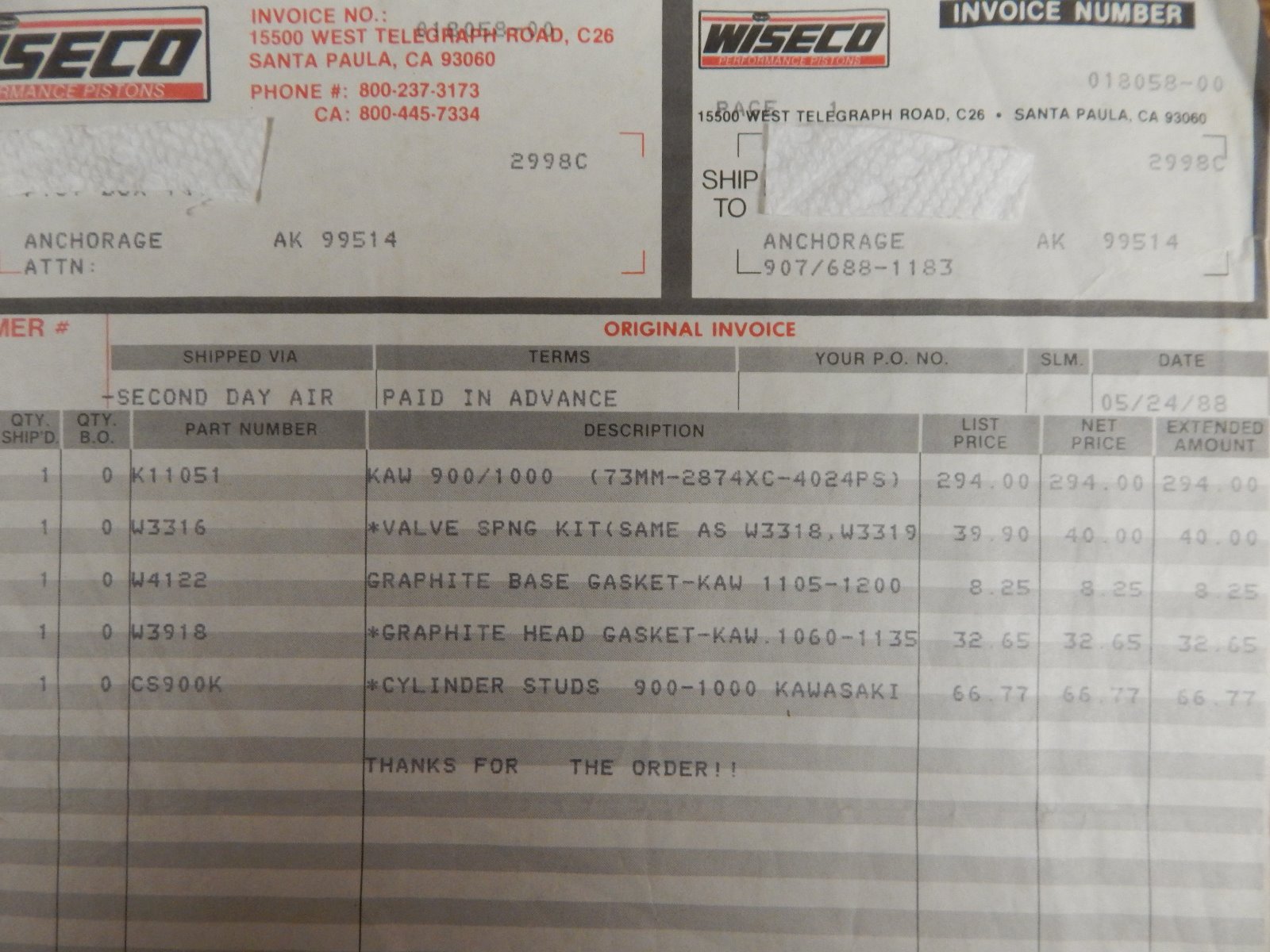

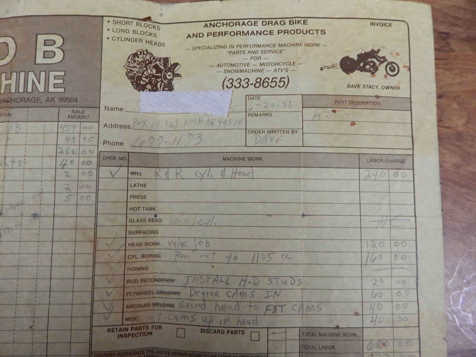

Years ago my first bore kit for my Kaw- 77- 1000A was a Wiseco 1105 kit, (10.25 comp). With cams and carbs, no head porting , it made a big overall power increase. I did not ride it a lot, so I didn't have issues with what zed1015 has mentioned, and I believe that he is spot on. Is bigger better ? Good luck to you..

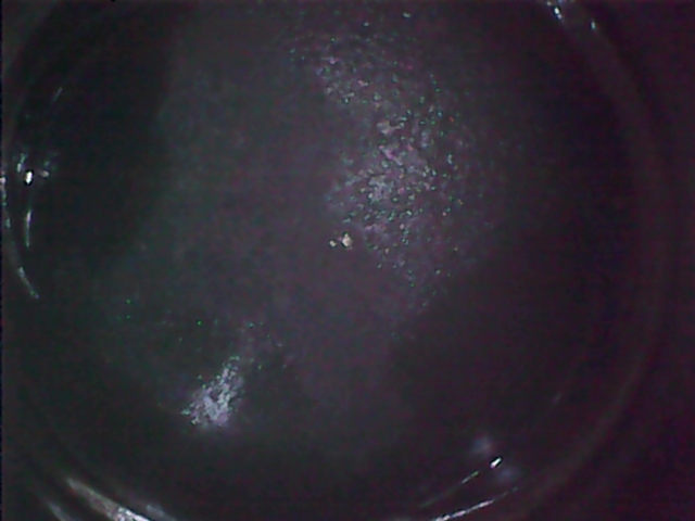

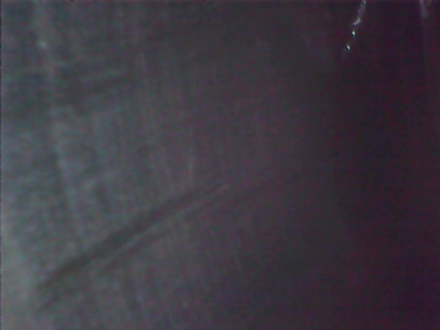

This is what I'm dealing with now. The tolerances are at the limit so it's time to go bigger.

The cylinders are cleaning up but I think I can hear some piston slap. The bores are on the outside edge of tolerance. Now to find a shop that can bore to match the new pistons. Meanwhile I'll RIDE THE PISS OUT OF IT. :woohoo:

One's still too lean.
