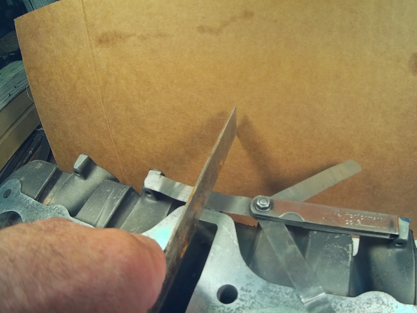

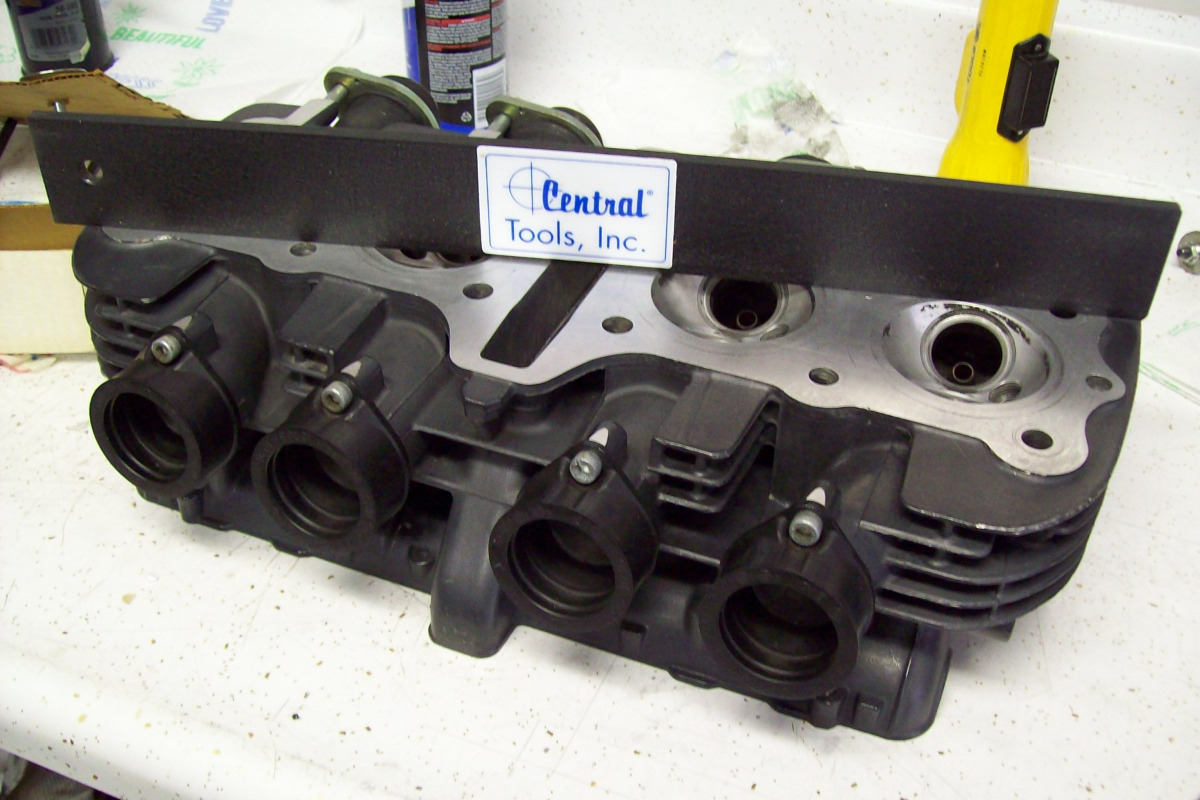

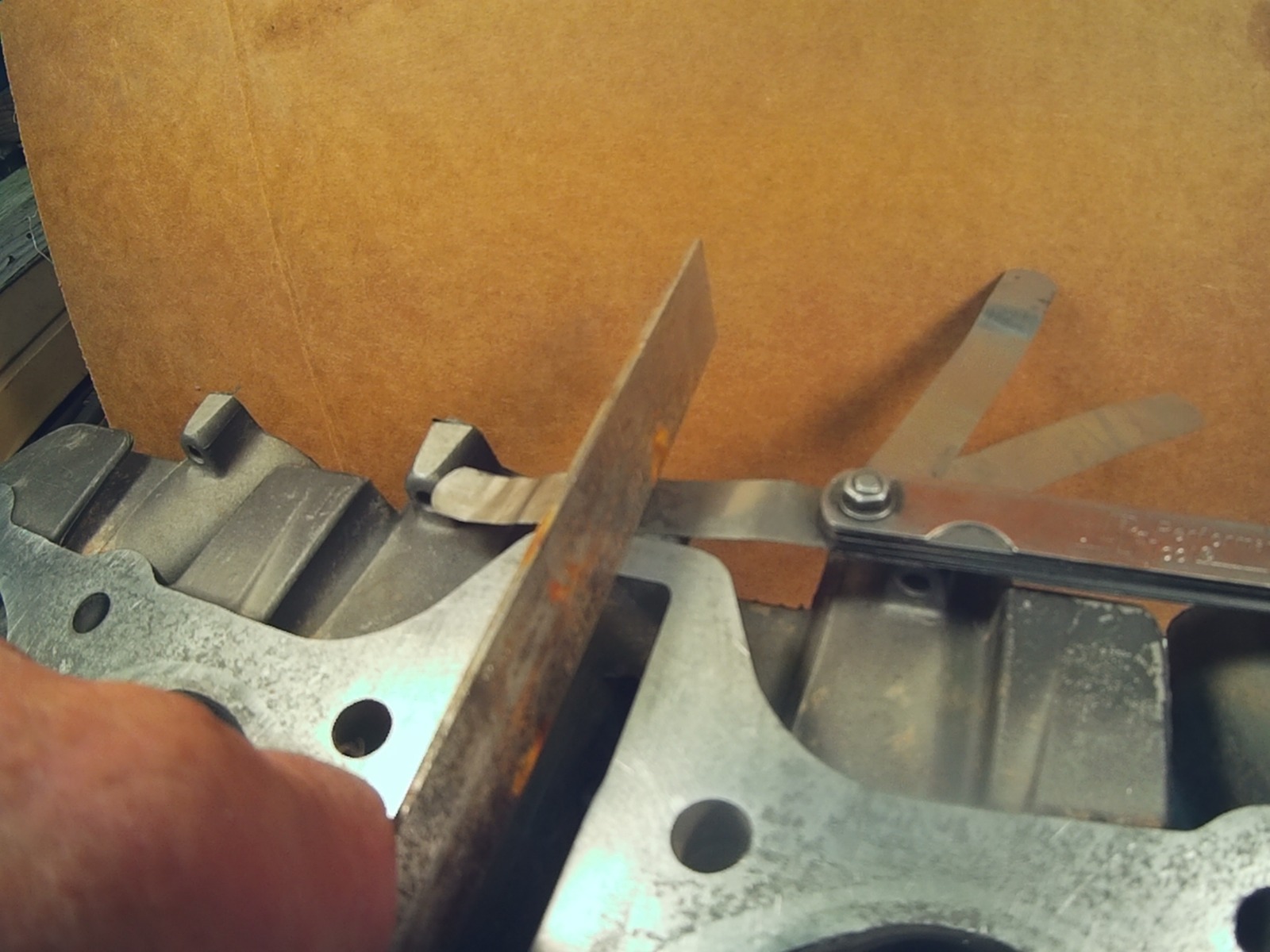

How much material can be removed from the surface of a KZ 1000 head and how can I tell if it's too much? The head is flat all along the surface area.
.002 moves freely
.003 is too tight
.002 moves freely
.003 is too tight
Last edit: 06 Nov 2019 14:24 by SWest. Reason: add pics

Whats your goal by decking the head? If you just need a fresh surface they will remove a few thousandths and it wont really effect things. If you are trying to raise compression you need to measure the combustion chambers before decking, then you can then roughly calculate how much to remove based on the compression increase you would like.

I suspect the head I'm working on has been decked. Maybe too much. That's why I ask.

you can measure the combustion chamber volume and compare it against stock. this is how its done>

I have seen them decked clear down to edge of valve W/O issues. in fact I do the drag bikes to get the quench down.

I saw a pic of a 900 head on this site where they just about cut into the fins.

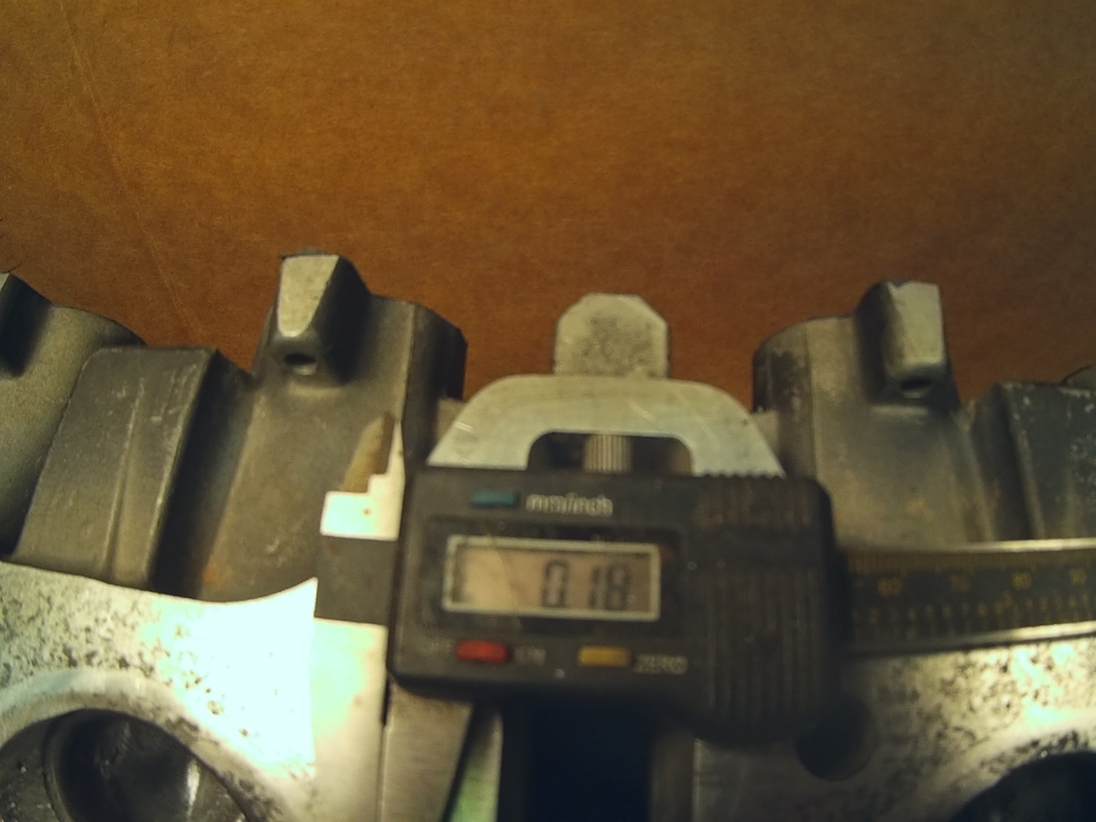

- Posts: 23722
- Thanks: 3010
Re: Decked head
07 Nov 2019 11:24
This is what I'm working with.

A KZ1000 head that has been decked 1mm will only have about a 3.8CC difference from stock, you need a piece of plexiglass held on with grease and a graduated cylinder to measure accurately. The surface tension of the fluid will make it impossible to check correctly without it

That's OK. I found out what I needed to know. I'm going to modify the chambers like I was talking about. I'm more concerned about the voids filling with carbon then glowing causing detonation. If I lose a little compression so be it. Who knows, the engine may breath better. :whistle:
