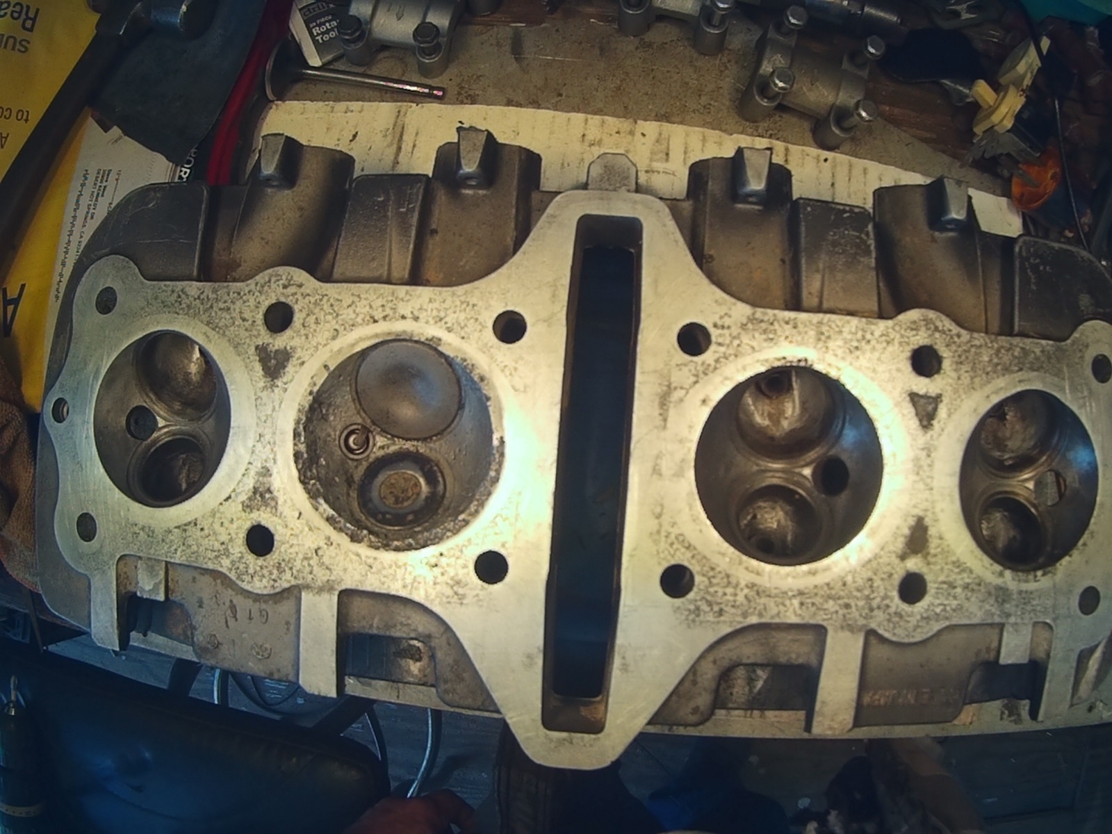

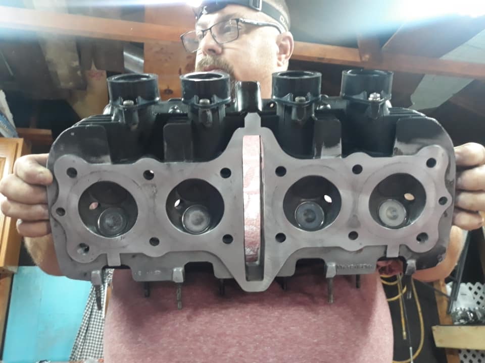

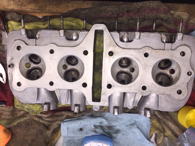

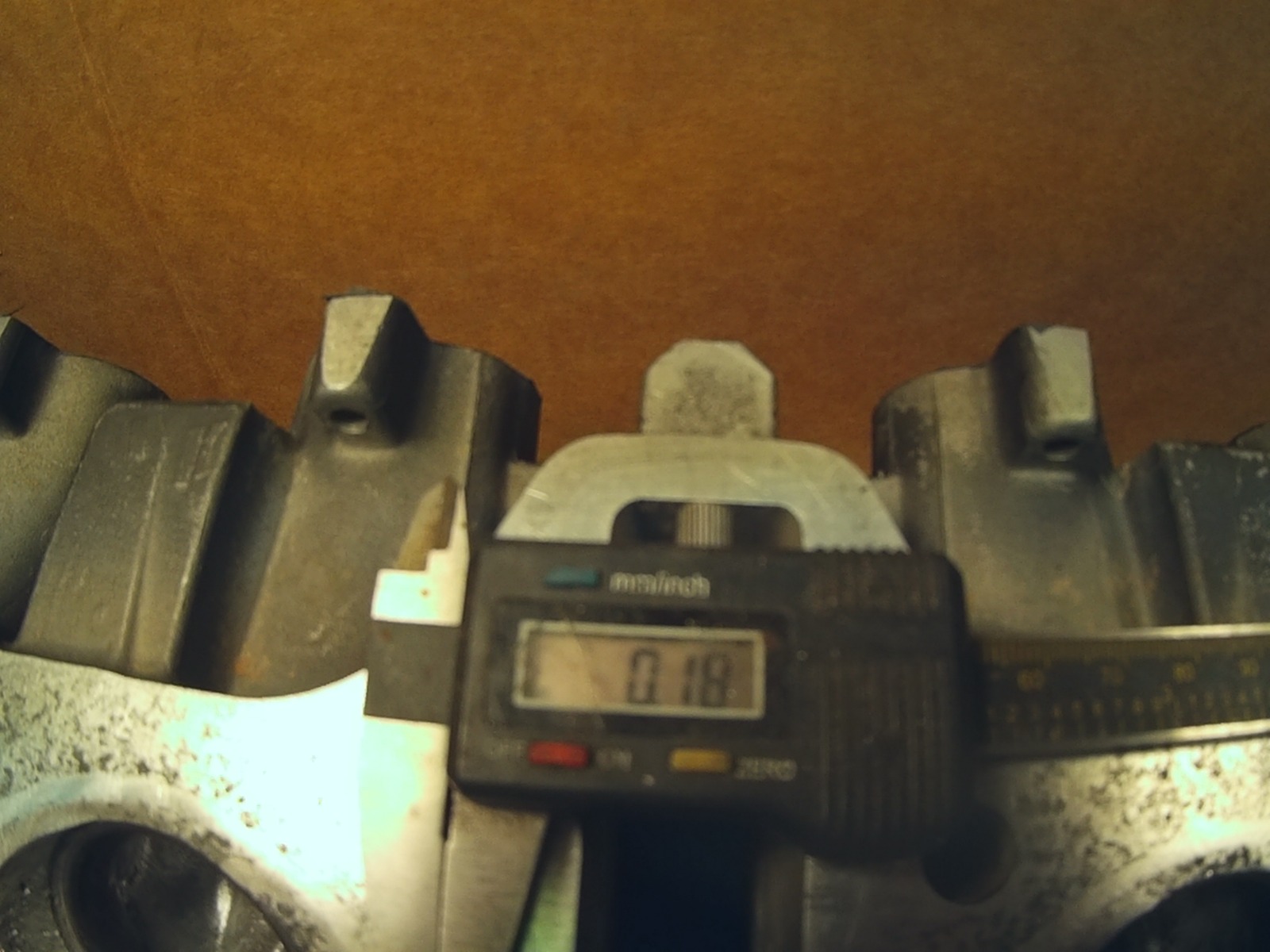

Thanks to Bill I have a better idea how much this head had been decked. He measured .95mm and I measured .18. That's .77mm difference! :blink: I assume the head he is working with is stock or close to it.
Mine
Not as much as this guy
So I've decided to go with what I have as is. I'll polish the one combustion chamber a little more with a wire wheel and clean the mating surface better. The old gasket material left a stain but it's clean where the compression rings in the gasket are. Who knows, I may get back some compression lost with the deck height.
If I spend any money on a head it will be the one I take off the bike not this one. :whistle: This one I'll put on and RIDE THE PISS OUT OF IT. :woohoo:
