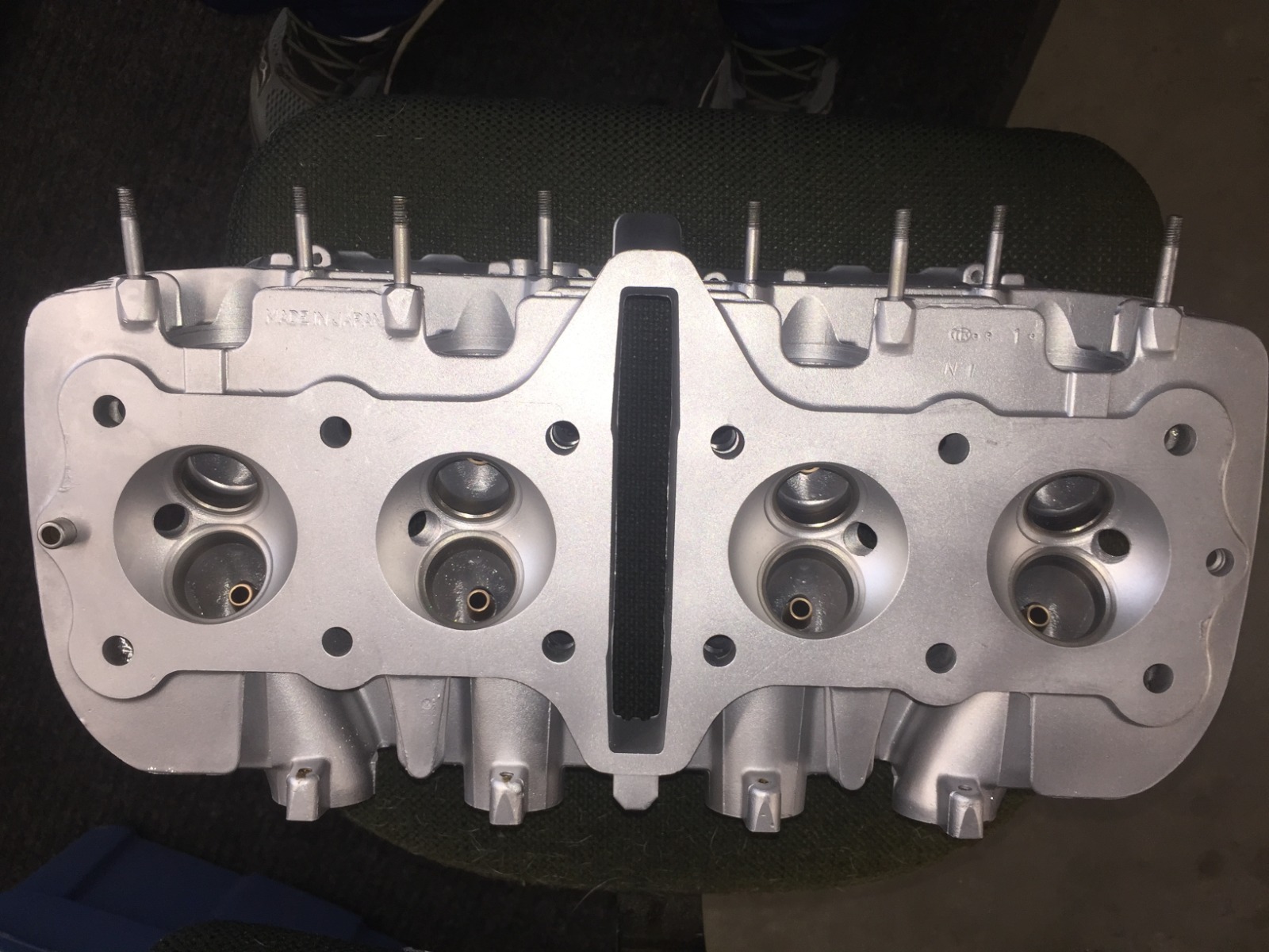

I wonder if when the head was milled....did they also sink the valves in deeper? Here is a photo of my head off the 900 I'm rebuilding...for comparison.

Good point. Does it have that radious on the intake seats like mine? I can assemble a intake and exhaust valve to check clearances. I should do that anyway before I tear it down and be committed.:dry:

I'll take a couple of closer photos this morning and get back to you.
