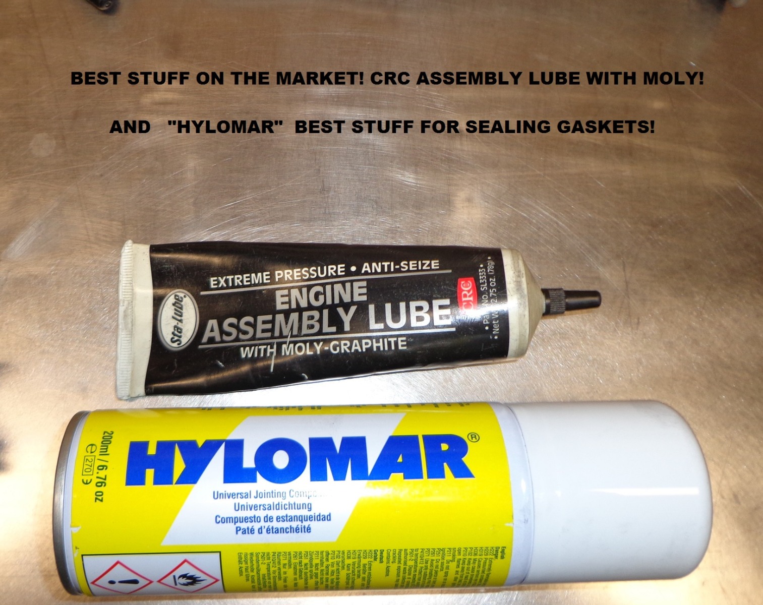

And as a side note! Cylinder head gasket sealing! These old 1950's cast iron heads. Ad 1500 horsepower and Methanol with 20 pounds of boost! We used to have blow by at the holes so close to the bore. HYLOMAR! Hylomar sealed these hemi heads!
The Best stuff ever!
