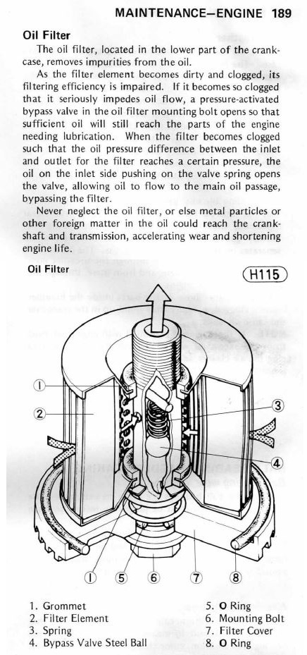

02 Aug 2019 07:35 - 02 Aug 2019 12:13Ah whole bunch of conflicting info on the fence. This is from the 750 E1 ahd H1 manual in the manuals download section. The pics are so dark that you can't tell where it's at, but from reading the assembly instructions it tells you to put the fence over the bolt after it is inserted into the cover, then spring, then washer. DUH. :pinch: I give up.. Just throw it away! lol
