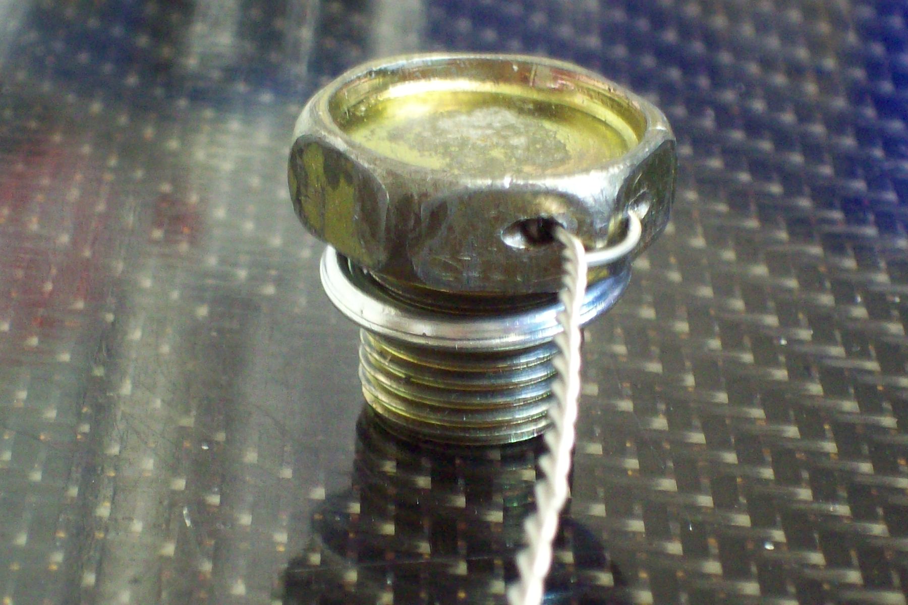

You are lucky you caught it on your pre-ride check. I have seen it a few times where dealership mechanics left the drain plug or filter bolt loose, went for test ride and ended up pushing the bike back missing the drain plug and all of its oil!!! Even seen a few real sharp home mechanics do the same thing!!! $hit happens!!!
Just for some major piece of mind, I would highly recommend drilling a small hole in the drain plug, and filter bolt. Then safety wire both. That way even if you leave one or both loose, they will not back off and fall out!!!! For some of you that are reading this and saying to yourself, I would never do that, I am a better mechanic than that!!! Well I can name you one NHRA Pro Stock team that lubed the whole lane up when someone left the drain plug loose!!!!!

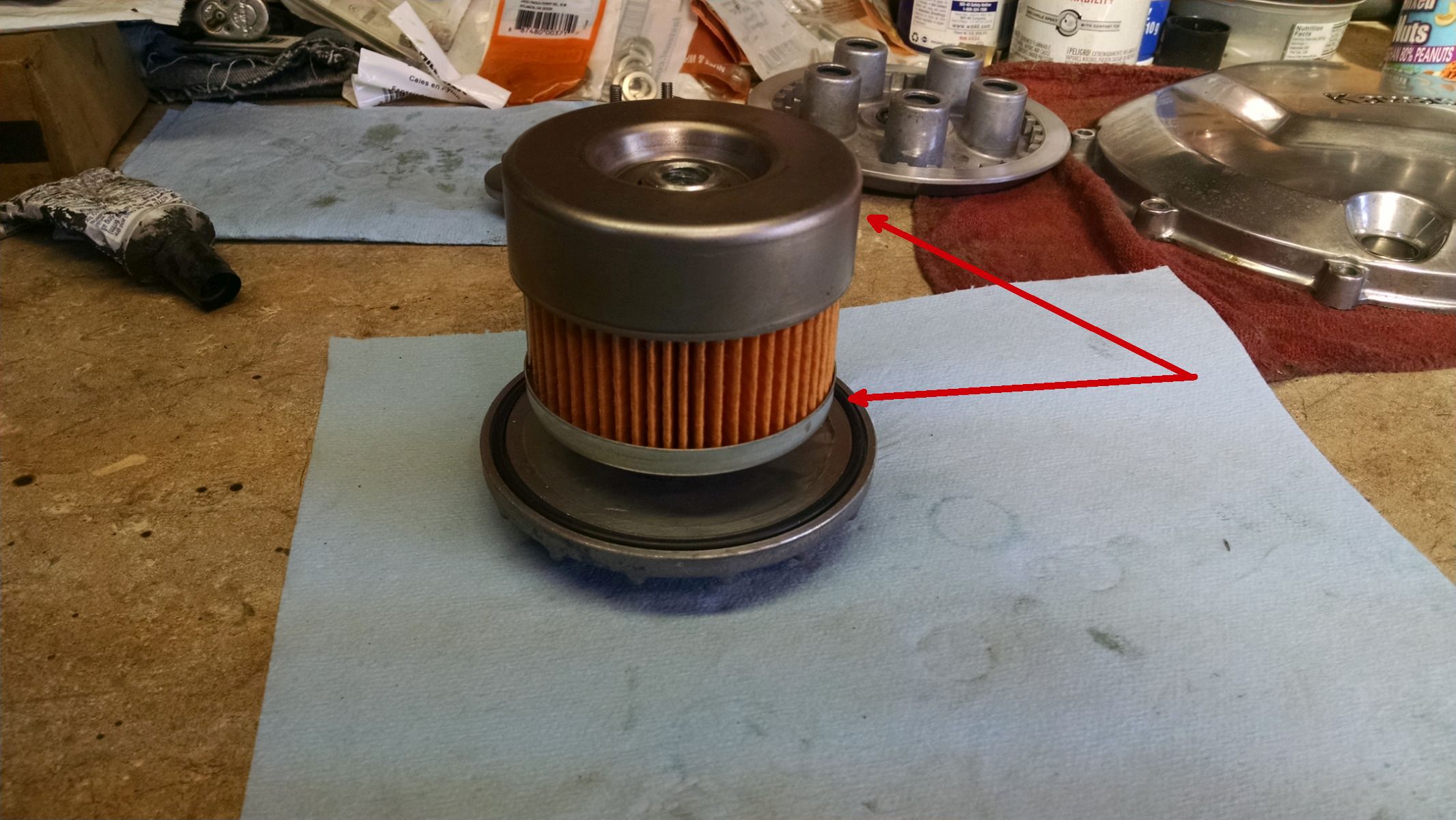

Have to ask about the positioning of the oil filter bucket. Some parts diagrams showing the bucket on top other on the bottom of the oil filter.
Which position is right and what is the meaning of the oil filter bucket?

I've never had a bucket on mine. Including my Z1B purchased new in 1975.
