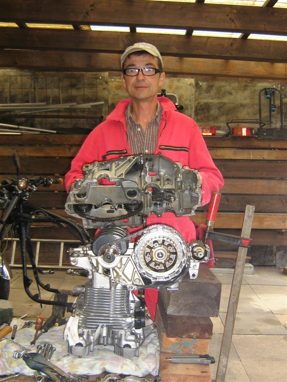

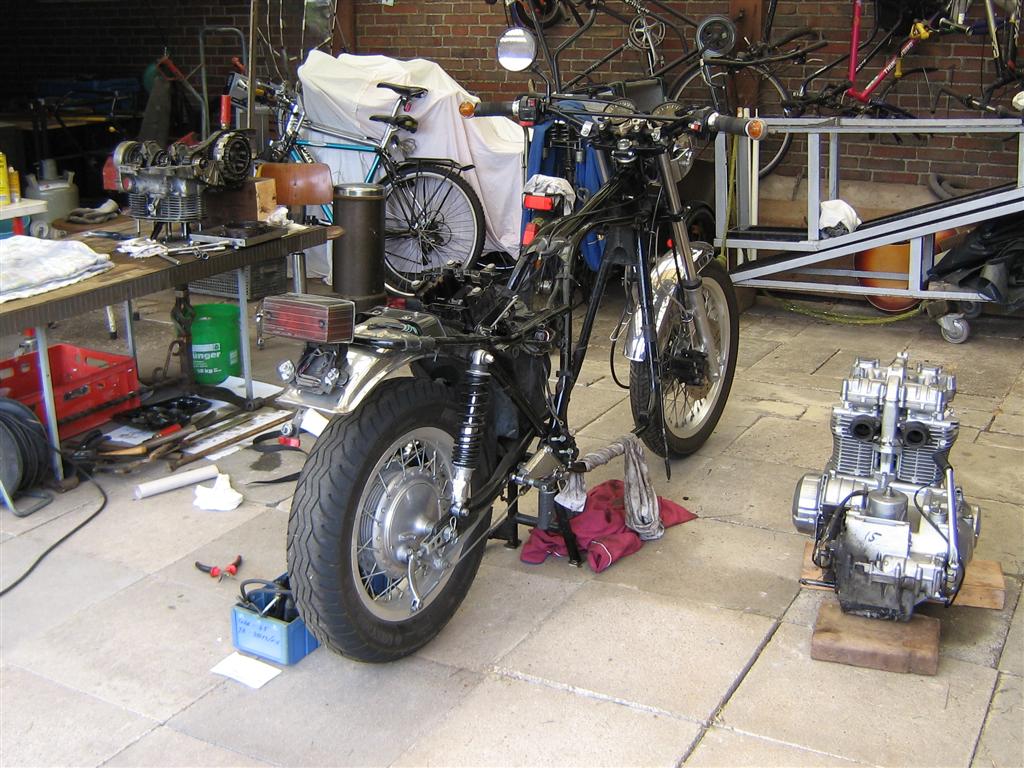

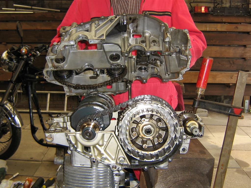

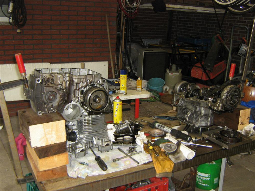

Re: Seized Engine 1982 KZ750 CSR (M1)
23 Jun 2019 03:42
You can split the cases without removing the top end!
The full Story (receiver engine broken 3rd. gear/ donor engine broken balancer): www.z750twin.de/getriebe.htm
