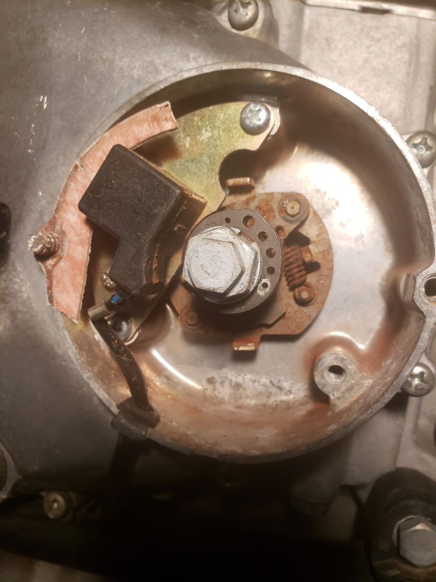

Your ignition advancer need some cleaning and some drop of high temp grease on all moving parts to do his Job correctly.
Remove the rust dust, it can be catch up by the picup coil and irritate/cut off the ignition Timing.

Well, I think you have to keep looking for what locked up the wheel and kickstart.
I assume the kickstart rotates the engine now.
Anyway, when you get around to routine maintenance like the advancer...
This image is for a 4-cylinder but it's similar to yours. I'm posting it so you can see the rubber cushion stop on the arm. When you clean your advancer , be very careful not to knock the rubber bits off the arms. They are really tiny and just look like a spec of dirt, but they affect the timing.
