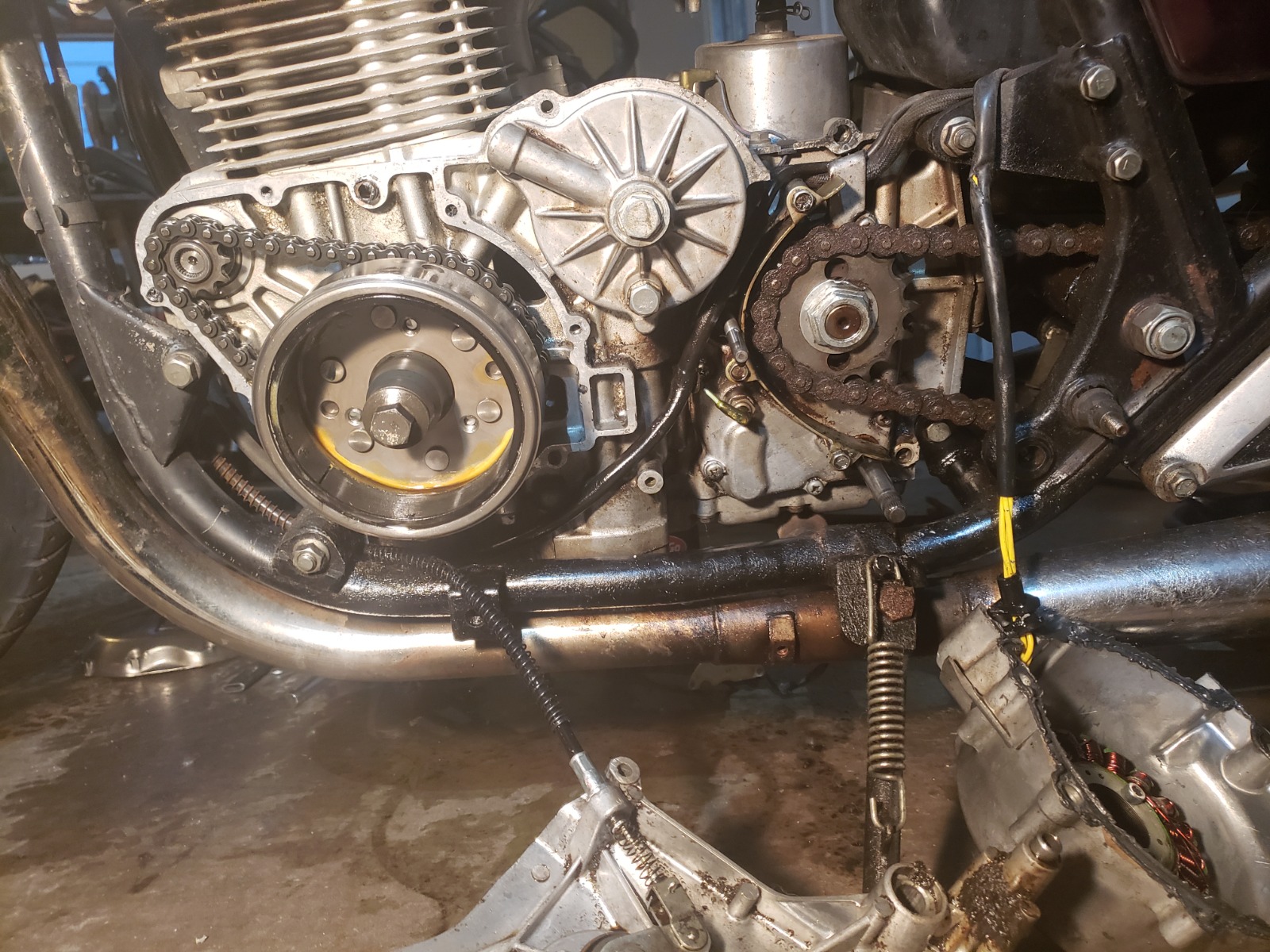

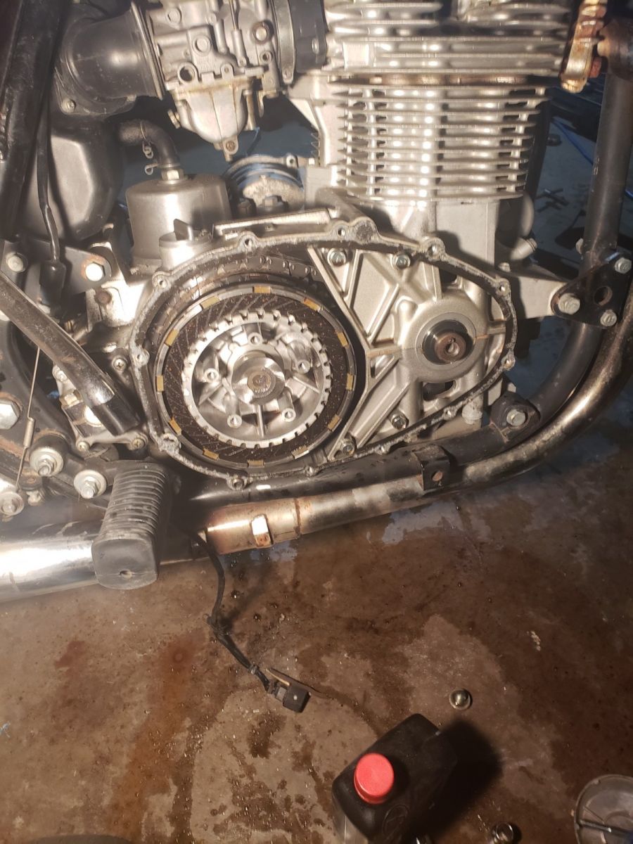

16 Jun 2019 18:40I'm sorry. I took the sprocket cover off to take my stator cover off and everything looked fine under there. Took the clutch cover off and everything seems fine. Should I take the plates out and inspect them? Does this mean it's probably my transmission locking everything up?

Are you sure it's still locked up now that the clutch is disassembled, the kicker should rotate the inner part of the clutch which you should be able to watch?

Even with everything disassembled the kickstart won't move.

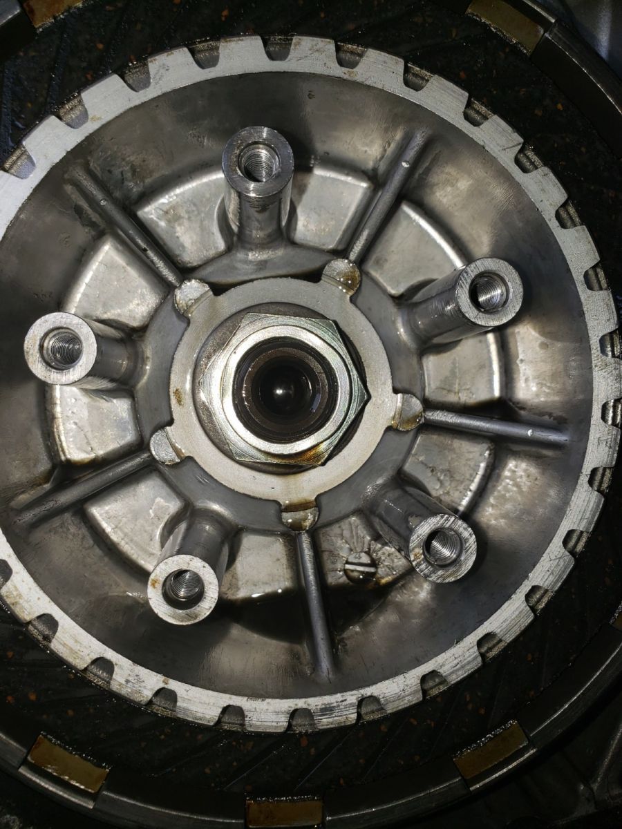

In that case, check the big nut in the center of the clutch. The pusher, which is like a mushroom shape, just pulls out. There is a ball bearing behind it which may fall out, so be aware.
Check that the big nut is tight and that the inner basket of the clutch doesn't move in and out.

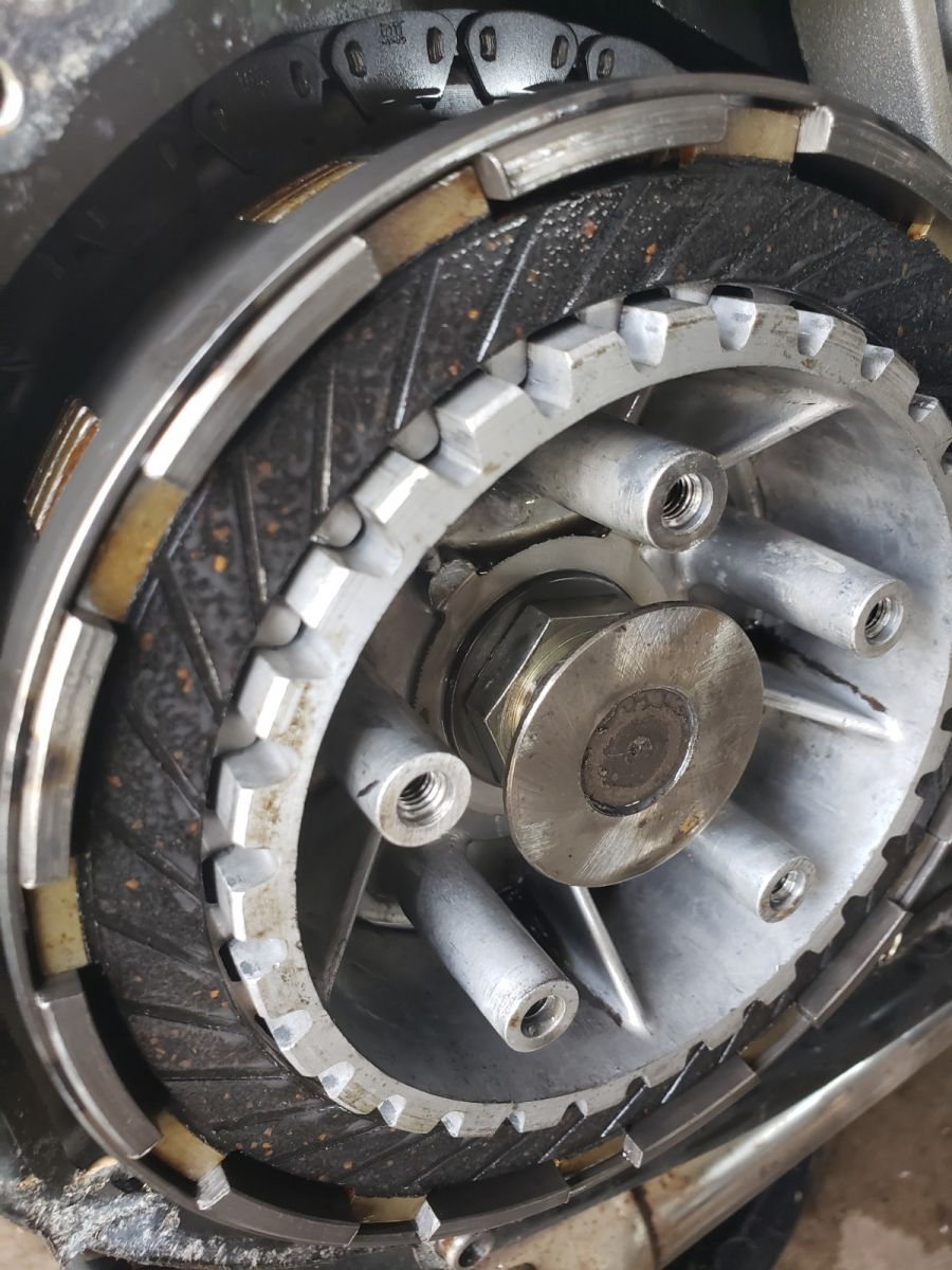

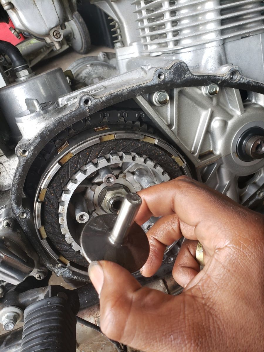

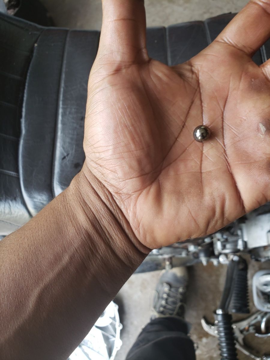

As soon as I took my spring plate off, the kicker started rotating. As I tighten it down it locks the kickstart. Just the pressure of having all bolts and springs finger tight makes it 90% harder to rotate - 100% being immovable.. I took the pusher out AND the ball bearing out and inspected them. I'll post pics.

I can pull the pushrod out from the other side and its still locked up. (ball bearing is still in it I promise.)

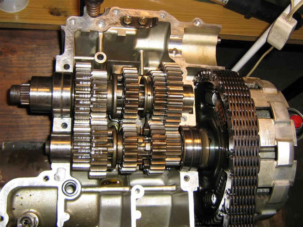

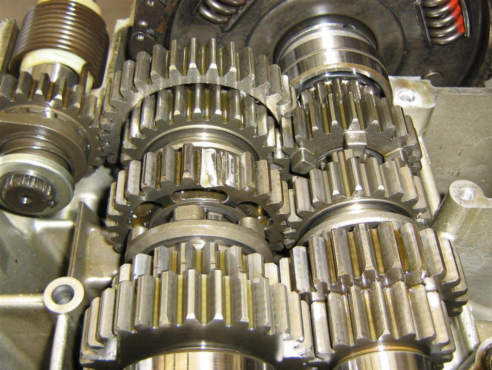

The rod can come either way, but I think the ball bearing, if it's the right size, can only come out on the clutch side, not the sprocket side. That is how it is on many Kz's.
The kicker engages the first gear on the output shaft, and that first gear engages the first gear teeth on the input shaft (which is the shaft that the inner clutch basket is connected to). I wonder if something came loose that now allows the clutch basket to move and causes first gear to engage while another gear is engaged.
Does the inner basket move out or in when the pressure plate and springs are out?
When it's assembled, the springs are trying to pull the inner basket away from the motor.
Your clutch nut looks tight though.

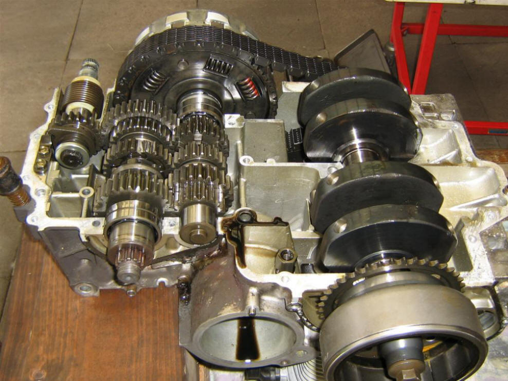

Re: Seized Engine 1982 KZ750 CSR (M1)
18 Jun 2019 18:43
The following user(s) said Thank You: loudhvx, Duckinfumb
18 Jun 2019 19:29
I my opinion your kick starter mechanism (gear on the shaft) locked your output shaft.
