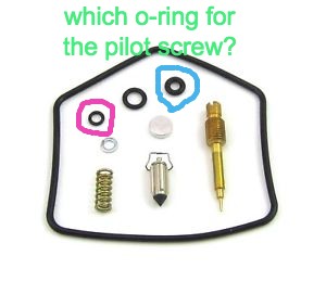

Are they Keihin carbs ? And is that cap over the pilot jet? Is it a white or creamy coloured plastic cap with an o ring on one end?
If so then then it is very necessary. Bike will run like crsp or not at all without it.
If not as described above then please disregard this post.
Yes it is Keihin carbs but it looks like its supposed to be taken off, it is a clear plastic sort of , but im almost certain it should be removed because the spring and o-ring etc wouldnt fit if not

20 May 2019 05:49 - 20 May 2019 05:50The skinny one is my guess. It looks too big in the photo but it's hard to tell. I'm not a fan of aftermarket "carb kits" because you never know if the parts will fit. The fat one looks like it's for the drain plug screw.

The plastic cap I referred to goes inside the carb on the end of the pilot jet. It is number 11012 in the diagram I linked to. As mentioned above, the bike will run like pookie, or not at all, without them in place with a well-sealing oring.
