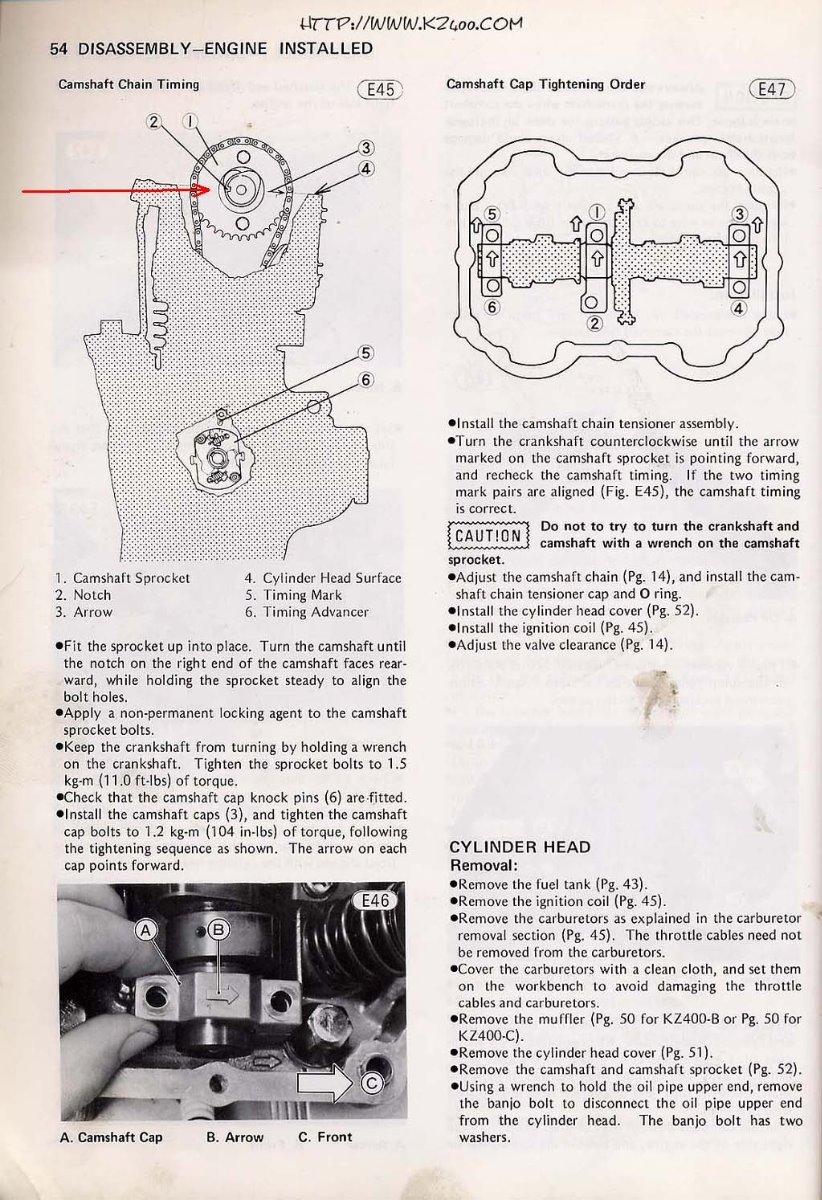

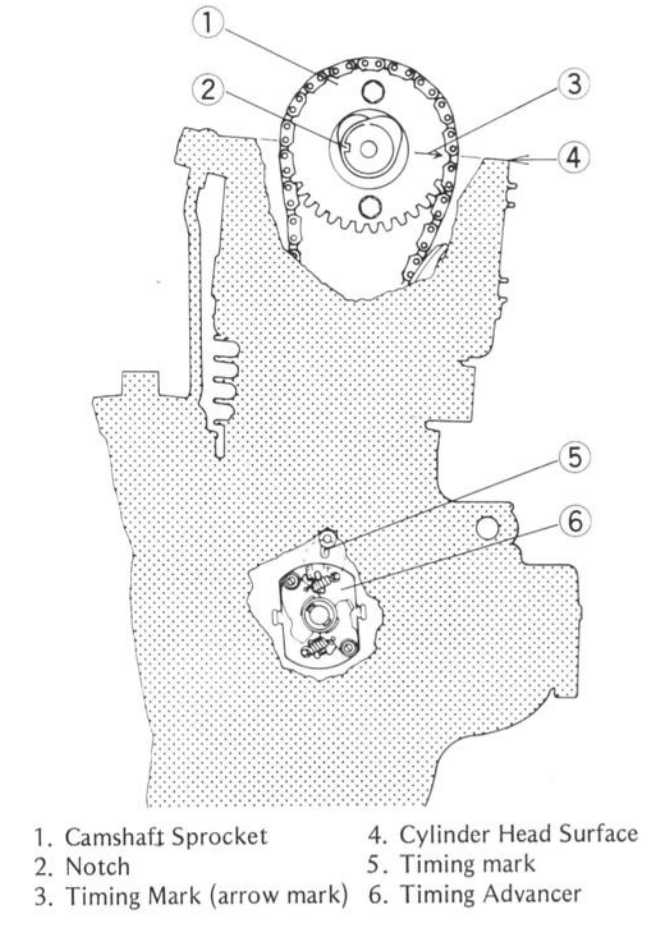

This illistration is from the 440 manual but I think it should be same for the 400 (someone correct me if this is wrong). Anyway, this is the end game. 1-4 T aligned on the crank and the arrow on the cam sprocket pointing at the gasket surface.

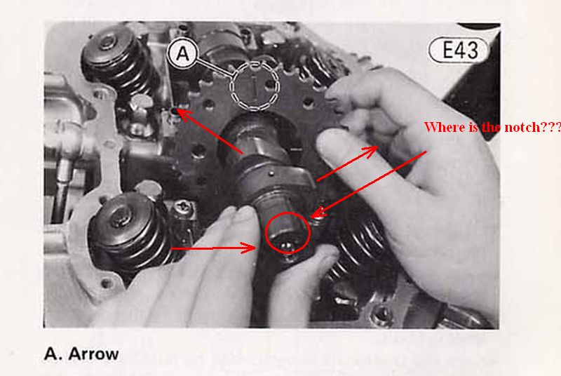

His motor is in a strange position. Because it is such a late 400 motor you might think it uses the 440 valve train, but the part numbers show a roller chain.
The 440 used a Hyvo chain.
The sprockets etc. would all be different.
He may in fact need to use the older 400 cam timing system, which if you read the 400 manual is more complicated than the inline-fours. The procedure is more complicated, that is, not the actual timing.
The sprocket has two arrows, one for installation purposes and the other is for actual timing. The manual for the 400 I have only covers up to 1977... that's the one with the complicated procedure.
I also have the 440 manual you posted that image from.
What I don't have is the actual manual that covers a 1982 Kz400H1 engine, so it's hard to say what the exact procedure should be. If the parts are identical to a 1977 Kz400, then I would use the earlier 1977 procedure. If they are different, then I don't know what to use. The parts he has are going to be different from the 440, so I don't know he can use the 440 manual.

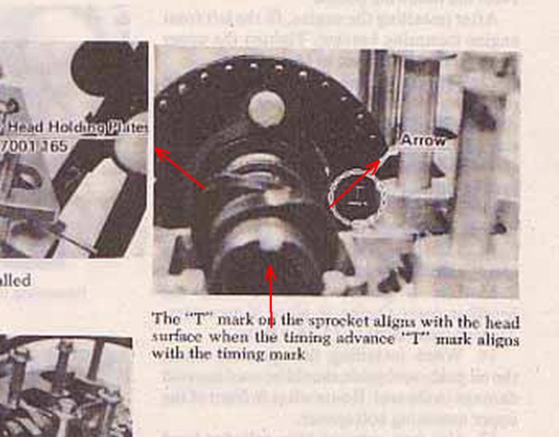

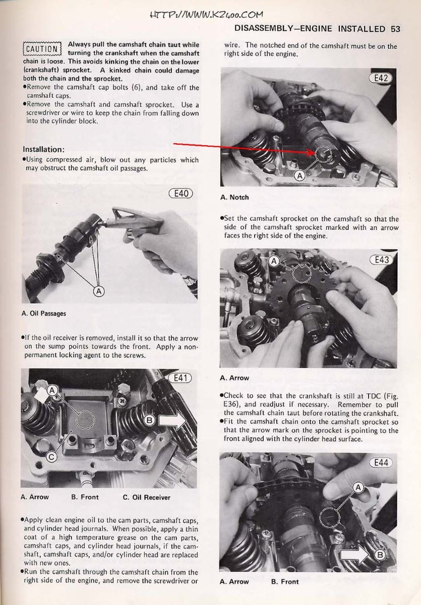

Looking at the older 400 manual and the 440 manual, both have the notch upward at TDC. The older 400 manual has you locate the cams to where the notch is 90 degrees CCW of TDC for installation purposes, but the final timing, as I understand it, is notch up at TDC. Both motors use the same procedure in order to install the sprocket onto the camshaft, but the older motor has a non-marked arrow for sprocket installation whereas the newer motors apparently do not have the arrow.
However both should have an arrow with a T mark, and that lines up with the valve cover deck when the advancer is at its T mark.
That should result in the final timing the same on all motors... T-arrow on the valve cover deck, with notch up, with T mark on the advancer lined up, and pistons both at TDC.
Refer to step 6 page 772 of the posted images.
The notch is just something to confirm with a quick glance, but the real timing consists of the arrows on the sprocket.

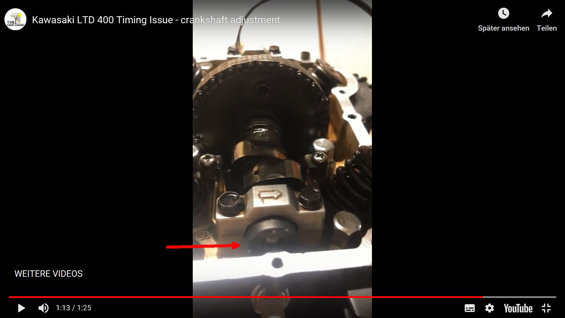

I think I see what you're saying now, the 440 motor notch is not up at TDC it is somewhere around 9 o'clock... is that what you're saying?
So we need a photo of goatfarming's camshaft to confirm the cam lobes are at around 10 and 2 when the notch is straight up or at 9 o'clock, and the sprocket T arrow is lined up with the deck and the T mark is lined up on the timing advancer pointer.

Not only that, but the chain is a Hyvo chain (I can see it in the still photo, but I can't watch the video at work).
This leads me to believe he may have some hybrid 400/440 motor?
The 9'0clock notch and hyvo chain, I thought, were 440 attributes.
I'll try to go back to the fiches. BTW, the fiches don't show a notch in the camshaft drawing.
