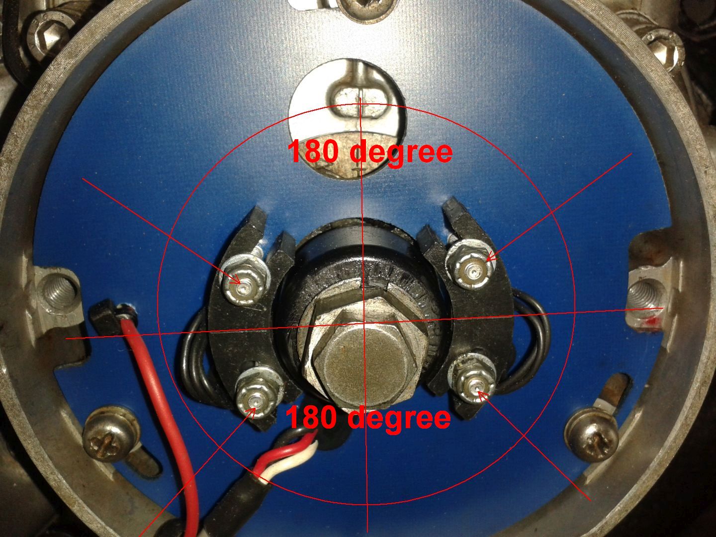

A little though to your problem.
Have you check the F 1/4 and F 2/3 ignition timing, your 1/4 and 2/3 pic-ups could be out of the 180 degree distance. If necessary lose the nuts and adjust to the firing marks.
A pic from my DYNA III, the view angle is little relative.

Re: Engine bog has me boggled
09 Jun 2018 16:09 - 09 Jun 2018 16:11yes, I checked my timing again. I set it with a timing light, 2500 rpm, full advance mark as per Dyan's document. Checked 1-4 and 2-3 both are good. Checked the firing at idle and it is good too. It was out a bit and helped the engine smooth out, especially on a start from stop in 1st gear.
I rechecked the advance mechanism and sal is good there too.
thanks for your input.

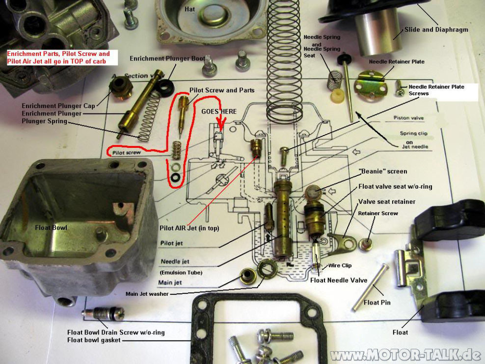

09 Jun 2018 17:24
It is a quick picture add
The pic shows not your carb type but a lot of carb internals could be suspect to your problem.
A good cleaning is the solution to most carb issues.
Some problems are located in a little detail!!!
I wish a good luck
Michael
I wish a good luck
Michael

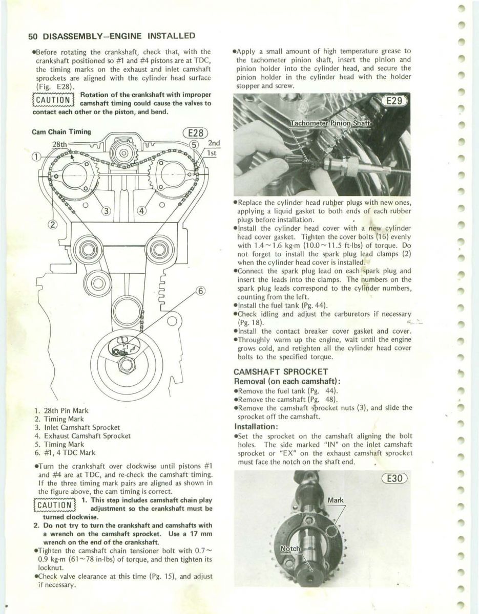

11 Jun 2018 13:45
update:
I am going through the crabs. All ports and jets are clear. I have the cleanest carbs in Canada.
My cam chain tensioner is shot I believe. Would this cause the bog?
Here's some cam tensioner pics.
Cheers,
Ron.
Cheers,
Ron.

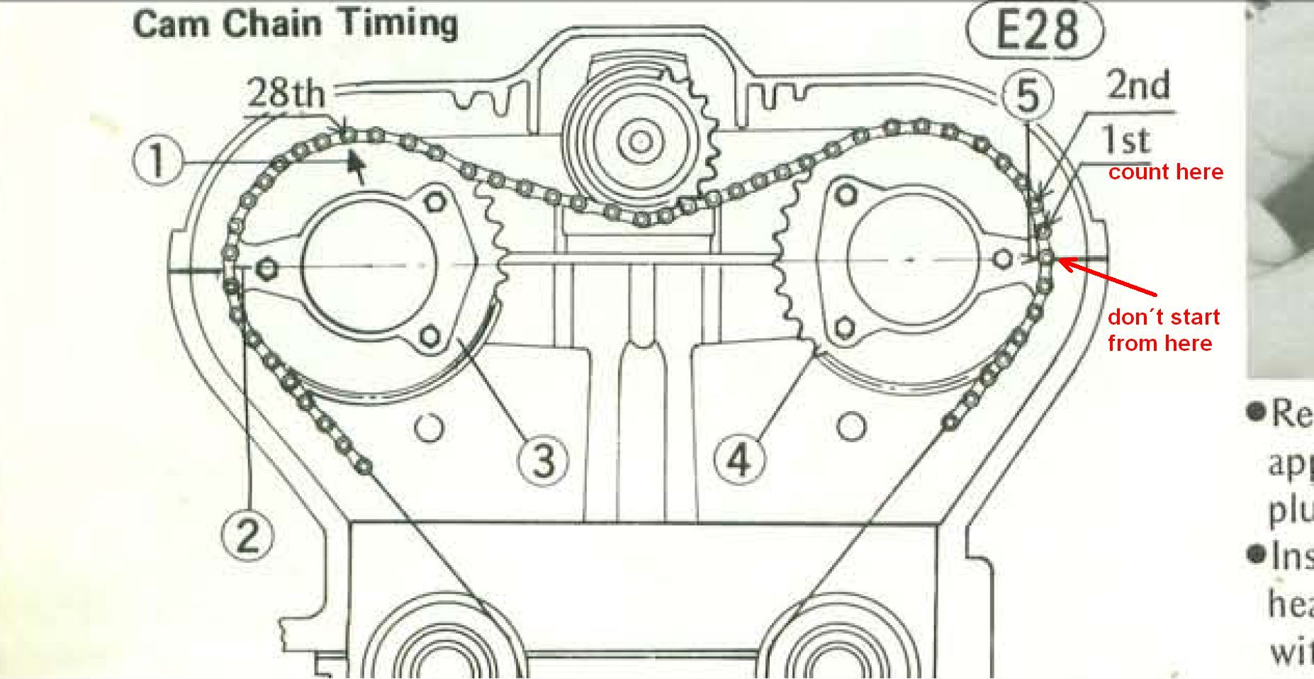

11 Jun 2018 14:19 - 11 Jun 2018 14:23Scirocco wrote: Your your cam chain timing looks good.
When I set the cam chain tension. I loosen off the cam chain tensioner and spin the motor over by the 17mm nut. The chain seems to slacken off in spots under the top cam roller guide. I think I should get an APE updated cam chain tensioner.
Is my cam chain stretched out in spots?
Also, When i cleaned the carbs I didn't find any blockage at all.
Last edit: 11 Jun 2018 14:23 by Ronnie_D.
11 Jun 2018 14:45 - 11 Jun 2018 15:04
Never do a full turn over with an loosen cam chain tensioner!!!:S :S :S
The chain can slip over the cam gears = wrong timing = bent valves.
Only turn the crank some degrees clockwise to let the slack in the chain go to the tensioner side.
Last edit: 11 Jun 2018 15:04 by Scirocco.
The following user(s) said Thank You: Ronnie_D
