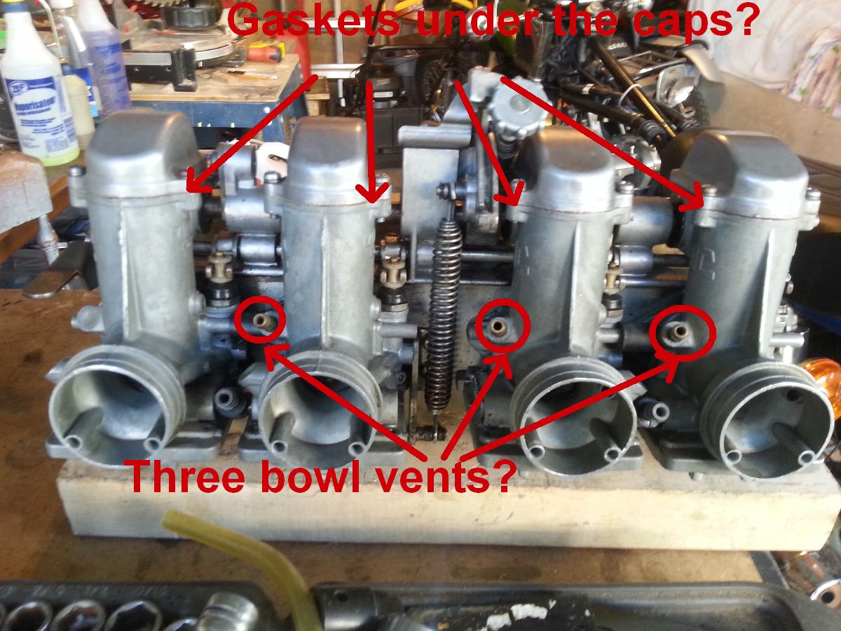

11 Jun 2018 17:58Scirocco wrote:Ronnie_D wrote:
Would this shitty cam chain tensioner and the resulting slop in the chain be the cause of the bog issue?
Definitive no and never!!!
It is an air leak, lean air/fuel mix, pin hole/crack in a vacuum line/plug.
No slack in the throttle cable, a loosen carb slider, a lot of possibilities are left.
I need some pics of your carb environment, running out of ideas....
hey Scirocco,
here are some pics from today.
I checked and sealed the intake boots on the head side, the carb side are soft and seal well.. Not tested while running yet. they looked ok, but you never know. If the seal job works I will buy new ones right away.
I know it's hard to tell with pics what is really going on but here are some of my carbs. Thank you.
In pic number 550 and 510, there are holes right through the bottom of the slides in all four slides. Is this normal?
Also, some carb cleaner residue is still on the carbs, needs a final wash down.
I have eliminated the petcock vacuum and plugged it up to test but the same. Petcock functions good.
New fuel line and vacuum line. No leaks detected.
What areas on the carb are subject to vacuum leaks. I could assemble and test for vacuum leaks with starting fluid or a recommended fluid.
The bog is so dramatic that a tiny vacuum leak wouldn't cause it, a major vacuum leak would though. Can't seem to detect one. "Spray time troubleshooting" next.
cheers,
Ron.

Re: Engine bog has me boggled
11 Jun 2018 18:21 - 11 Jun 2018 18:24
Last edit: 11 Jun 2018 18:24 by Scirocco.
- Ronnie_D
- 1978 KZ1000 A2
- Posts: 67
- Thanks: 6
11 Jun 2018 18:24yes, gaskets under the caps.
2 outer ports are vents,the inner one is vacuum.
thanks.

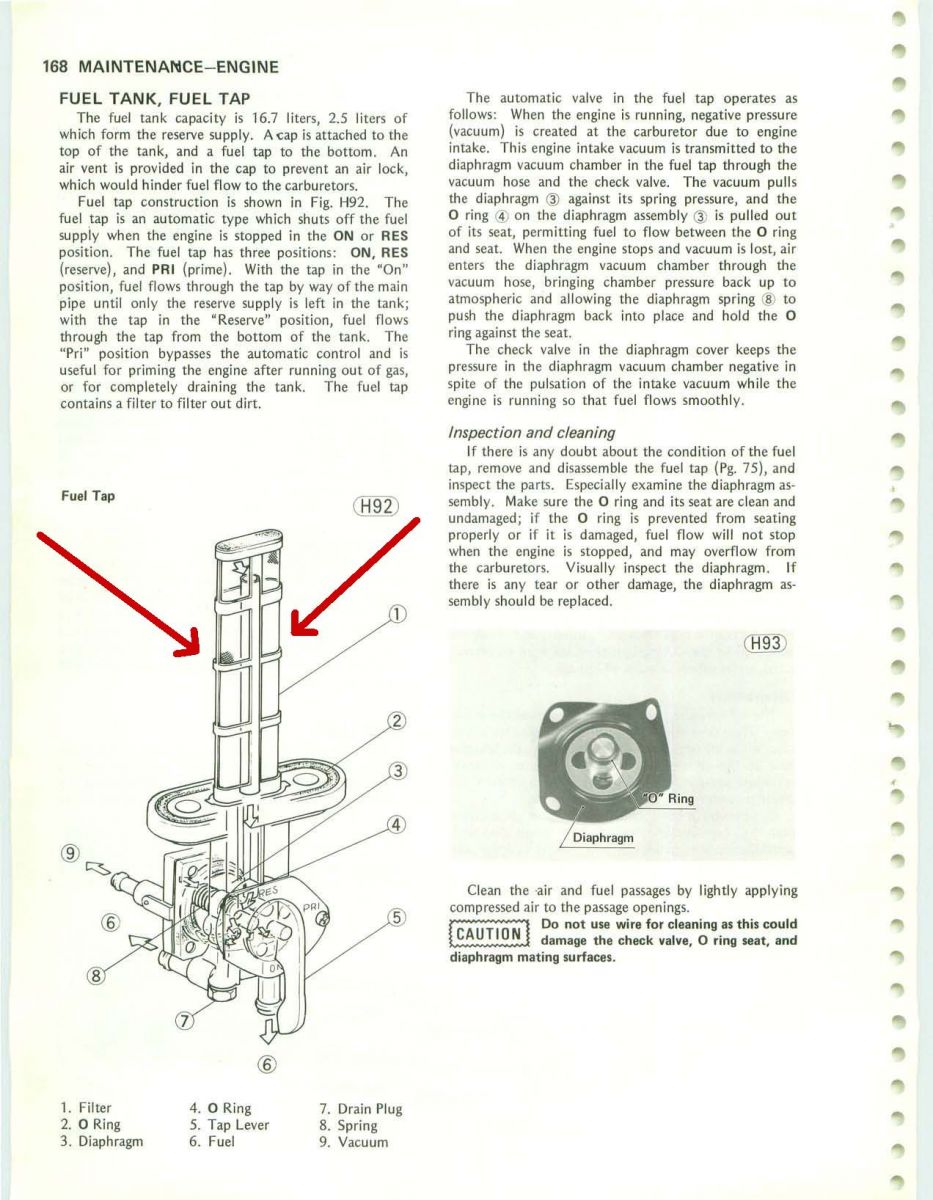

11 Jun 2018 18:33 - 11 Jun 2018 18:33I have checked the petcock, all is good. Even unkooked the vacuum line, plugged it up and rode it on prime, still bogs.
Have your removed the petcock and cleaned the filter???
A clogged filter reduce the fuel flow.
Last edit: 11 Jun 2018 18:33 by Scirocco.
