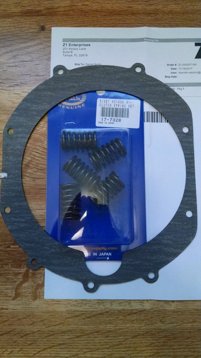

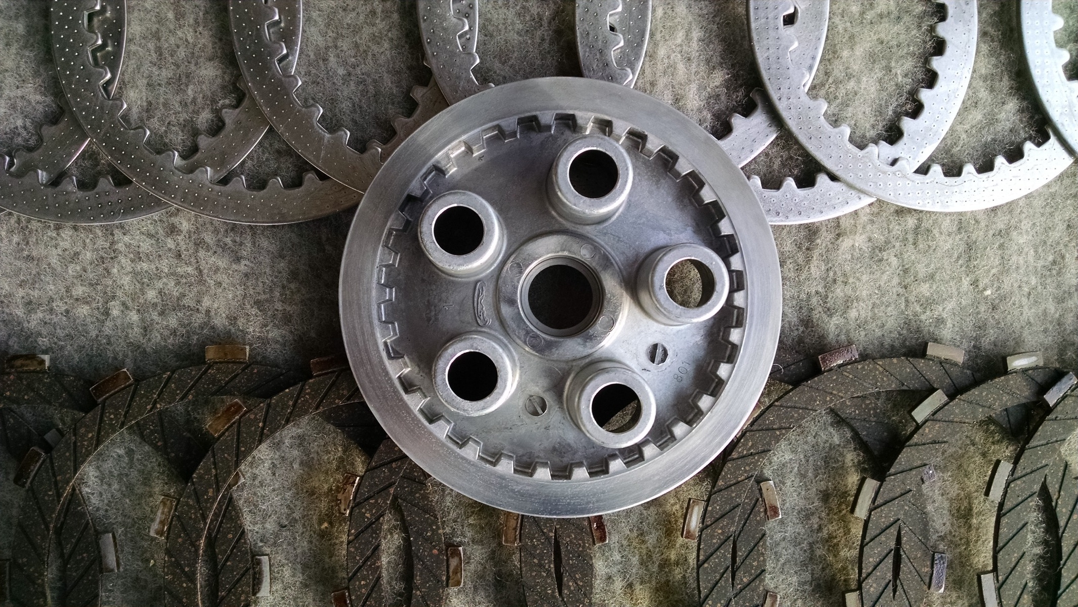

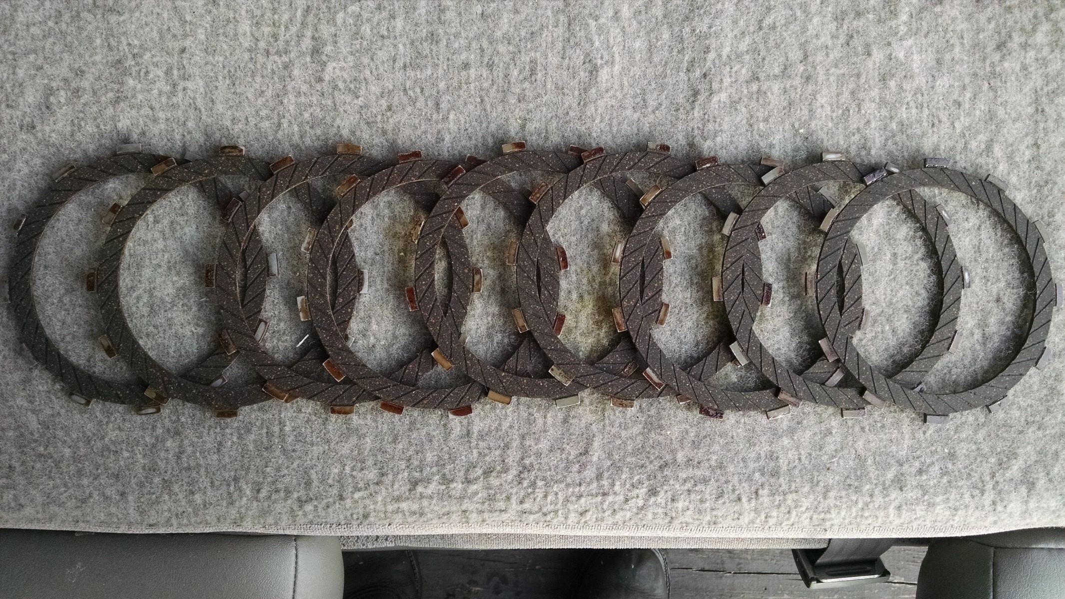

I have been running Rotella T6 full synthetic. I notice my clutch wanting to break loose when the bike is cold, but not so noticeable when at operating temps. Anyway.. I screwed up a while back and put some dino (automotive oil not JATO rated) in my engine for break in purposes (duh!) I did the clutch plate soaking in the citrus de-greaser and replaced the clutch springs (K&L aftermarkets) , and it seemed fine for a while, but last night I could feel it again. I wonder if the T-6 synthetic alolowing the slipage, or if there is still some remnants of the automotive oil circulating around in my motor, and I needed to do the "clutch rescue" routine again.. OR if the K&L springs went weak already. ??? Thoughts?
My clutch frictions and steels after cleaning, also the business side of my pressure plate.
The aftermarket springs I installed.

26 May 2018 10:28 - 26 May 2018 10:29old_kaw wrote: I have been running Rotella T6 full synthetic. I notice my clutch wanting to break loose when the bike is cold, but not so noticeable when at operating temps. Anyway.. I screwed up a while back and put some dino (automotive oil not JATO rated) in my engine for break in purposes (duh!) I did the clutch plate soaking in the citrus de-greaser and replaced the clutch springs (K&L aftermarkets) , and it seemed fine for a while, but last night I could feel it again. I wonder if the T-6 synthetic alolowing the slipage, or if there is still some remnants of the automotive oil circulating around in my motor, and I needed to do the "clutch rescue" routine again.. OR if the K&L springs went weak already. ??? Thoughts?
Looks like aftermarket clutch plates. That could be part of the problem. I use T6 in several bikes and never once had any slippage when using stock clutches. T6 is MA certified too.

26 May 2018 10:55 - 26 May 2018 11:16Nessism wrote:old_kaw wrote: I have been running Rotella T6 full synthetic. I notice my clutch wanting to break loose when the bike is cold, but not so noticeable when at operating temps. Anyway.. I screwed up a while back and put some dino (automotive oil not JATO rated) in my engine for break in purposes (duh!) I did the clutch plate soaking in the citrus de-greaser and replaced the clutch springs (K&L aftermarkets) , and it seemed fine for a while, but last night I could feel it again. I wonder if the T-6 synthetic allowing the slippage, or if there is still some remnants of the automotive oil circulating around in my motor, and I needed to do the "clutch rescue" routine again.. OR if the K&L springs went weak already. ??? Thoughts?
I rescued the bike at 9K miles, so as far as I know it has never had the clutch plates replaced. I'm kinda leaning towards the cheap K&L aftermarket springs being weak and some residual "high mileage" additives still floating around inside my motor.
When I pour on the coals, this bike just plain comes to life. If it doesn't break the back tire loose, the clutch lets go.
