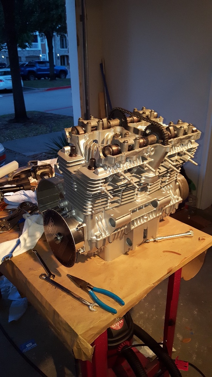

Bottom end 100%, just installed block and head. Before installing camshafts I found TDC with degree wheel and piston stop. It came out about 4 degrees off from the OEM timing mark. Is that normal?

Came out with a cool method for degreeing. Setup a web cam at the degree wheel so I can watch up close on my lap top while turning the crank from the other side.

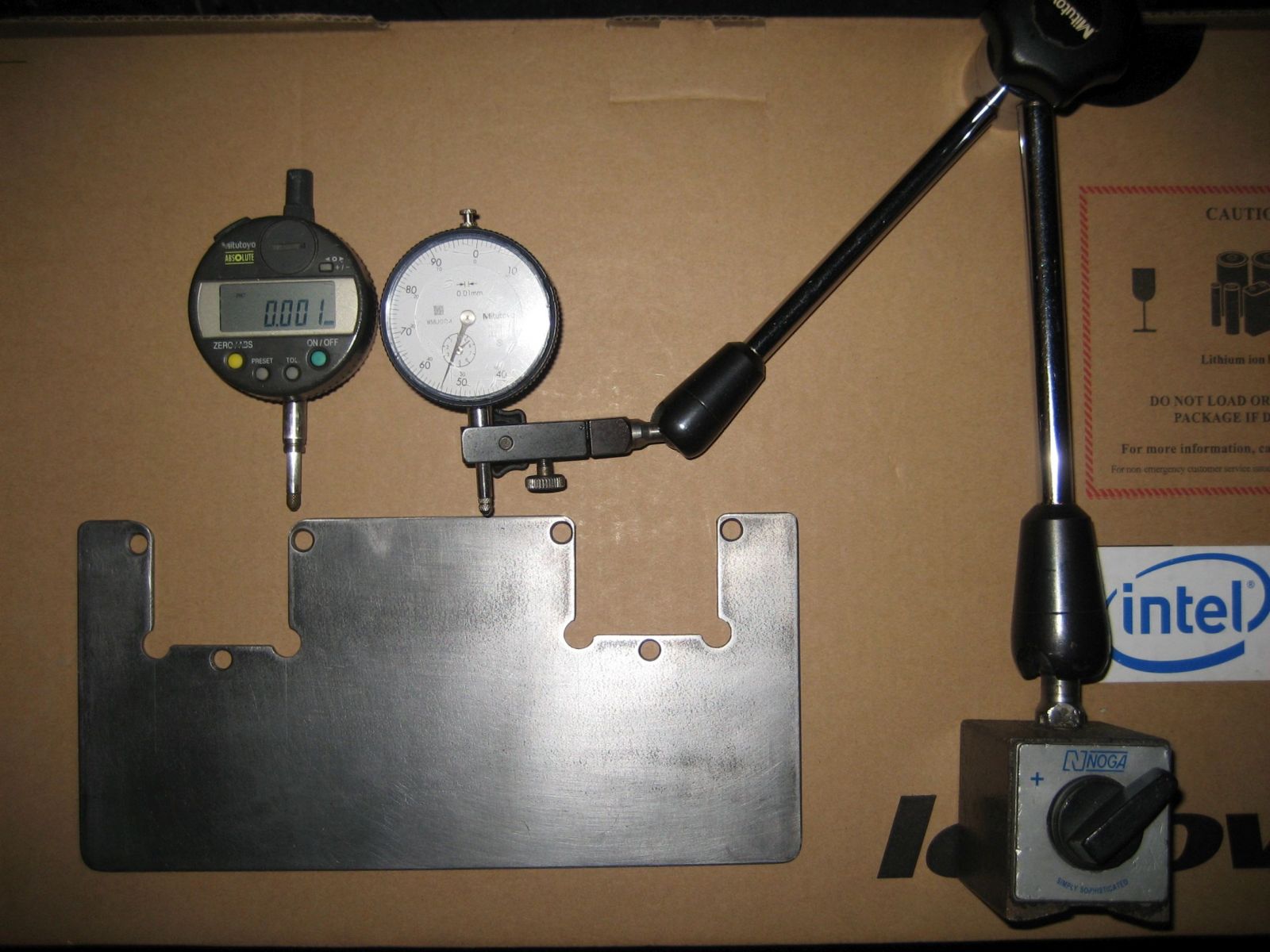

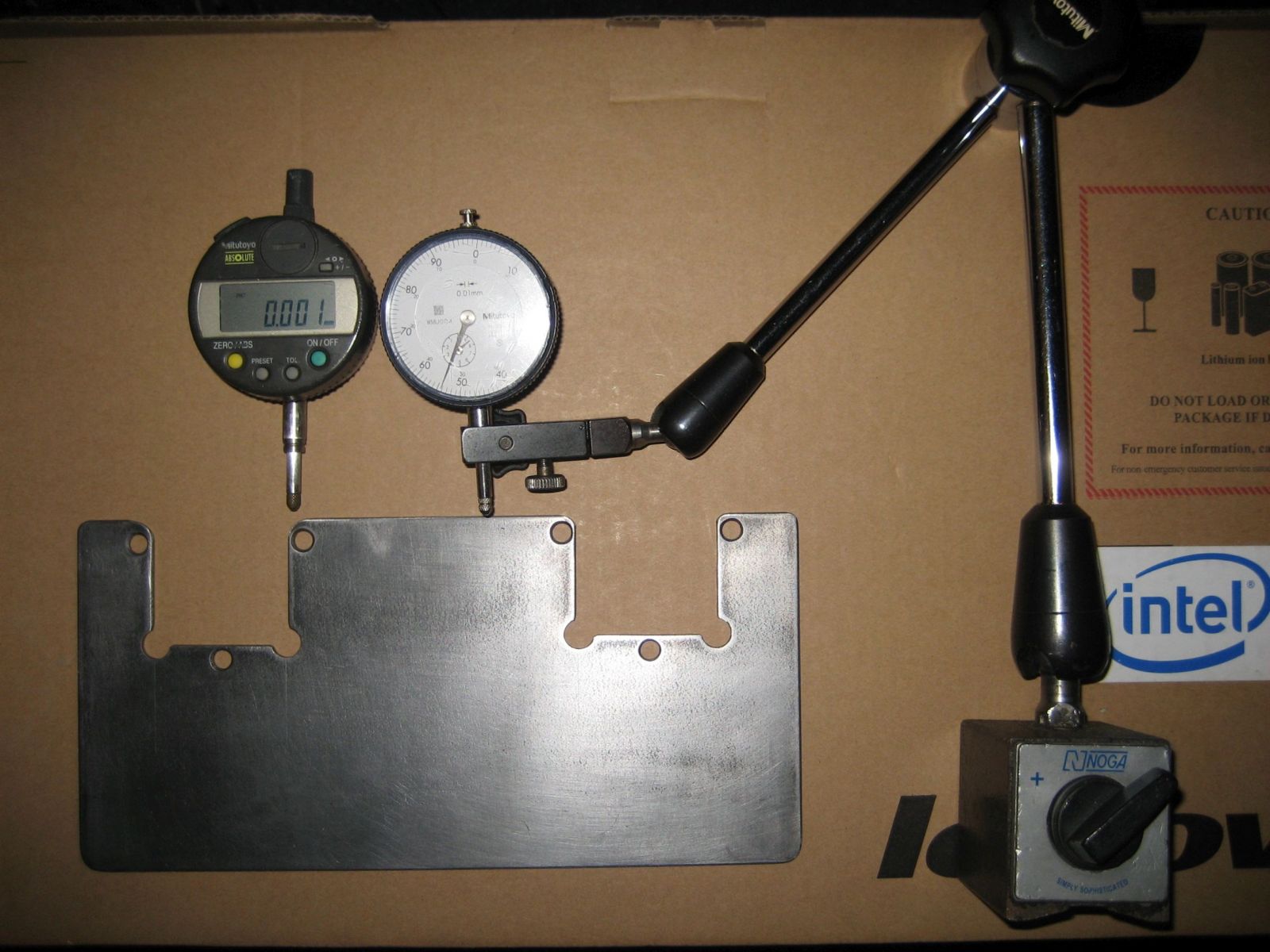

Next is setting up the dial indicator. I think I'm gonna borrow the one from work with the flexible locking arm, as opposed to making a plate to seat my magnetic gauge. The one at work has a longer pin too.
