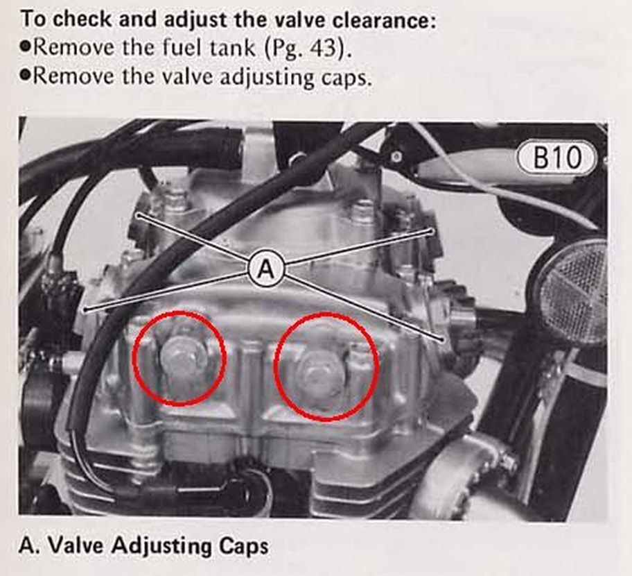

No eBay APP ID and/or Cert ID defined in Kunena configurationNot sure what coils it had, Emgo or something, but that's what i thought the problem was. So I replaced the old coils thinking they were the issue. I replaced them with these:

That is a pic of a late 400/440 head.
You need one for an early 400.
Those bolts are just the rocker fulcrum.:whistle:
