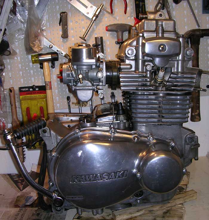

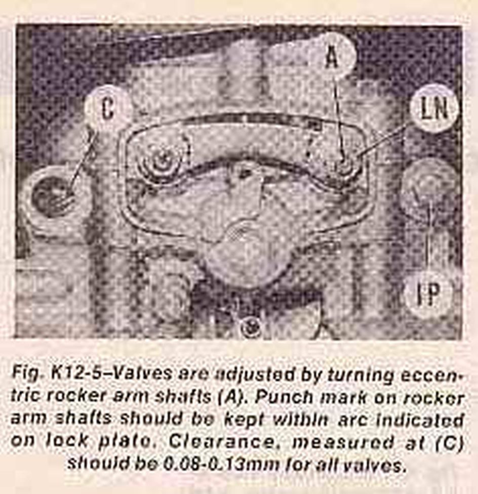

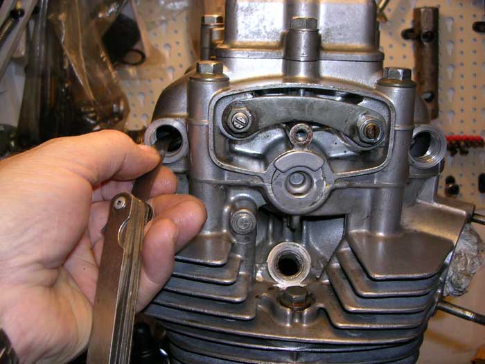

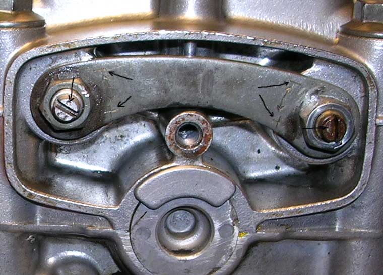

Yes Nebr_Rex you are right, those bolts are just the rocker fulcrum on the late 400/440 head
Here are the pics of the early 400 head and plug caps, source www.kz400.com
The valve clearance should be 0,08 - 0,13 mm

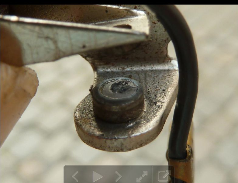

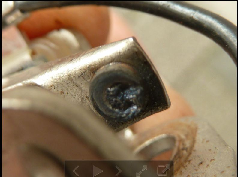

A weak condenser generated strong sparks on the points = (new) points wear out fast (pitting) = wrong ignition timing (gap/dwell)
A clogged tank cap vent generate a vacuum inside the tank earlier or later dependent of the filling level and fuel consumption .
Try to ride the bike with unlocked tank cap to prof the theory. Just a thought.
