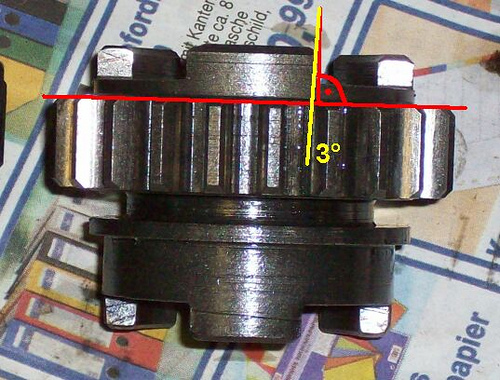

Yes, the 4/5th gear shifting fork can be bent or worn out (hard chromed part of the shift fork).
The 5th gear it self (dog teeth are worn out) and have to be under cut.

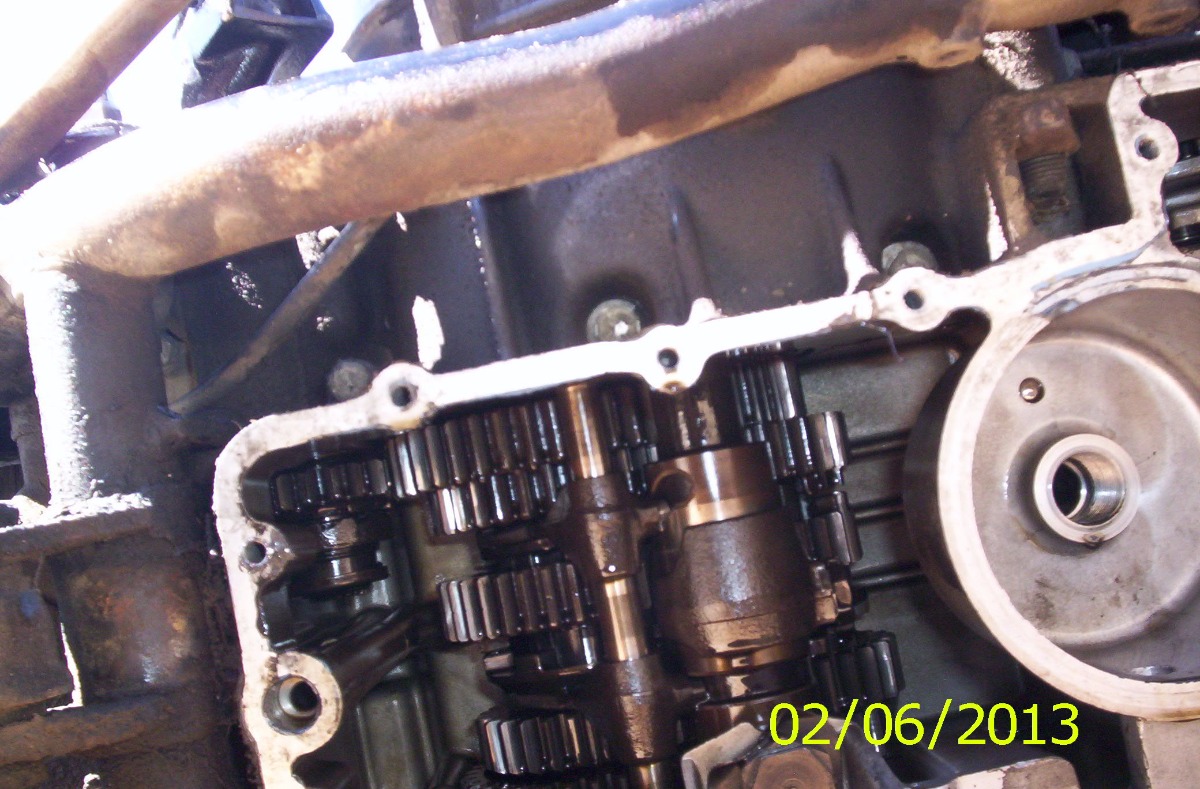

Could be the shifting dogs are worn out. I back cut second but not 5th. It started popping out of 2nd again and when I opened it up 2nd was still good but 5th was visibly worn. I got a low mile KZ 900 tranny before I tore it down and back cut both. On the larger fours you can split the cases without removing the head. PITA but well worth it.
BTW, the 900's had a weak shift spring and main shift fork. I used KZ 1000 parts that are beefier.

Well, I'll be darned. That's too fricken cool man. This is golden brother. I appreciate the attachments, they are a huge help indeed. Pulled the oil pan, and took a look up in there. The gear shown in your attachment as #28, ...or it could be the gear shown as #35 looks like the teeth had been sheered off the one side of the gear.
So, the main shift spring and main shift fork from a KZ1000 would be stronger?? Please advise.

I dunno though, looked at pics of gears on EvilBay and they looked the same as mine. That gear isn't sheered, rather back cut as someone mentioned.

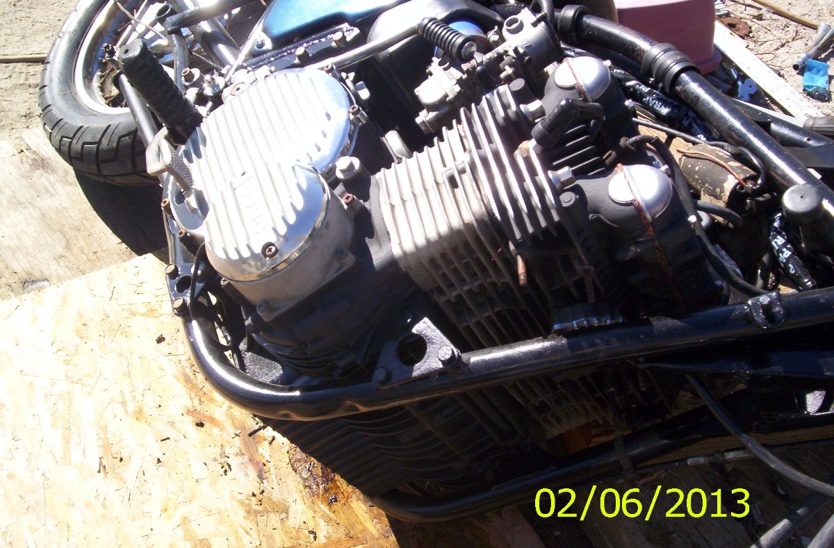

Here is a thread on the subject and one of my clips.
kzrider.com/forum/11-projects/600077-the...-a-1975-z1?start=280

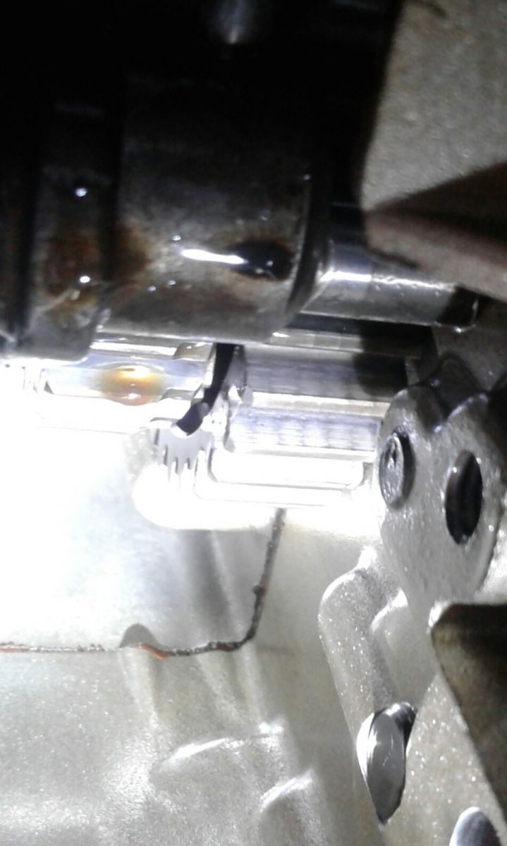

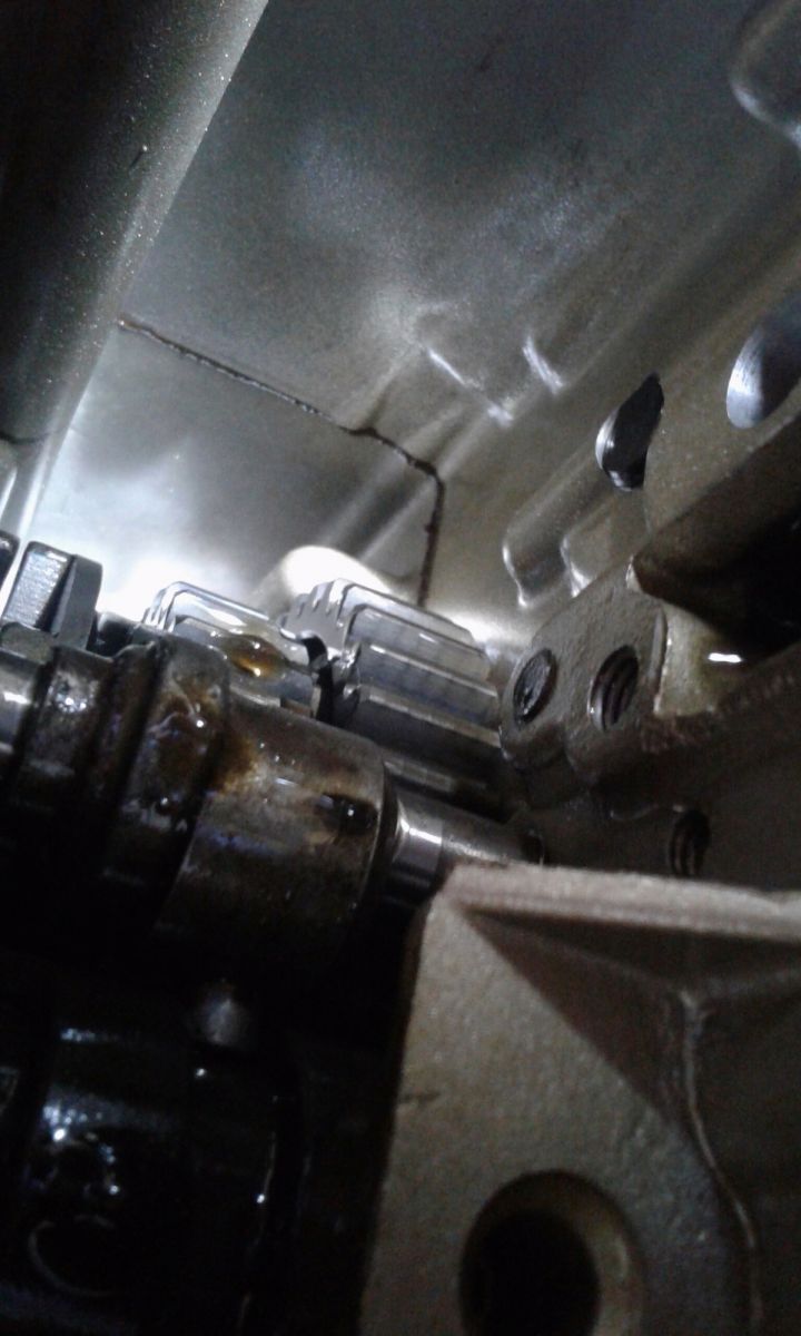

10 Oct 2017 16:00 #772671
by RLBuddi
Replied by RLBuddi on topic 82 1100 Spectre ..shifts from 5th to 4th by itself
Less

No. You need a manual. You should be able to split the cases without removing the head. Also you should be able to drop the pan to inspect the tranny and shift forks (3).

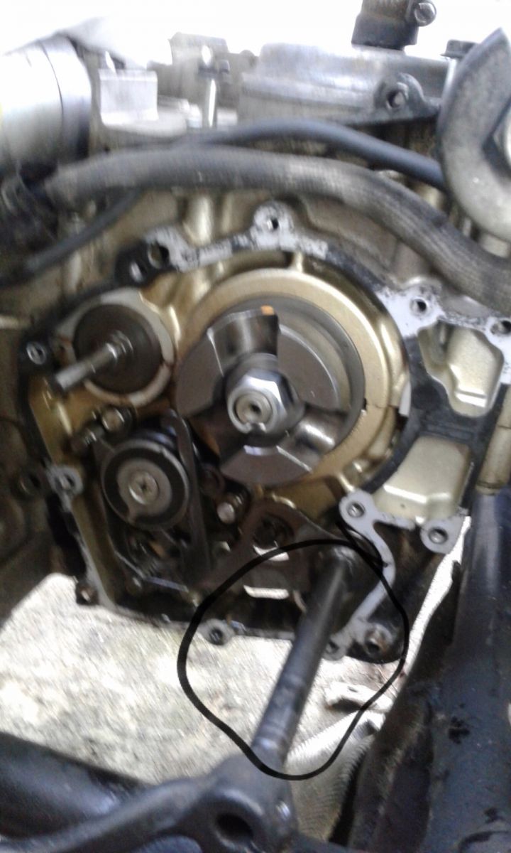

There is no doubt about me needing a manual, however, the snow will be flying soon here and I can't afford a manual right now. My buddy whom had raced for Kawasaki 20 yrs ago probably knows more than I ever will, ...it's just trying to get him over here again is another story, as he is a busy guy. Was only trying to get 'er done before snow flies here. He said something about being able to drop the shift forks out of the pan hole by pulling the shift rod out. If I seem impatient, I apologize. It's only because I still don't know what is wrong.

10 Oct 2017 17:11 #772681
by SWest
Replied by SWest on topic 82 1100 Spectre ..shifts from 5th to 4th by itself
They'll drop out alright, getting them back in place is another matter. I lay the bike over on the alternator cover to peer inside with the pan off. Wide open then.
