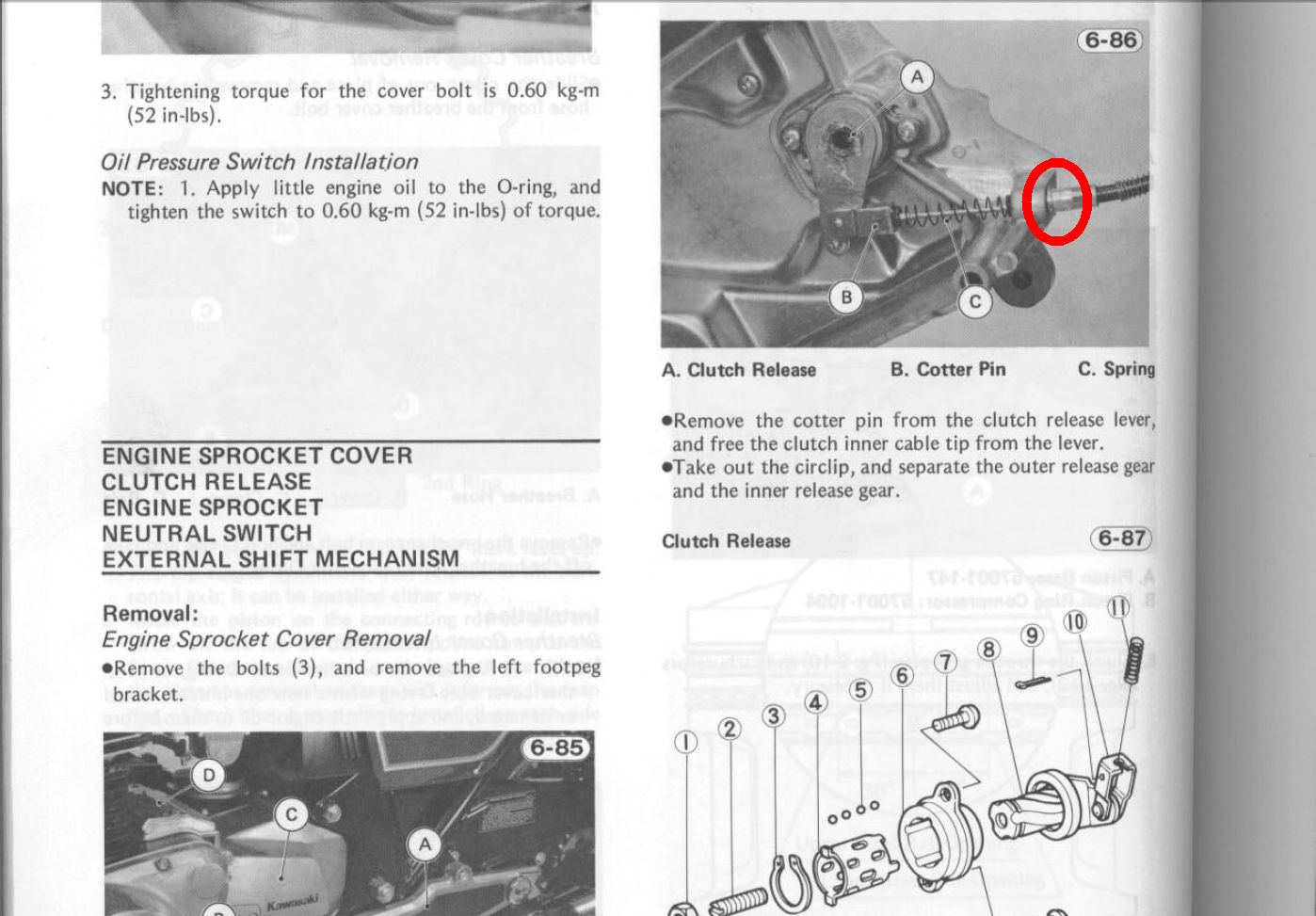

It could be you unhooked the clutch cable grommet from the clutch cover bore and shorten the inner clutch cable.

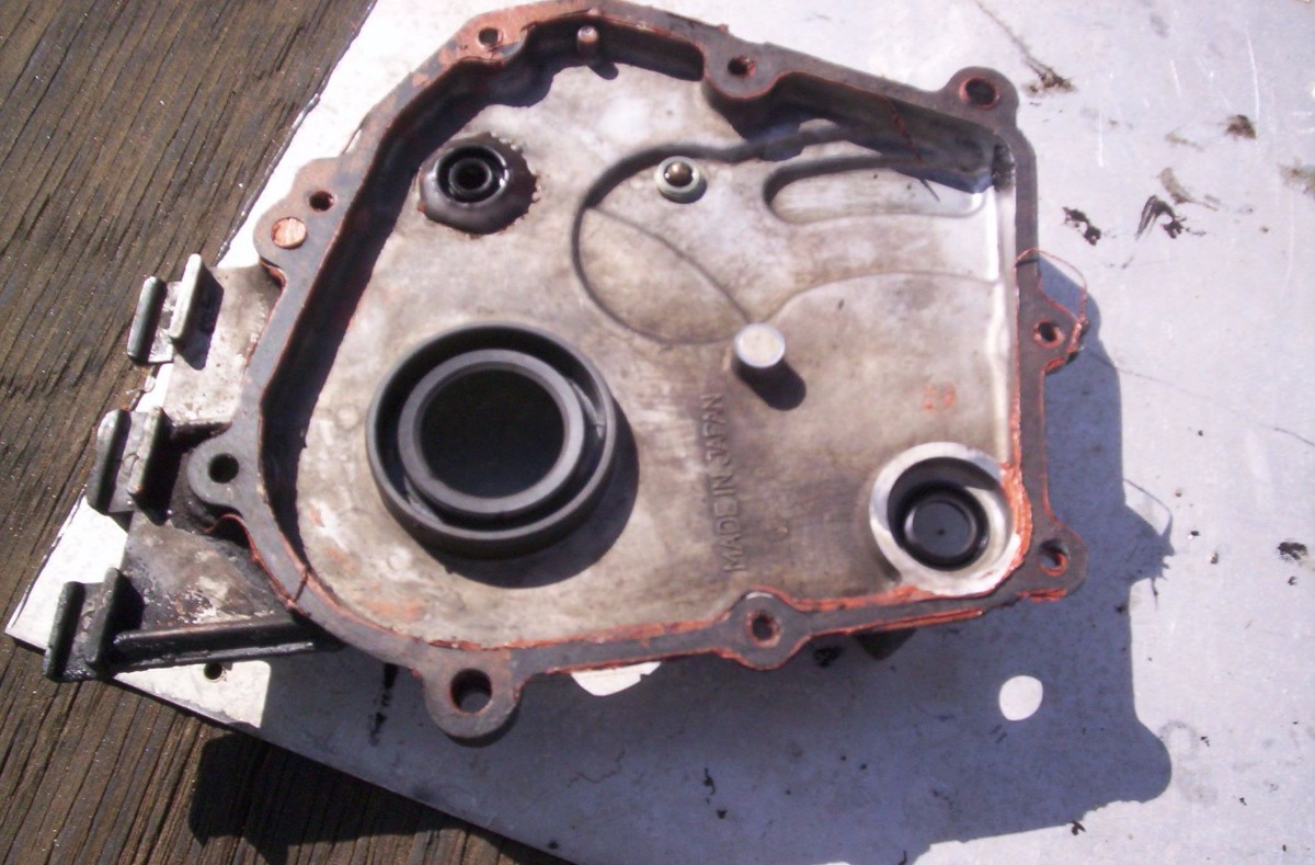

You can see the oil seals here. The "O ring" might be part of the seal that's why it's leaking.
kzrider.com/forum/2-engine/599524-counter-shaft-oil-seal
Had to use JB Weld to keep mine in until I could get a new set.

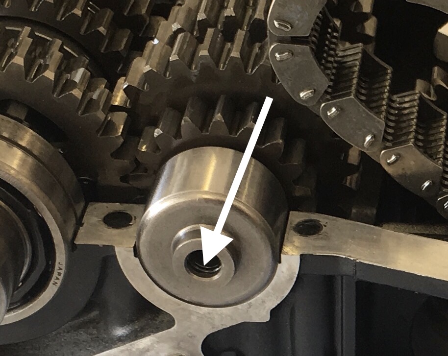

There is a tiny o-ring in the pushrod tube port. It seals against the pushrod to keep oil from pouring out. You "may" have accidentally partially pulled the o-ring out when originally removing the pushrod and upon installation it jammed the pushrod and clutch in the "open" position when you applied the clutch.
The o-ring does not show up in all the transmission diagrams I have seen, and was suprised to find it when I dissassembled mine. I found the replacement o-ring in an "entire engine seal kit" I bought.
O-ring shown on my kz750e
