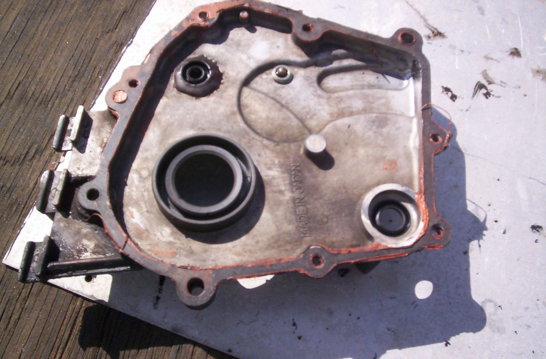

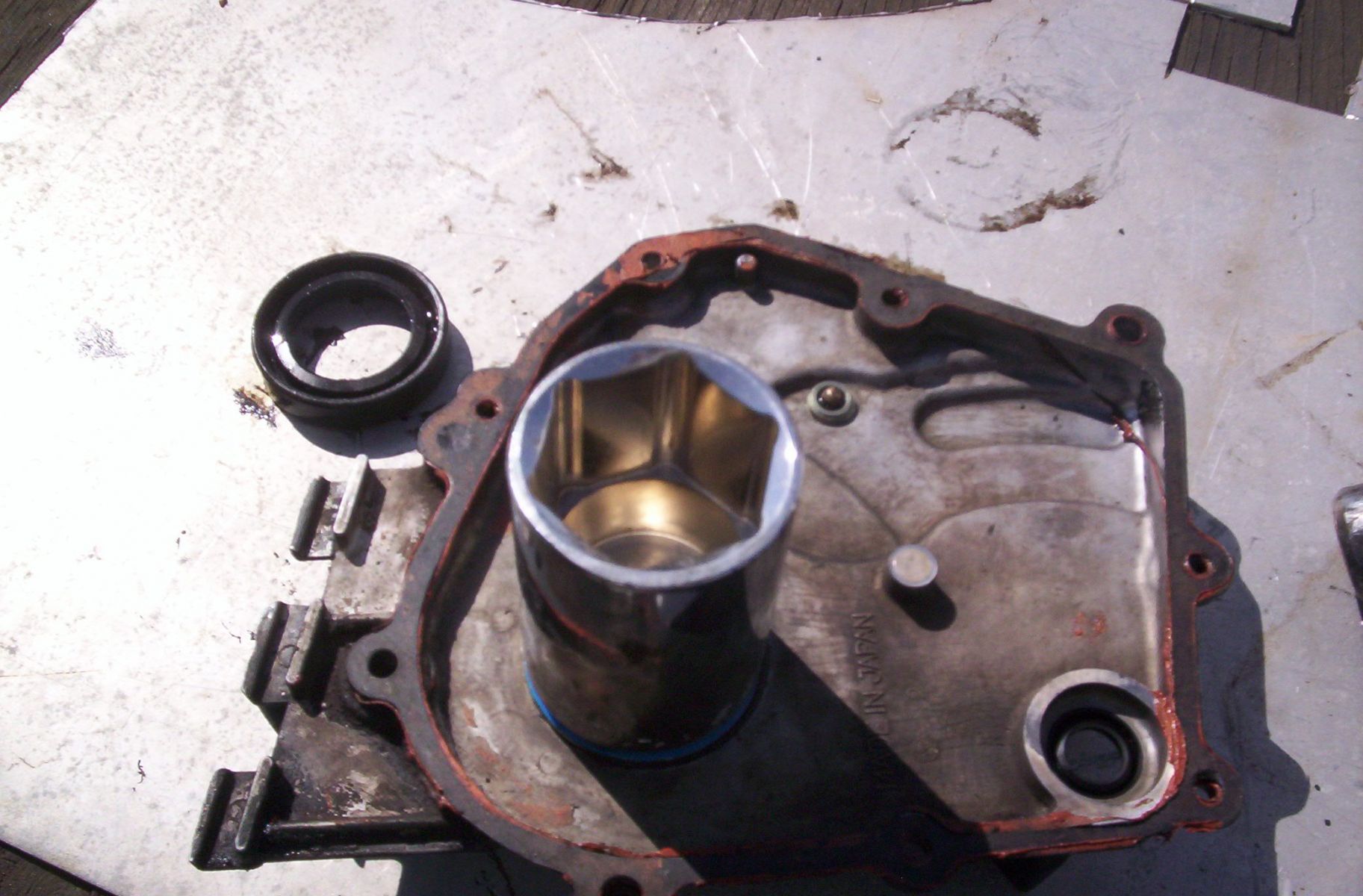

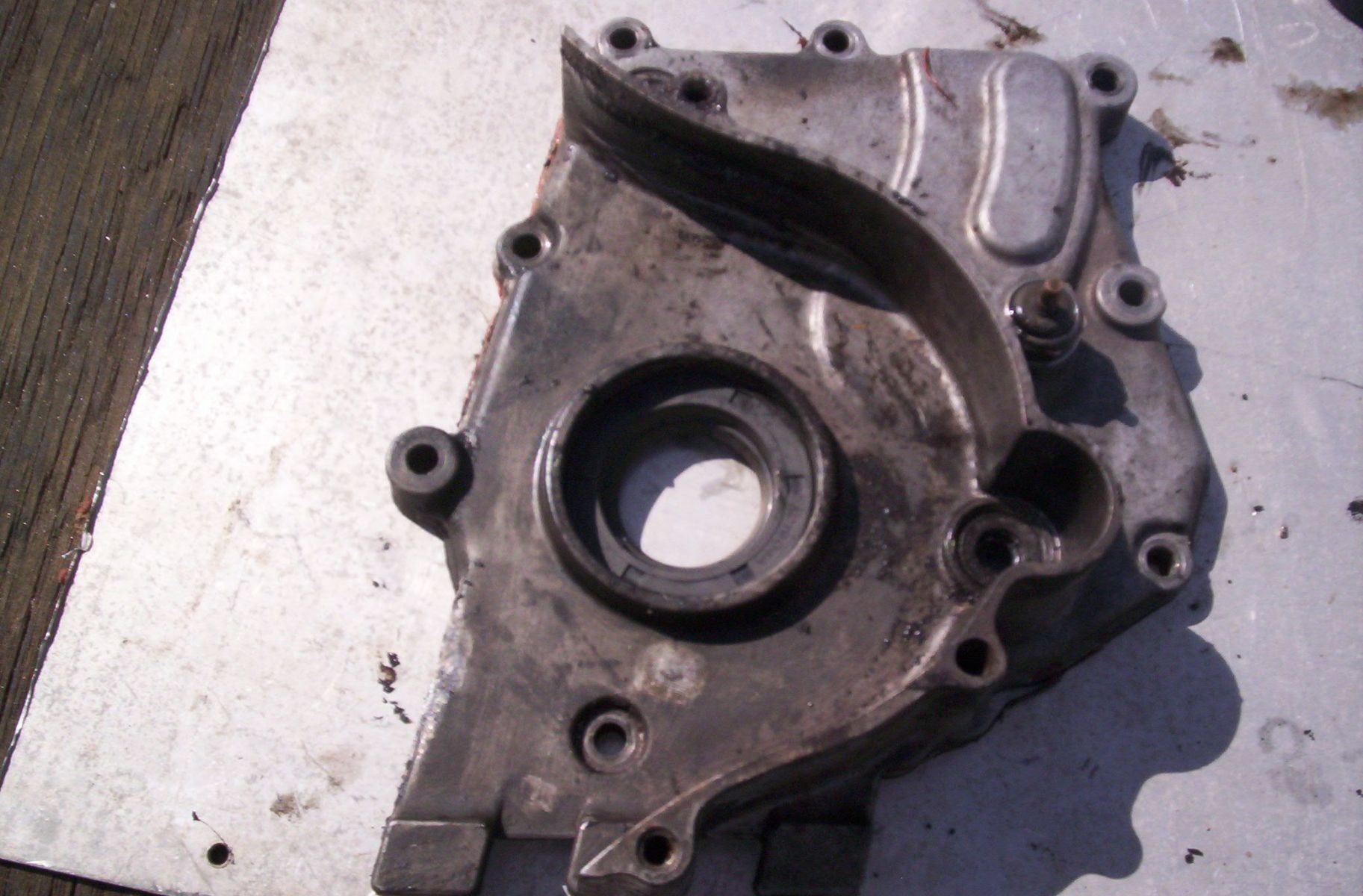

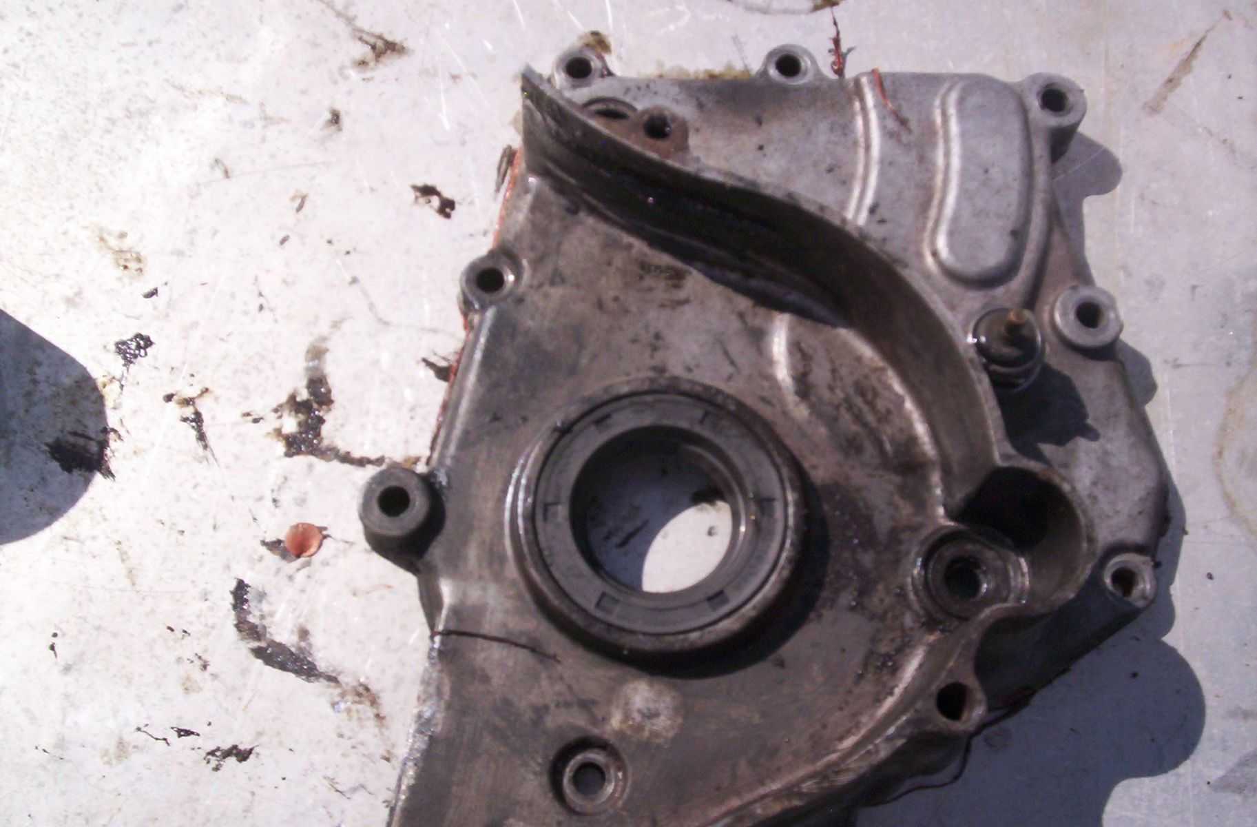

I bought this seal months ago. Got another DID standard chain and am using a old 15 tooth sprocket for the time being until I can collect the new parts to do the swap at one time. . Not the way I'd choose to do it but moneys tight right now. I thought I'd share the seal install. :dry:
The old seal pushed right out and had a crack. The bike started leaking oil like a Harley. :lol:

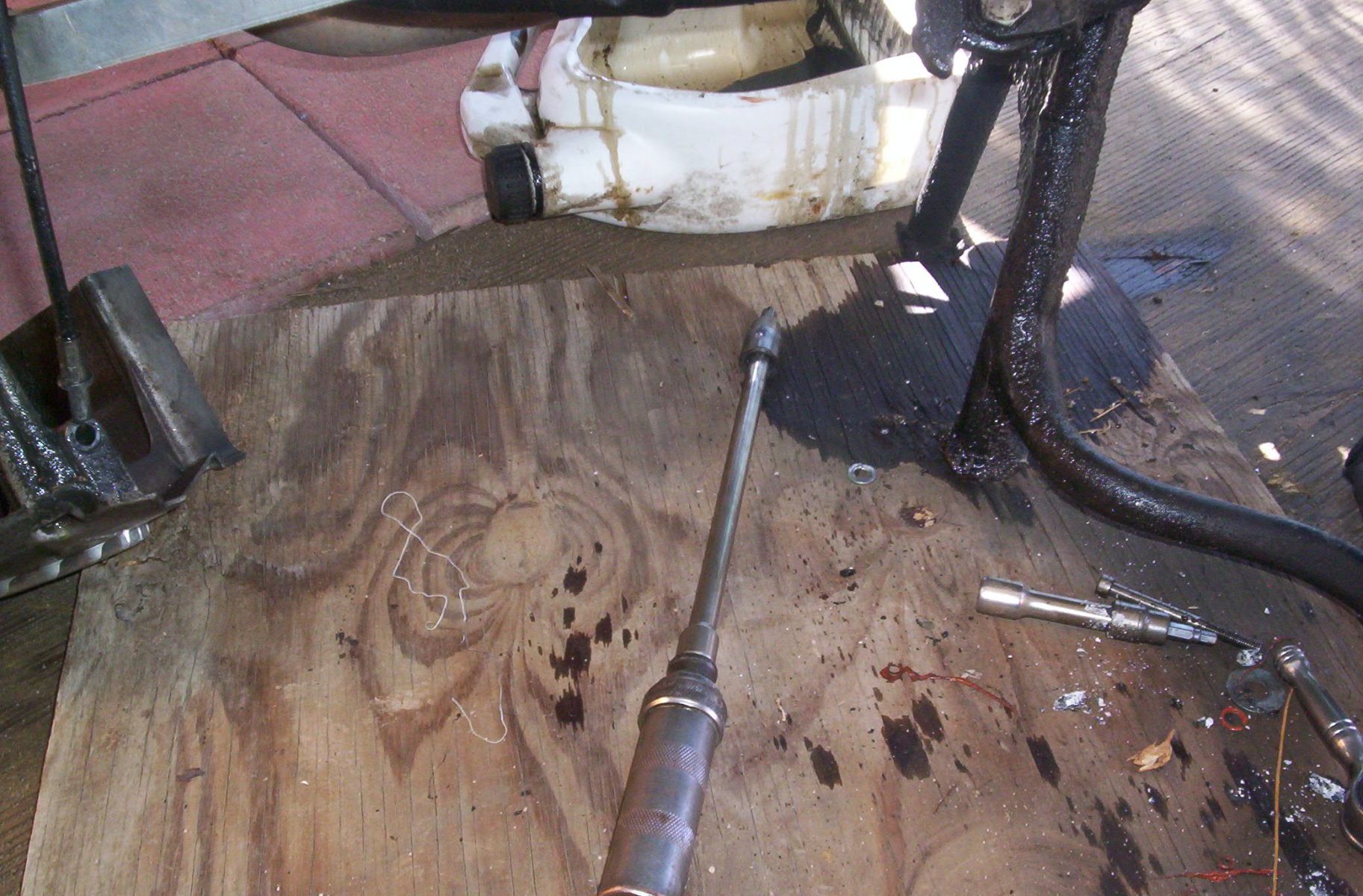

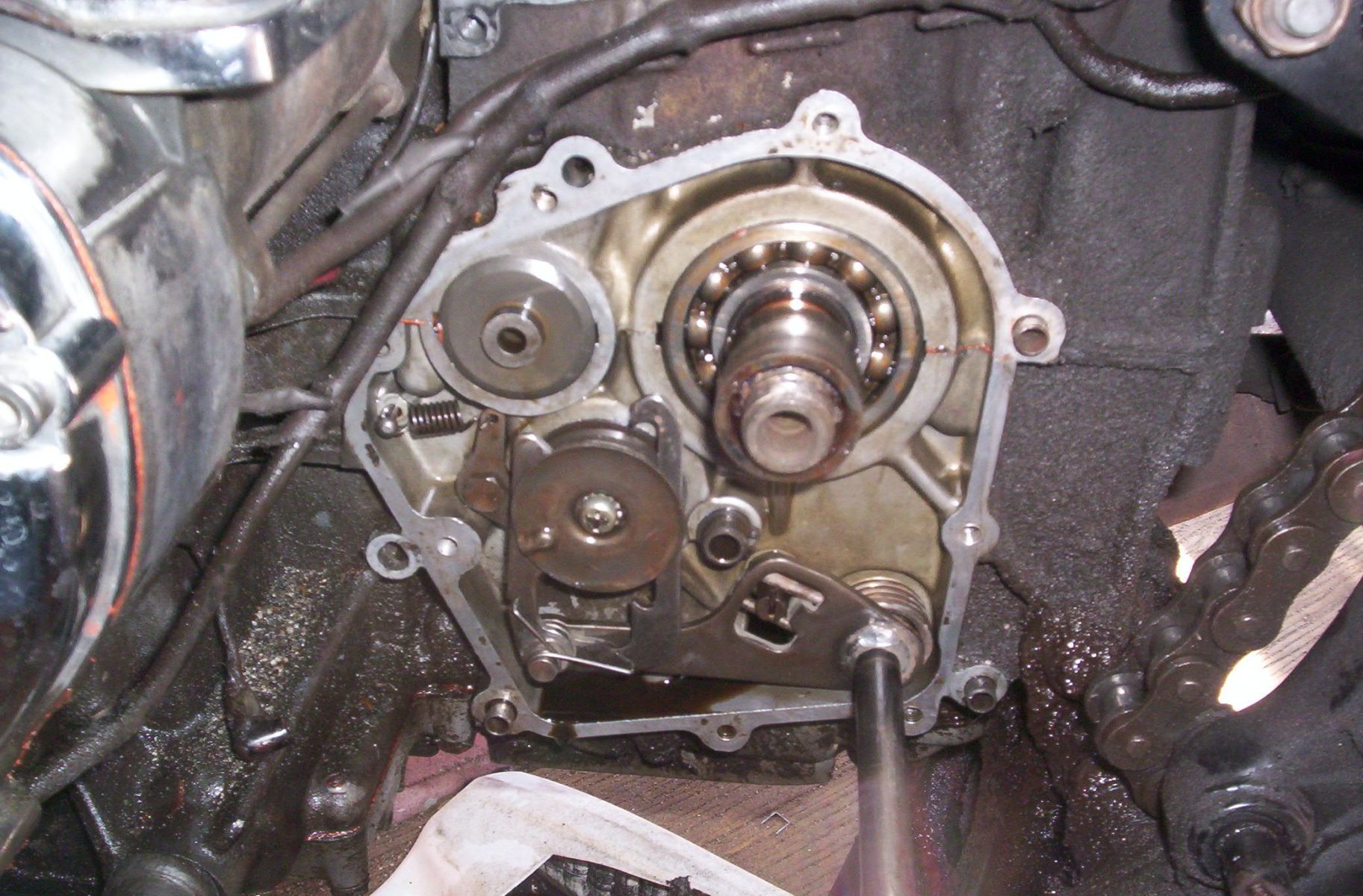

My shift lever was sloppy and would slip. I would make the space bigger so a hardened Allen could be used. It works but after a while, it becomes sloppy again so I bought a used on on eBay at the same time I bought the seal. Time to put it in. The return spring is four wound not two like the early Z1's had.
One of the only places I haven't gone to Allens so the hand impact is needed.
These JIS screws are as old as the bike. As I said, it is a must for any tool box.
