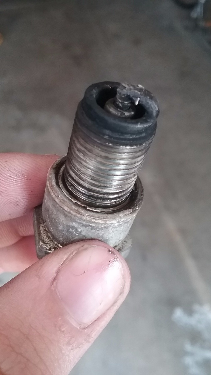

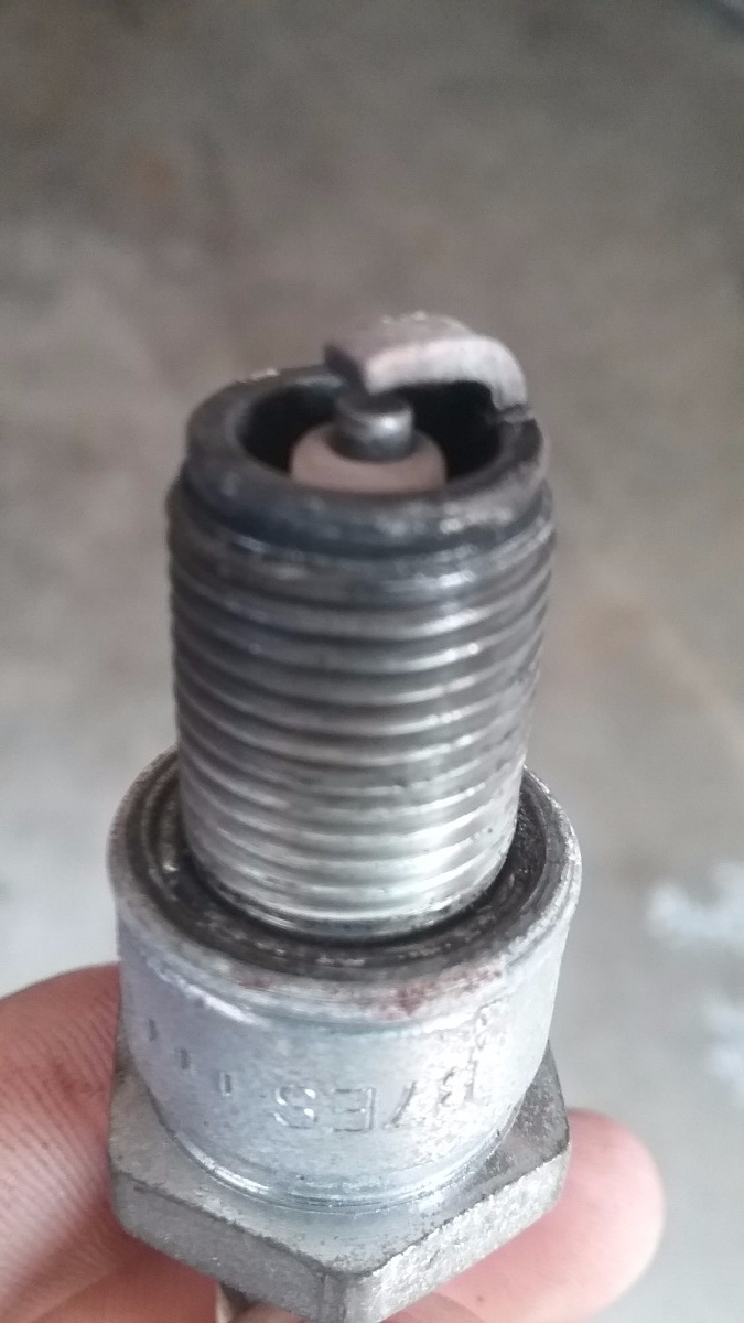

I was running to Lowe's and after pulling out of the parking lot and getting up to speed, I lost power. It would barely maintain speed. I got stopped at a red light and it died. It restarted once, but sounded terrible and didn't have any power still. I had it towed home, I pulled the spark plugs and cylinders 2, 3, and 4 looked fine (top picture). Number 1 is the bottom picture

Is there a piece of metal imbedded in the side electrode in the lower pic? Based on what I can see, I bet something really bad happened in that cylinder.

TexasKZ:
No its just part of the spark plug flaking off. Comparing it to a spark plug color chart, it looks like it overheated.
