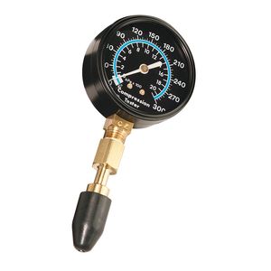

Most cars will require the type with a hose nowadays.
I only use this type with the Kz. You can just make out the valve stem in the very tip in this photo. These were called "hold in" compression testers. These are pretty inexpensive, which is nice, but some of them are leaky. Make sure the gauge holds pressure. If not you can sometimes you can re-seal the threads with thread tape etc. I had one that leaked due to a cracked fitting, but I was able to solder it. Tools don't seem to be made like they used to.
This is the same tester I've been using for a while and can be had for only 13 bucks at Farm and Fleet if you have one around. Could do a double check with it.

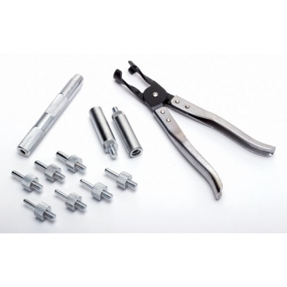

Is this the right tool to remove the valve guide seals?
www.eastwood.com/rockwood-valve-seal-rem...aktvKCRoCpCAQAvD_BwE
Thanks, Matt
Thanks, Matt

Yes, it is.
For removing and installing the new ones

I too have the Harbor Freight compression tester and I question it's accuracy too. Very similar #'s as with Matt ?
I like to purchase another tester and am looking for one like loudhvx. Does anyone have a source where one of these "hold in " testers ?

No eBay APP ID and/or Cert ID defined in Kunena configurationI just did a brief search and it's really getting hard to just buy a simple cheap compression tester. Everyone wants you to buy a whole kit and pay for a bunch of stuff you might never use.
These things were dirt cheap and littered every garage back in the day. As long as you can get good access to the plugs, like on a KZ, these testers are way faster to use so the engine temp is more consistent as you do 4 cylinders. Being smaller means it takes less crank revolutions to fill the test volume. If the tester volume is doubled, it will take twice as many revolutions to pressurize the tester. A smaller tester is easier on the battery and starter. The only real complaint is that it takes effort to hold the tester in place ... probably about 30 to 50 pounds, but with everyone getting heavier, it shouldn't be a problem nowadays
I searched Actron CP7821 and it seems mostly unavailable at reasonable prices.
I would avoid used ones since they can be leaky and the rubber tips do get worn out. Ebay does have the rubber tip replacements from china cheap. But even the fittings can crack or leak. Usually the gauge, which seems like it would be the most fragile part, is the most reliable part. It's the fittings and tip that leak. You can usually replace the valve with a standard schrader valve from any bicycle shop.
Here's one on ebay for $30, but it's about twice what you should pay.
At least Actron still has them available, but when you buy singles from a manufacturer, you pay a lot.
$49 is way too much.
actron.com/content/stem-compression-kit

Wow I see what you mean Loud...... picked mine up for 13 bucks at F and F but that was in 2013........... Farm and fleet don't list em on the site ..... will check in the store but not till mid next week ..... did find it at tool source .com for 15.95 but gotta add shipping and 22.95 at Jegs....... JB tool sales has a Performance tool stem tester for 12.80 but don't know the reputation of the store or tester.

22 Sep 2017 07:32Nice job finding those. Looks like about $25 shipped is about the best. That's not actually too bad.KZB2 650 wrote: Wow I see what you mean Loud...... picked mine up for 13 bucks at F and F but that was in 2013........... Farm and fleet don't list em on the site ..... will check in the store but not till mid next week ..... did find it at tool source .com for 15.95 but gotta add shipping and 22.95 at Jegs....... JB tool sales has a Performance tool stem tester for 12.80 but don't know the reputation of the store or tester.
I was assuming a cheap knockoff from China would be easily available, but haven't really found that.
