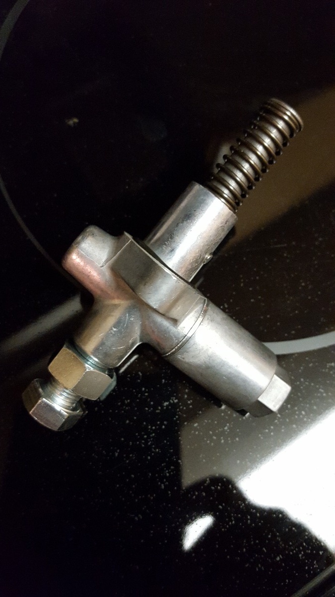

So here's where I'm going. New OEM auto-tensioner and springs. Drilled and tapped a lock bolt behind the pushrod. Once top-end assembled and horizontal wedge and spring installed. Rotate the engine a few times to position the pushrod. Then turn in the lock bolt until it touches the pushrod, back it out a 1/4 turn, and secure the locknut.
Now I have an OEM auto-tensioner working as designed, and a failsafe lock-bolt to eliminate any chance of a backup enough to jump time.
